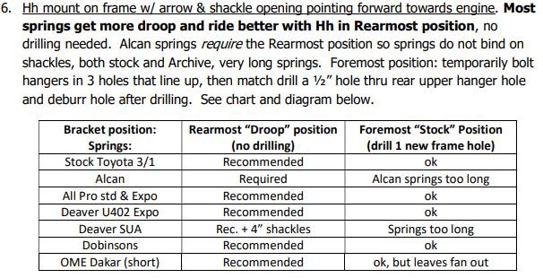

    You might wanna list out which positions work best with different leaf packs. I think I remember we talked about using the stock position for my deavers. I’ll have to go dig up the email again.

    Here's a snip from the V3 instructions. You'll notice I recommend the Rearmost position for all springs, same as where Hh have always been from the beginning. But now buyers have a choice and can adjust if they prefer

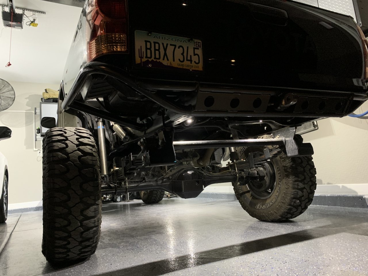

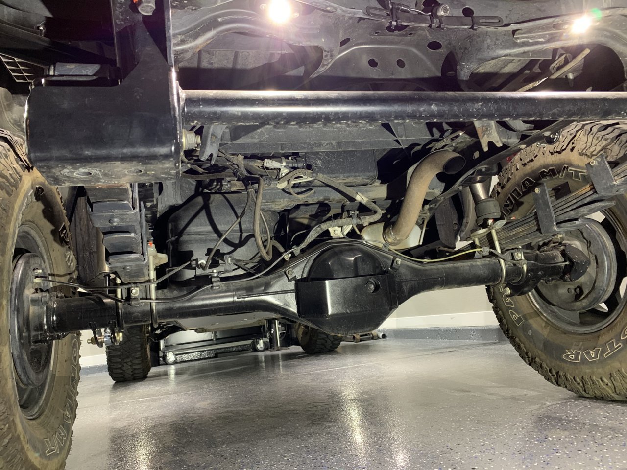

    https://www.tacomaworld.com/threads/singletrack’s-‘dad-shred-build-thread’-i’m-just-doing-it-for-the-kids.619250/ Sos offroad sliders (kickout + filler) Sos offroad full belly skids (steel) Sos offroad front recovery point Sos offroad concepts HC rear bumper with bedside kickout tubes Marlin Crawler LCA frame brace kit Trail Gear rear diff cover Bilstein 5100 + OME 885 Total Chaos UCA BILSTEIN b110 OME Dakar standard pack Wheelers Ubolt flip kit Wheelers Superbump f/r Wheelers SS extended brake lines FN five star 16x8 -25 Milestar Patagonia MT 315/75r16 Custom projector retrofit (acme super h1 + morimoto 4300k) Baja Designs S2 sport ditch pods on CBI ditch pod mounts Amazon AMAK rock lights CMC CB radio hardmount
    Nice little driveway shot of some hammer hangers, cross bar & wheel sensor skids. Truck will see dirt soon. I’ll have much better pics of the HH doin work, then.

    Man, she's ready for crawlin'. Nice move on the bumper, the build's really taking focus with all that clearance you have. Can't wait to see the new trails you'll be able to conquer. :thumbsup:
