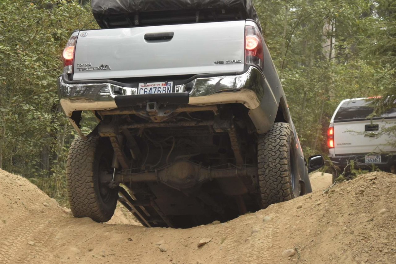

    How does moving the shackle mount backward help droop? I believe the photos people are posting of supreme flex, but it also seems counter-intuitive in that as the leaves arch downward they also shorten.
    Is it by virtue of letting the suspension fall farther downward freely without binding? I.e. is the stock mount location so far forward that as the shackle rotates toward the axle it cramps the movement of the leaves?
  4. Sep 30, 2020 at 7:29 PM
    #2284
    ARCHIVE
    ARCHIVE [OP] Well-Known Member Vendor
    Oct 29, 2015
    #168099
    2,261
    Eric
    Orchard Park, NY (Buffalo)
    '05 Taco, '22 Tundra, '91 Cummins
    2.5" Fox relocation * Hammer hanger * Archive MD springs
    Longer leaf springs on the market can't fit in between the stock locations or at least not without really bending the main leaf. Moving the shackle pivot rearward helps the shackle rotate further near horizontal
