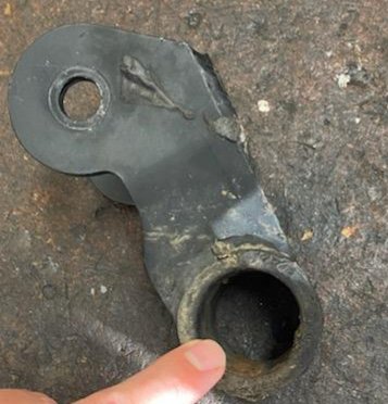

    You shouldn't have to, especially with current Version 3, Hh have more clearance to the tailpipe. It won't hurt for the spring to temporarily touch the tailpipe during droop
    For those who do cut the tailpipe
    THE OUTLET SHOULD BE BELOW THE BUMPER, AND NOT POINTING AT OR IN FRONT OF HANGERS OR CROSS TUBE.
    HOT EXHAUST GASES FLOW STRAIGHT HORIZONTAL FROM THE OUTLET AT SPEED
    Several people have melted poly bushings because exhaust was aimed at hangers.
    Here's a pic from a shop that replaced melted bushings and fixed an exhaust last week
