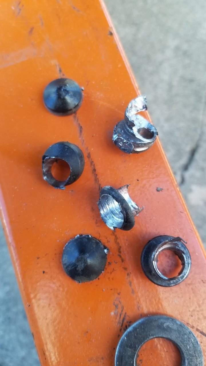

    hammer the bolt out right into my composite bed's rib. hmmm...

    Amazon one-day one. Found one for $14 dollarydos. Another possibility is to thread the bolts back in cut the access then thread them back out.

    I've already zip tied it in place so it doesn't rattle. I'll have it handled at Tandem soon, they are gonna rebuild my cv's in about a week. fun day learning about a new tool. :cool:. thanks for the help again.

    I'll try it tomorrow. iirc the 2nd or 3rd hardware store today had a reversible 13mm flex head, either way at least i won't be making this mistake again.

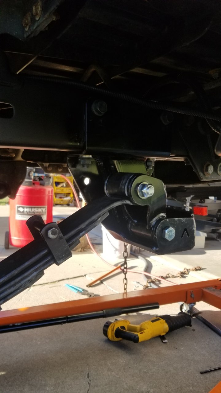

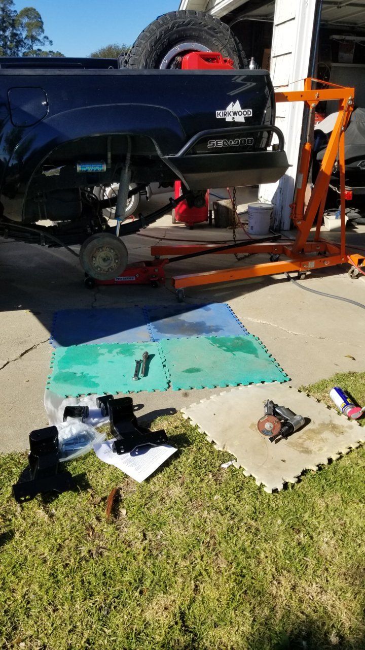

    Did stuff today

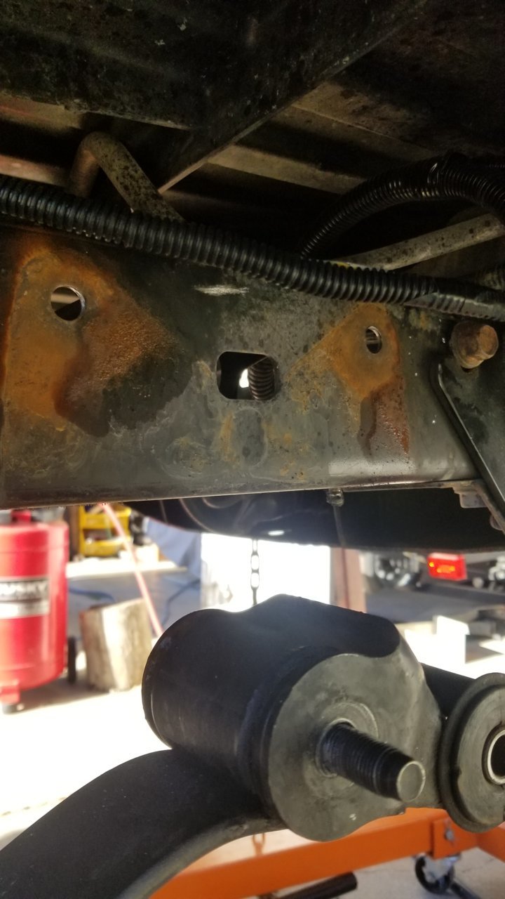

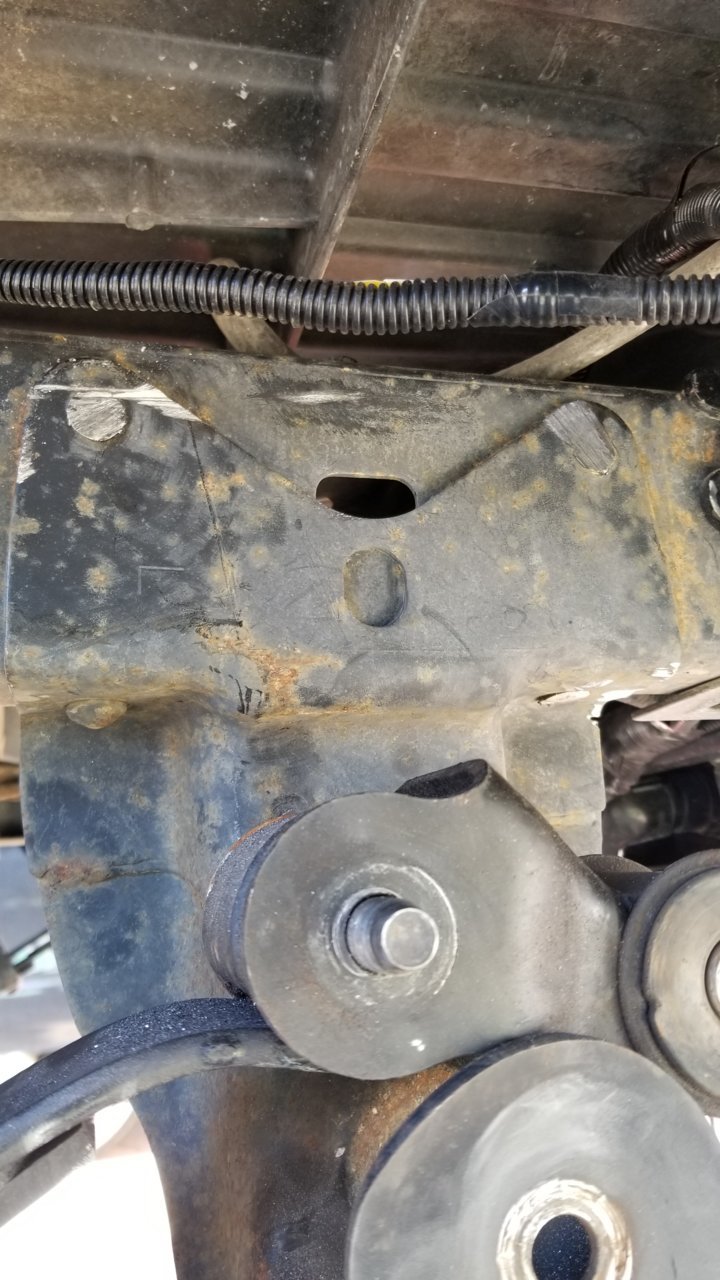

    Cleaned that then painted

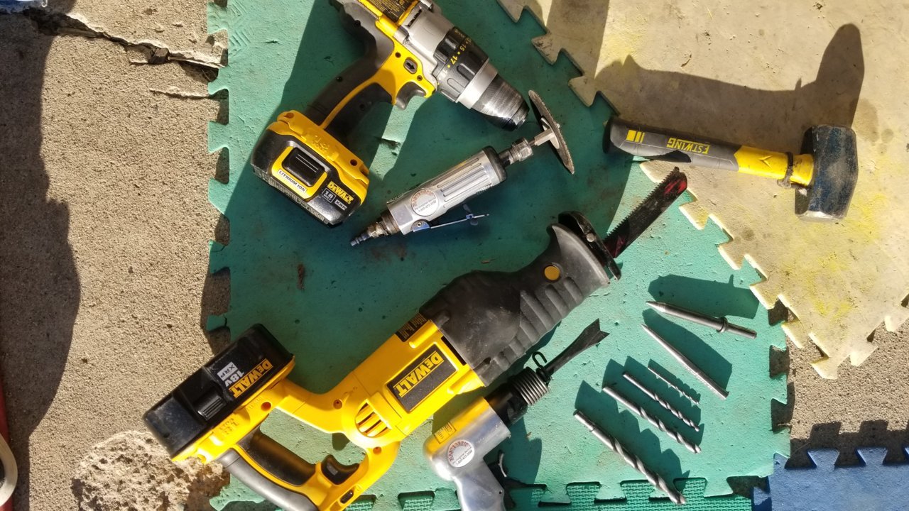

    How long did it take you? Any tips you can give me? I’m installing mine next weekend and I want to be prepared

    You can see the tools I used. One thing that helped (not pictured) was a longer metal Sawzall blade- the blade you see was my back up. . Using fresh drill bits goes a long way and keep them lubricated while drilling. Make use of that center punch and be patient. Hope this helps.
    Oh yeah used a grinder here and there
