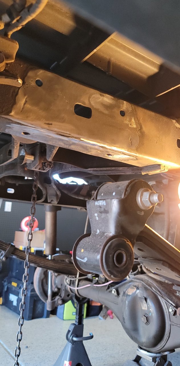

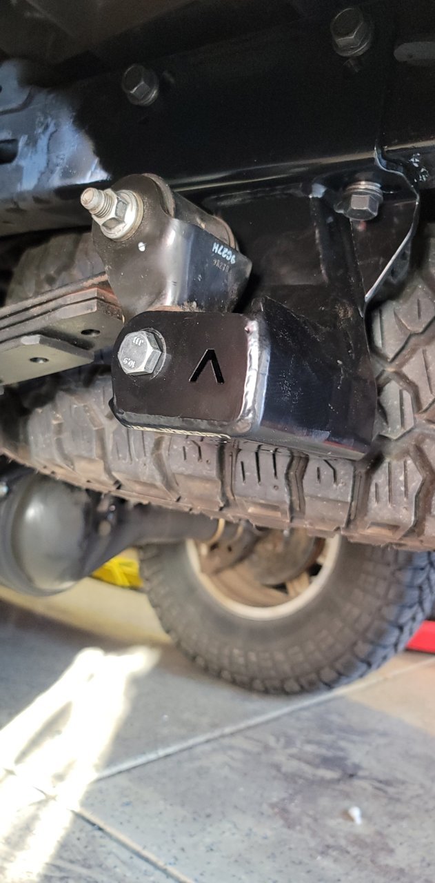

    I got mine installed today. Way easier than I thought it was going to be. The YouTube videos seem to way over hype the difficulties. No drilling the rivets out bottom came out with a ball joint press and impact the top came out with a quick smack of the air hammer.

    Shhh I musta did it the hard way lol. Glad you had a good time of it. Looks clean

    The right tools really do make all the difference in how much ass pain this job is.

    I like to try to find the easiest way possible even if it ends up taking longer than doing it the hard way lol. Luckily thus was faster than drilling as I did drill one out just to see.

    Started this last night. Any tips or tricks to make the process go smoother or faster? [​IMG]

    hmm, just moved and dont have a air compressor setup yet. I dont think my ARB compressor will run an air hammer. Might just be drilling all of them.

    Air hammer definitely makes it a breeze. Worth finding a way to run it
