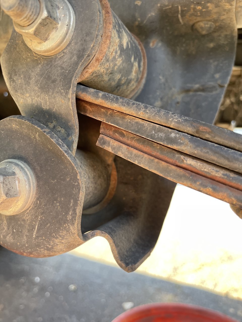

    I haven’t had any rubbing on these Dakar’s. At this point they are a holdover for New Deavers but waiting until the new camper is ready
    is it 100% they need to be trimmed? On this I would need to cut both of these if so? I’ve seen what needs to be trimmed but curious if it’s 100% needed. These are the older versions.

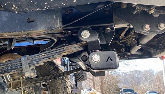

    Finally getting around to post a pic. Looking forward to seeing the difference off road.

    Kinda hard to tell but that top shackle bolt looks backwards. The head of the bolt should be facing the inside otherwise it’ll rub on the hanger.

    If it’s not rubbing and it hasn’t been, it’s probably fine. Maybe it’s because of the longer shackle?

    I just got them done, I haven’t really done much, it looks tight.
    Anyone know how much left and right movement there is?

    It's probably OK, just not best practice as the instructions direct.
    Shackles (Archive and stock) rock side to side offroad or throwing truck into a corner

    Thank you for the reply, I will probably just swap it.
