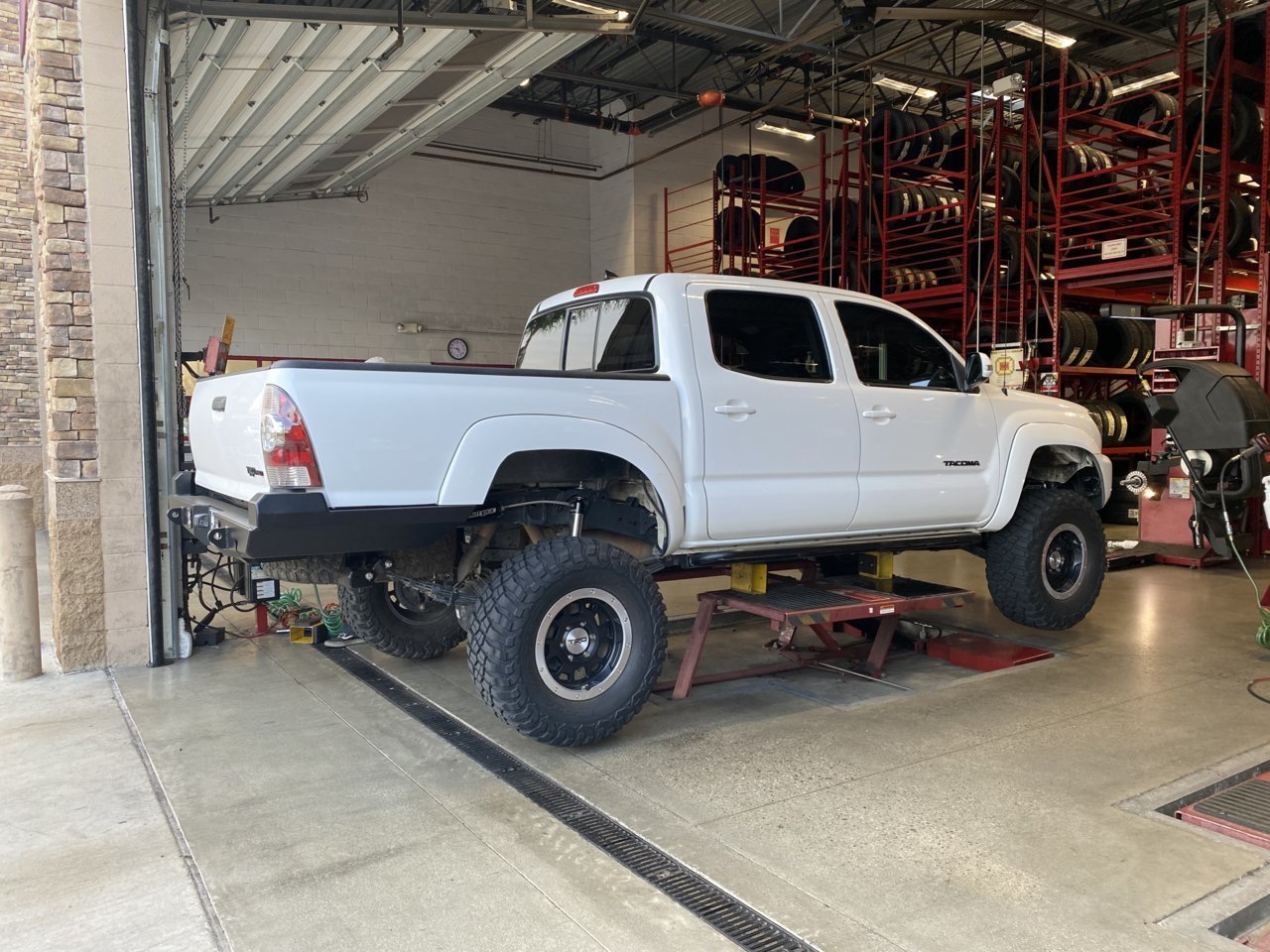

  9. Feb 11, 2021 at 7:24 AM
    #2569
    greenEFSI
    greenEFSI TacoSupreme____
    Jun 29, 2016
    #190830
    1,573
    Gio
    West Covina, SoCal
    '15 TRD Pro Super White
    Getting the tires balanced and rotated for a moab trip. First time seeing all 4 off the ground at the same time!
  10. Feb 11, 2021 at 7:25 AM
    #2570
    EatSleepTacos
    Mar 24, 2015
    #151688
    59,846
    Randy
    West Valley, AZ
    2017 4Runner
    I'm heading to discount tire next week and I can't wait to see them try and lift my truck up like that, and their confused faces when the back tires (proabably) stay on the ground.
    H3llRid3r, freddy2923, hirod and 5 others like this.
  11. Feb 11, 2021 at 7:27 AM
    #2571
    greenEFSI
    Jun 29, 2016
    #190830
    1,573
    Gio
    West Covina, SoCal
    Haha try and snap a pic so we can see! They were barely able to get the rears a 1/2" off the ground with my setup.

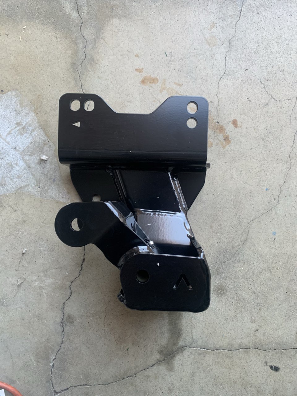

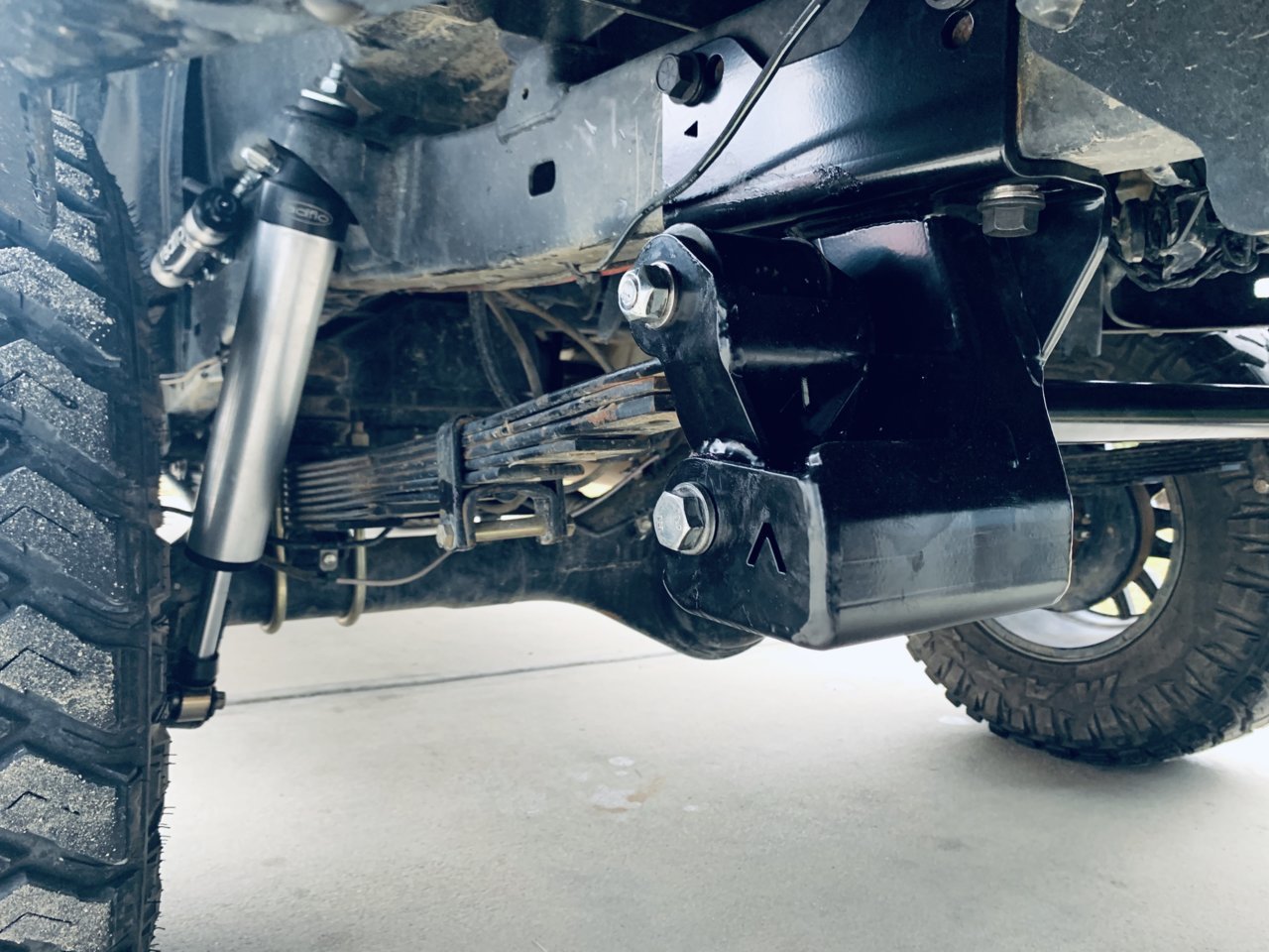

  13. Feb 11, 2021 at 7:34 AM

    EatSleepTacos
    Mar 24, 2015
    #151688
    59,846
    Randy
    West Valley, AZ
    2017 4Runner
    That didn't take long! Nice.
    H3llRid3r and Ncpi007[QUOTED] like this.
  14. Feb 11, 2021 at 8:03 AM
    #2574
    Chadr7858
    Chadr7858 Well-Known Member
    Jun 13, 2014
    #131908
    1,924
    Chad
    Colorado
    19 TRD SHIT BOX, 02 BEST GEN
    All the mods; all the problems
    So much work to just turn around a bolt... I need to do it to mine... it's what I deserve for not reading instructions
