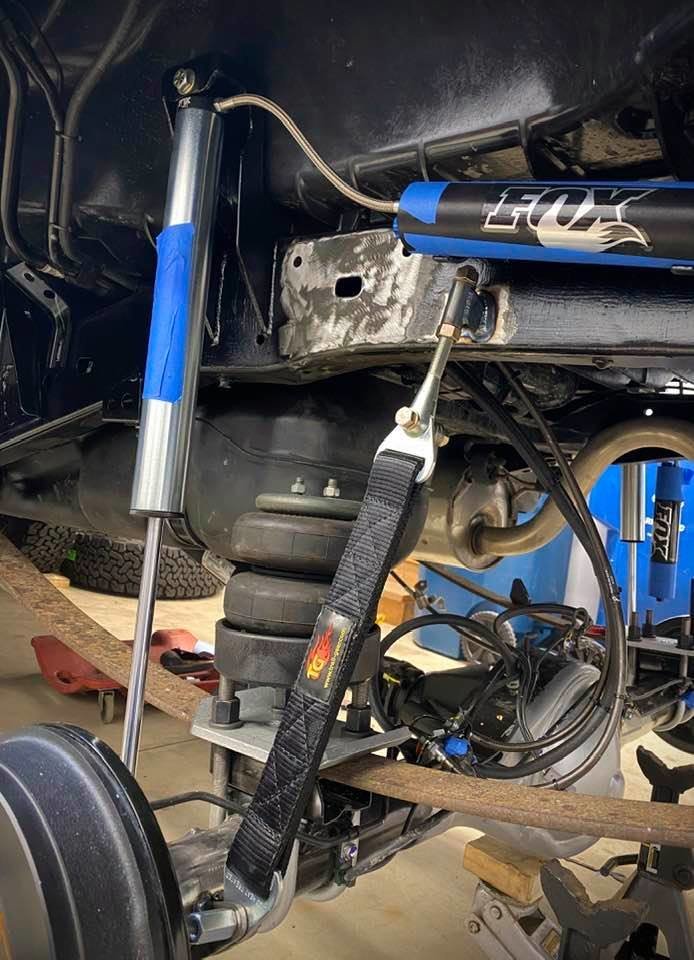

    I recently came across this positioning and I’m a fan

    I gotta put limit straps on mine. Waiting on new rear smoothies to show up though.

    Similar to mine

    I have a square tube crossbar right above the axle that I have my straps on. Was kind of a pita and had to have my exhaust dump in front of the axle because of strap interference. If I were to do it over again, I would do it like I shared above. Much simpler.
    since this post, I cut off the top mounts and repositioned them directly over the lower mounts.

    Here's a shot of how I went. Simple easy and effective. It might be the first 2019 that's strapped!
