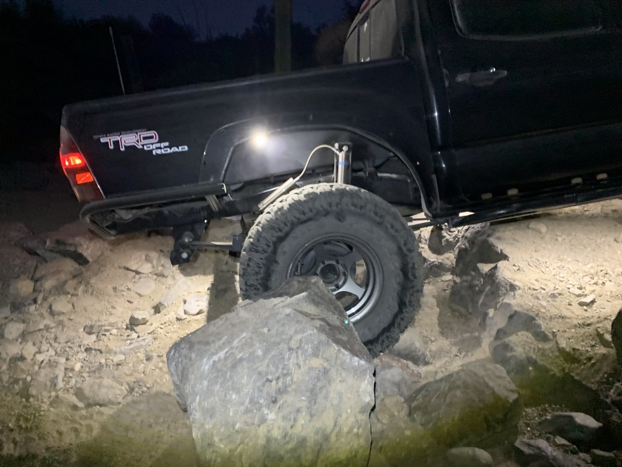

    But it is!! That’s why I liked that design better than the one Archive offers. It also has more ground clearance.
    that guy in the pics must have really gone for it! Guys, I’m not saying that these Hammer Hangers aren’t worth it. To the contrary, I want some, especially the v3 that doesn’t make more of an anchor out of the hangers! I just don’t have time to install currently and it’s such a bitch without a plasma cutter. Best setup is clearly beefier hangers AND cross brace. And plating the weak c channel frame... I was just suggesting that for some applications the brace will provide enough reinforcement all while being cheaper and easier to install
