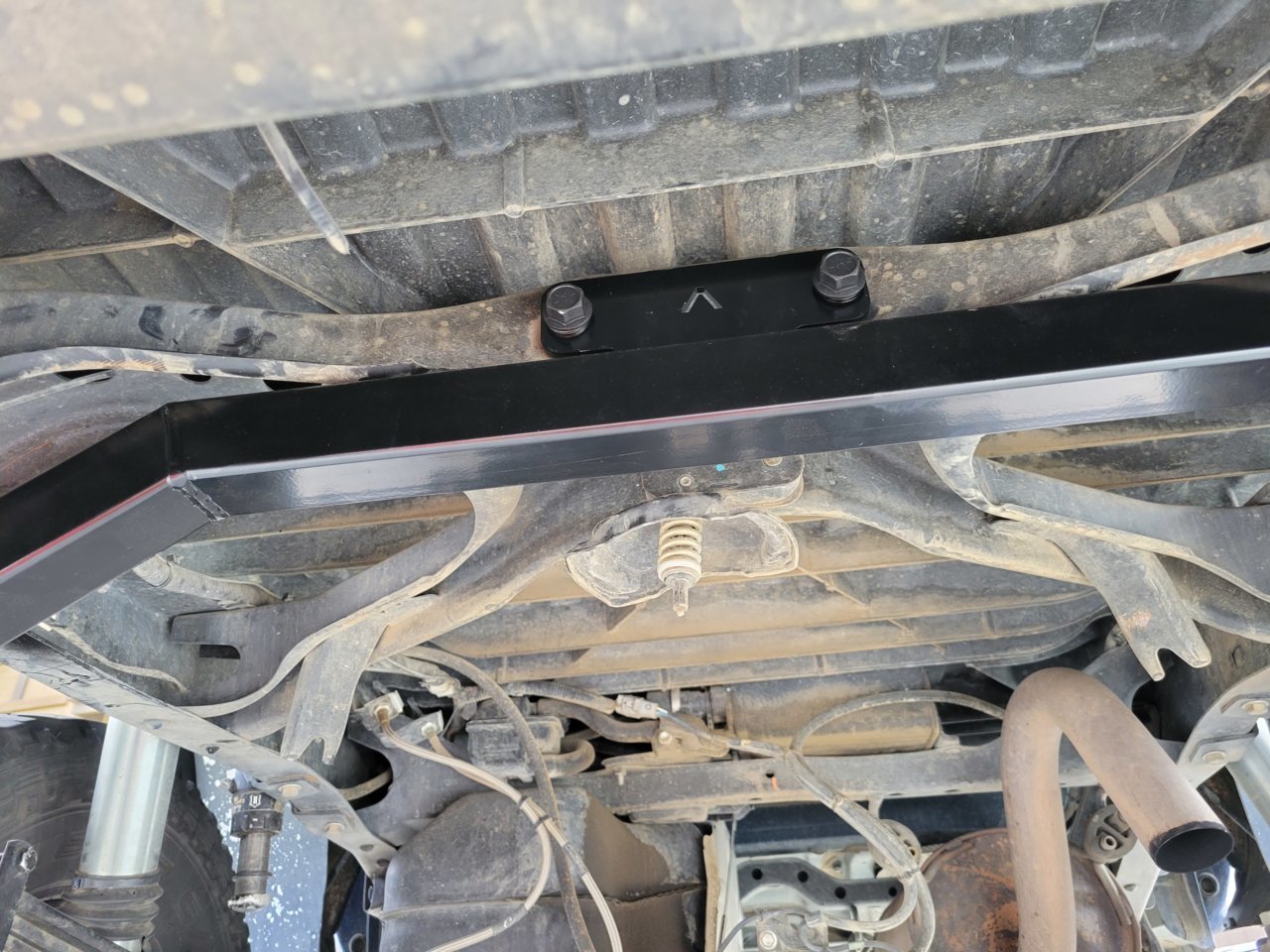

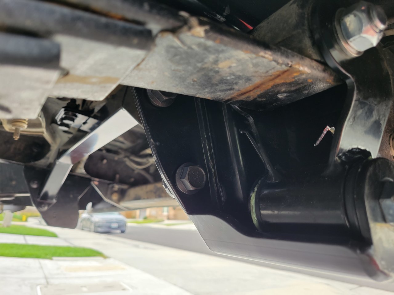

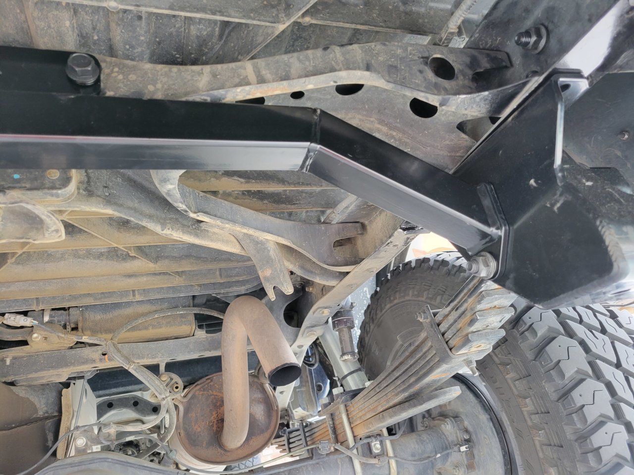

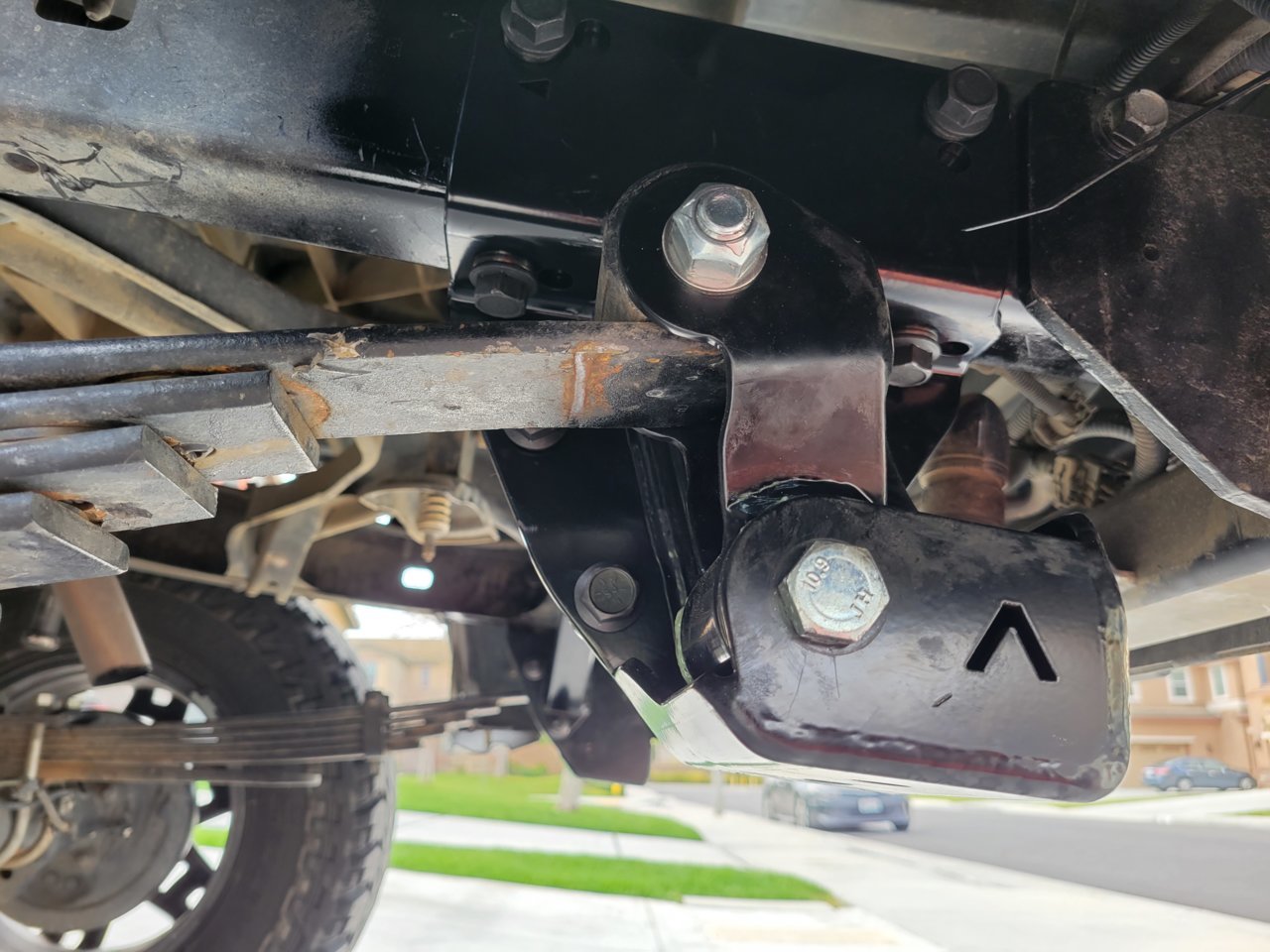

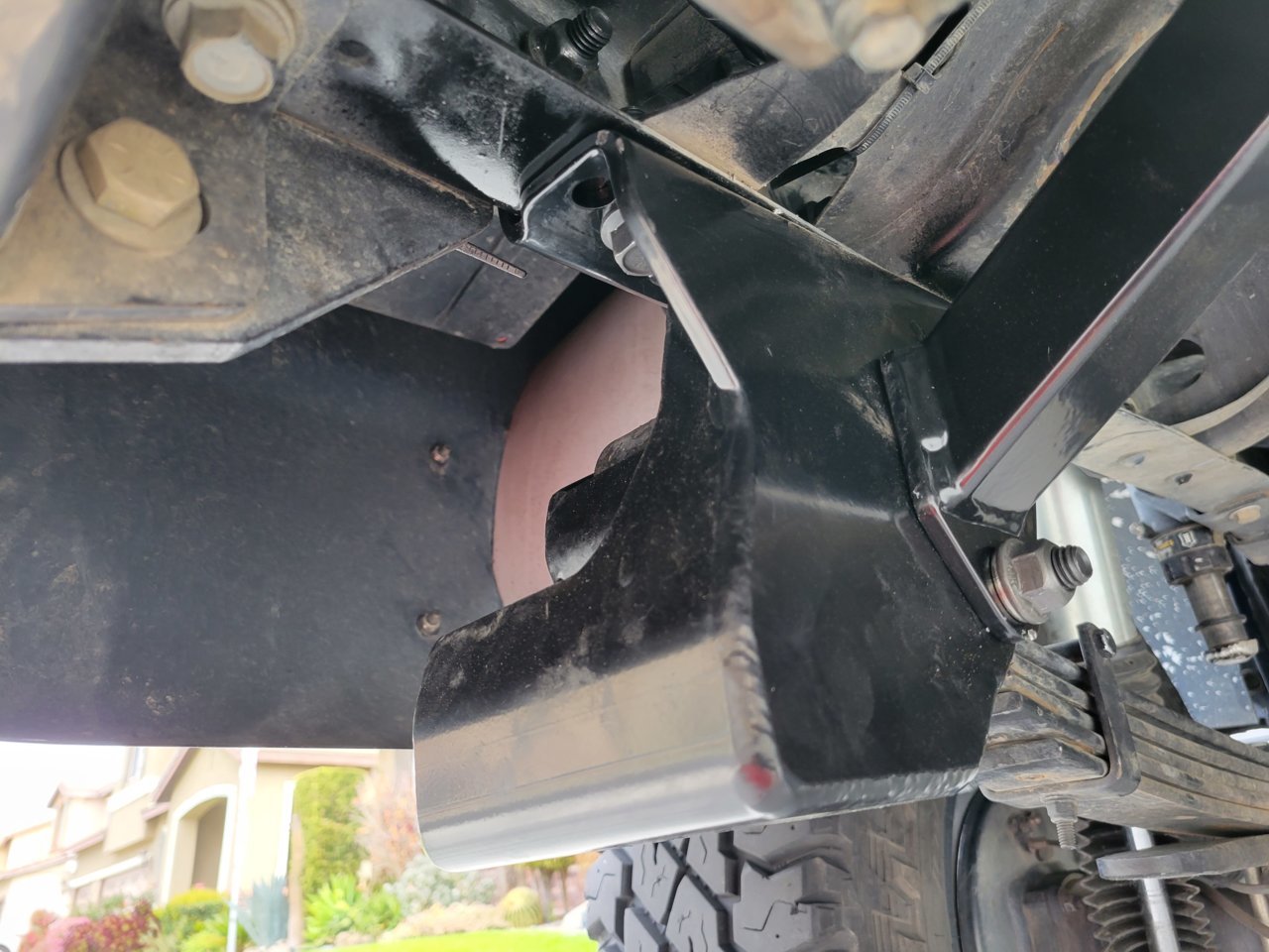

    Just install the V3 hangers along with the 3.6 shackles and high clearance crossbar. I ordered the following drill bits from McMaster Carr. These made quick work of drilling the rivets. Part numbers 2908A44 and 2908A62

    Thank you. Looks good, except the cross tube angle is on the wrong side of the stock cross member, should be on the engine side of the stock cross member
    Cross tube install here:
    https://www.tacomaworld.com/threads...-option-hammer-hangers-archive-garage.709534/
    https://archivegarage.com/explore-archive/ols/products/tacoma-hi-clearance-cross-tube
