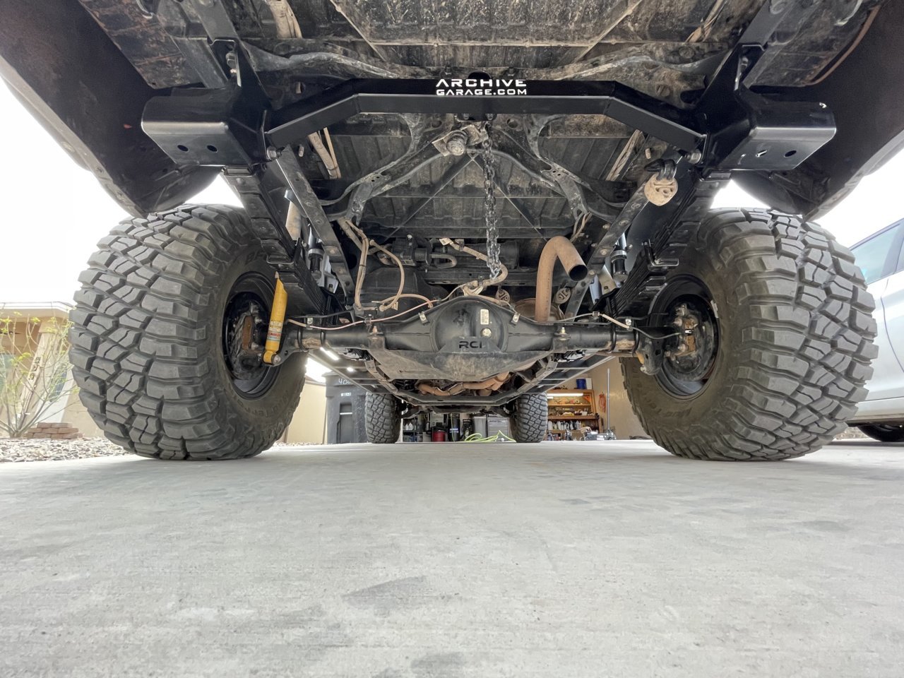

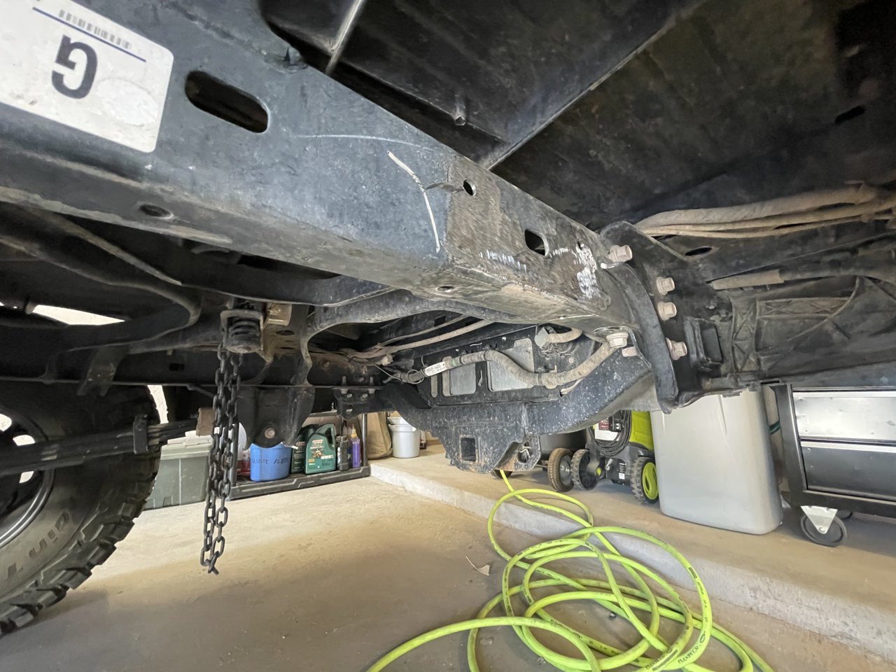

    limit straps?

    Yeah. I have them under the bed mounted vertically if you look closely enough in the video.

    indeed. I do see them. It’s a sweet setup.

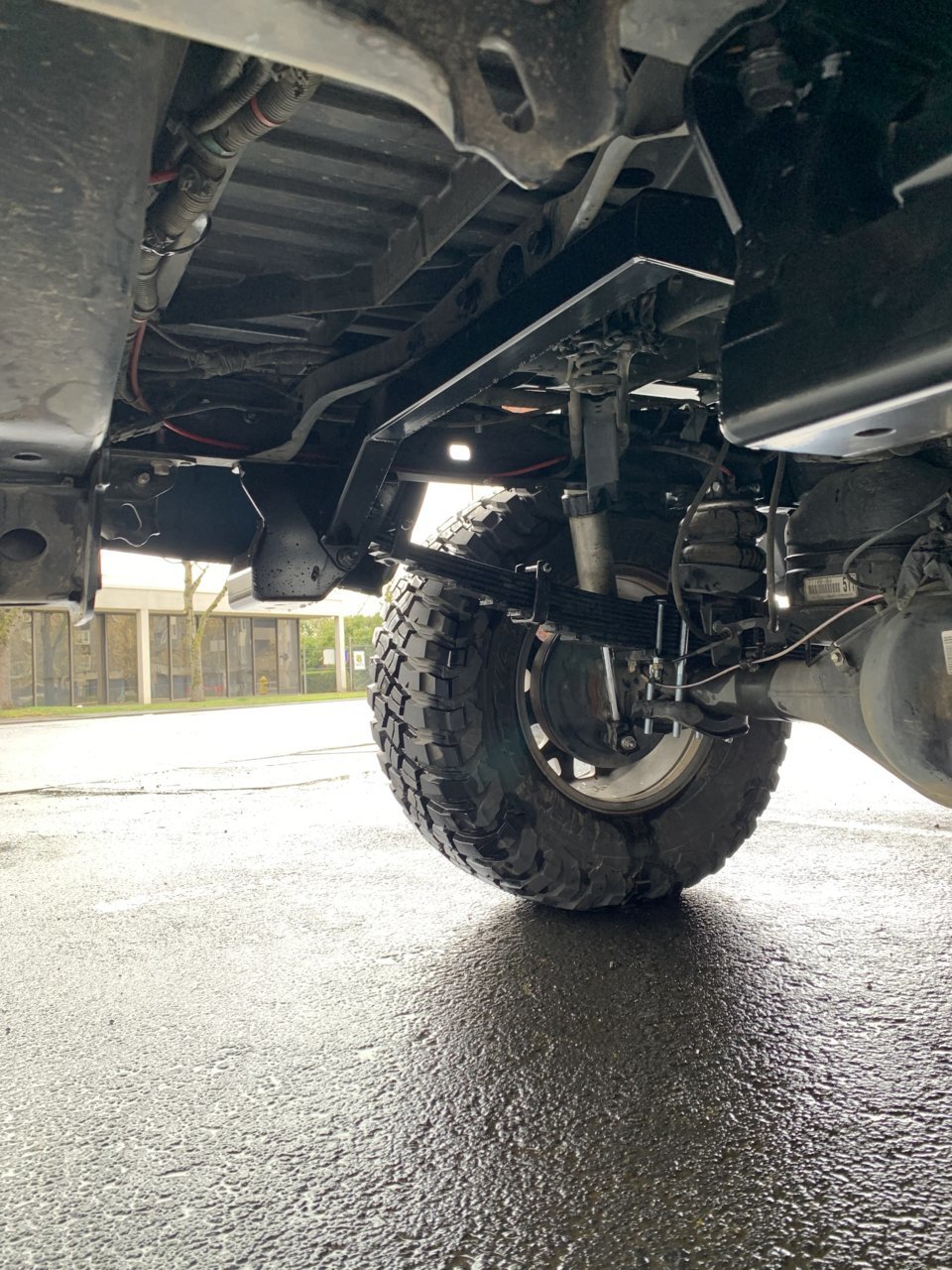

    Done! Deavers pluse this full system rides much better than before!

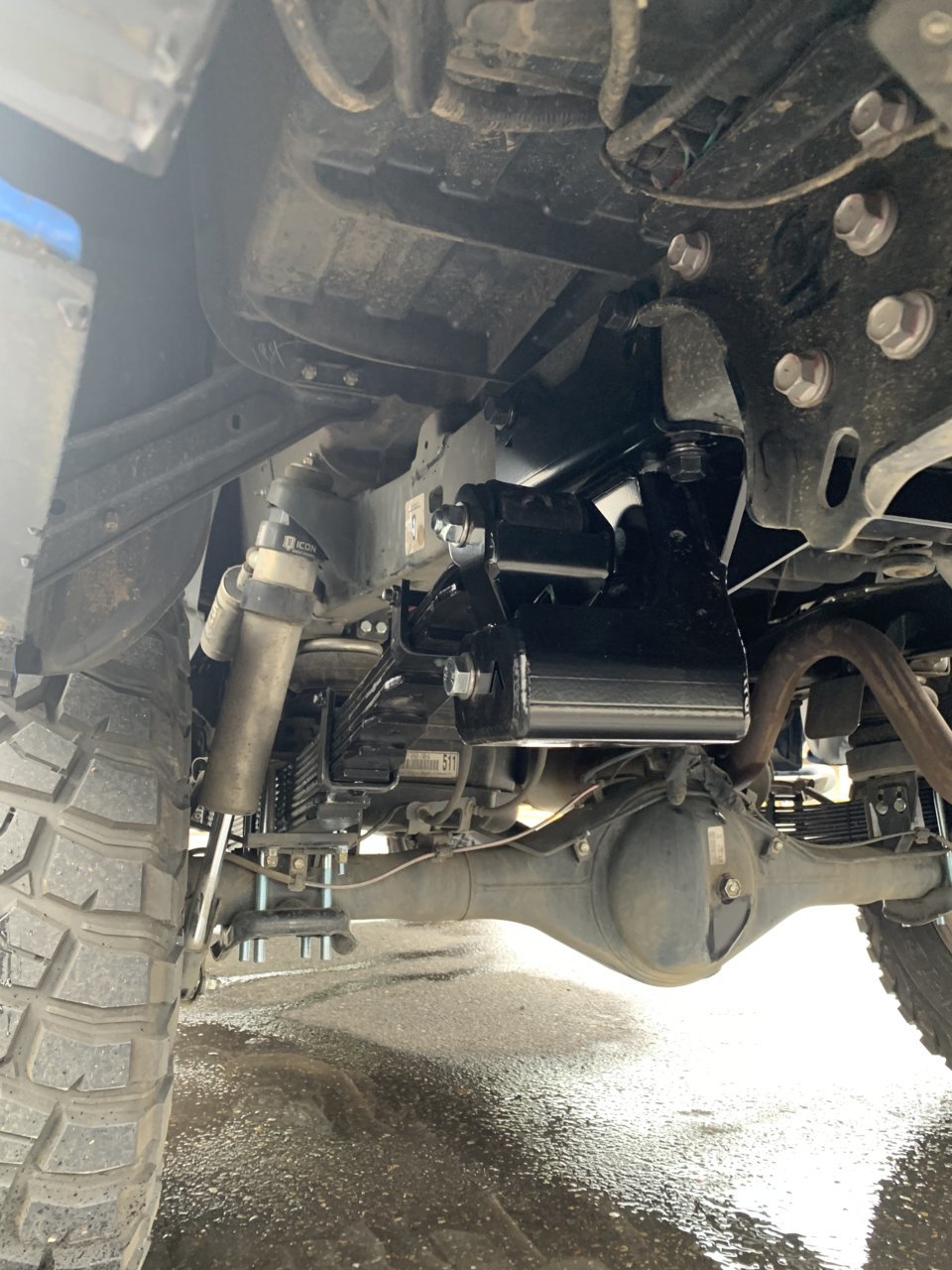

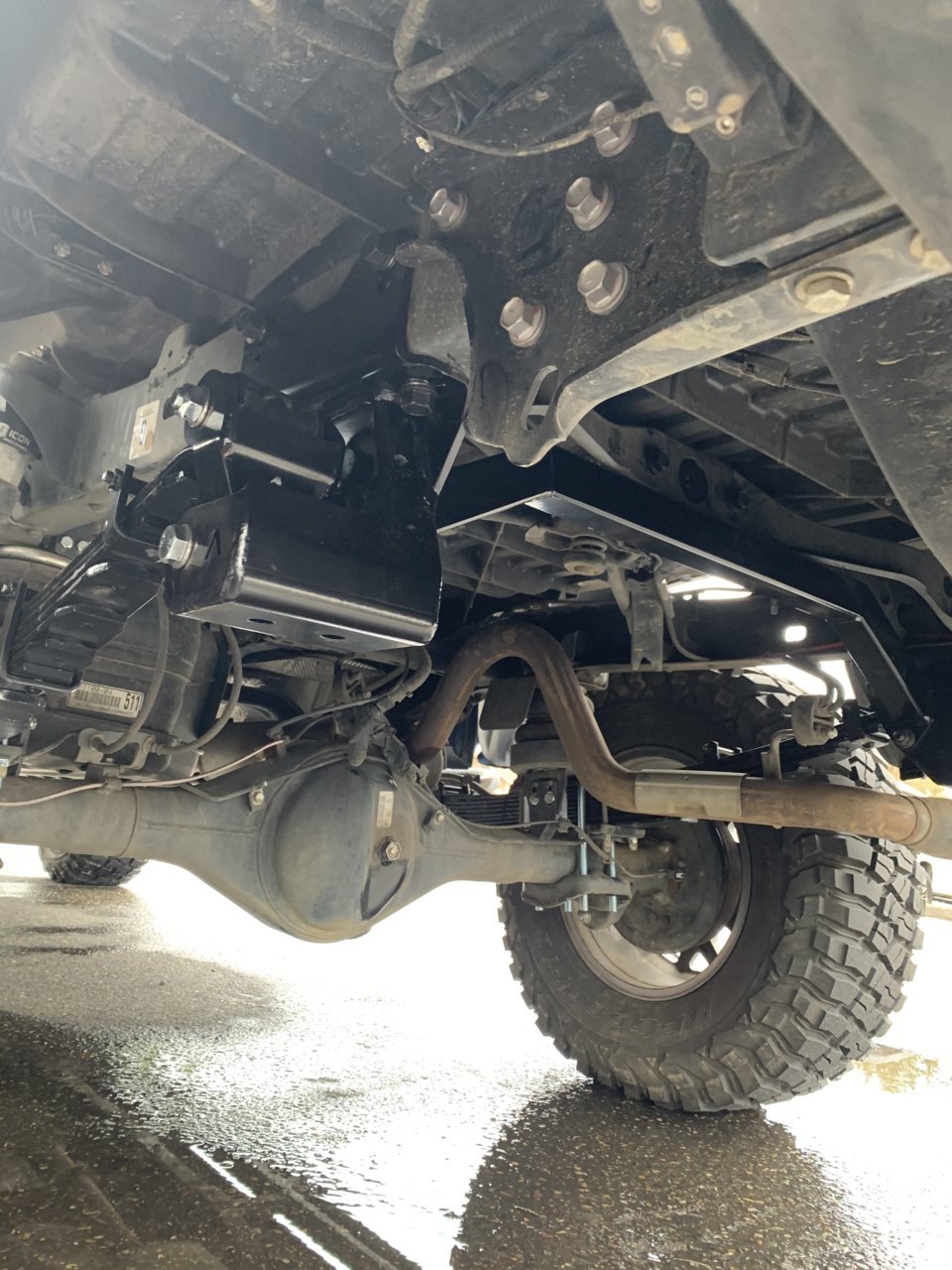

    Nice! I did the same thing this past weekend.
