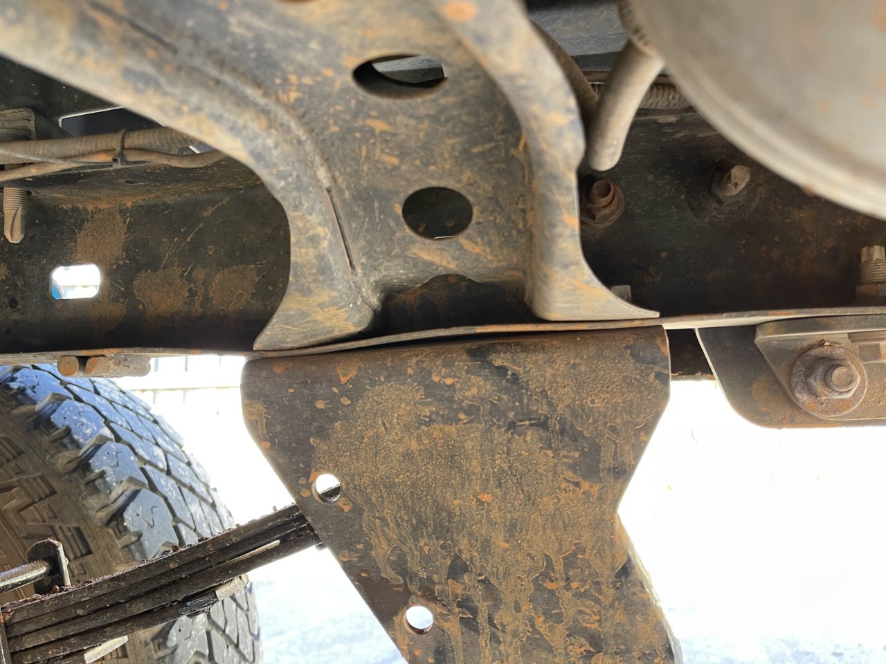

    Thanks to @ARCHIVE for reaching out to me on a Sunday. We’ve been texting back and forth, and despite the powder flaking off, the HH is apparently fine.
    I’ll be repairing the frame and buying a brace to prevent this from happening in the future.

    How the hell did you bend/twist the frame?

    Good lord, must have been some good wheeling there!

    Not sure, unfortunately.

    My opinion is the overloaded Tacoma, very easy to overload a Tacoma, I think we all know that now, and he said he has a light trailer as well.
    But its just more weight to add stress on the frame.
    Good reason for adding our cross tube option, as I have been saying for 3+ years, the cross tube limits stress applied to the frame, plus makes the ride and handling even better

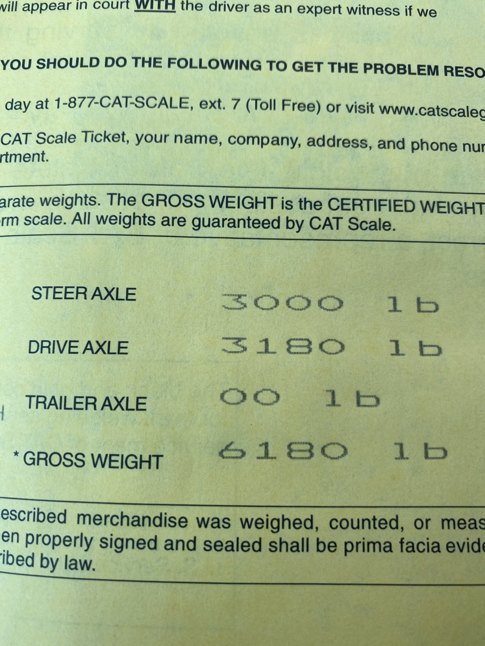

    I’m just over 6000lbs.

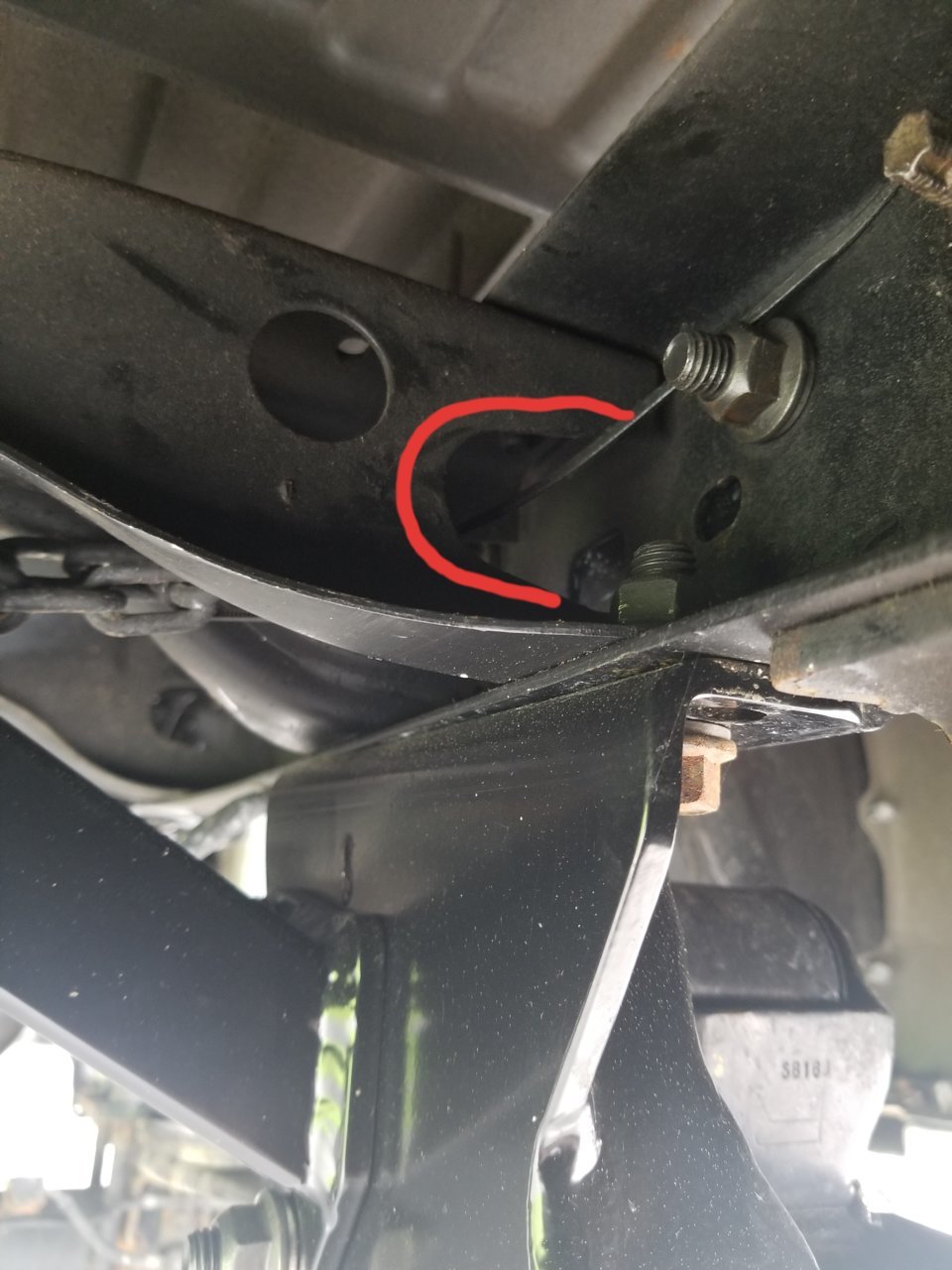

    Here's (another) weak spot in the Tacoma's frame design, which I blame for @Naveronski 's frame issue, these windows in the stock cross member that allow the frame bottom flanges to flex.
    Across the entire truck market from pickups to Medium and Heavy duty trucks/semis, it's known you bolt hangers to the side of the frame rail where the rail is strongest, only Toyota Tacoma has it bolt to a bottom flange, which is also not well supported.

    I remember using the air hammer to remove the rivets and washers after drilling through them on the inside bottom of the frame and it was pulling up that crossmember. I can’t imagine how much that area flexes under hard hits.
