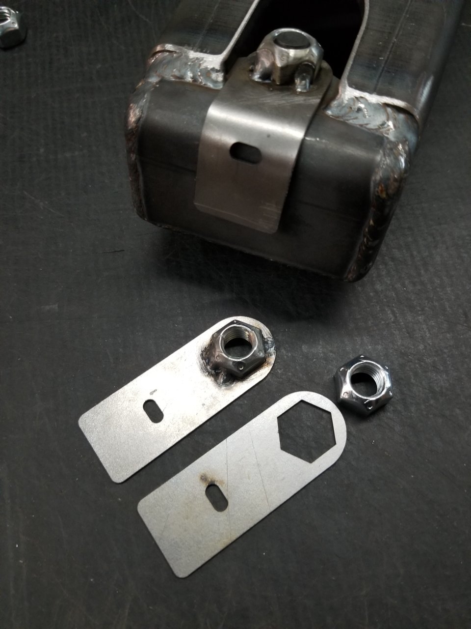

    '05 Taco, '22 Tundra, '91 Cummins
    2.5" Fox relocation * Hammer hanger * Archive MD springs
    So those are nut "flags" that get welded to the nut, so you can position the nut with your fingers or needle nose pliers. This is in an effort to keep the threads easily replaceable, with the carnage that can happen with severe duty use
    And this is necessary because I kept the tower as tight as possible to the bed for tire clearance

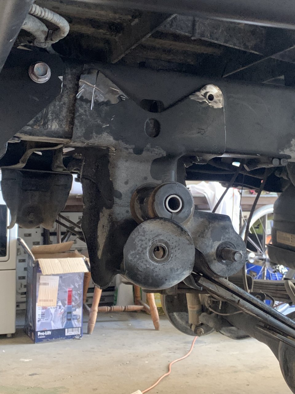

    Hammer hangers and crossmember done. Added a 1” block to my existing icon aal. Def have some rake. Will adjust coilovers tomorrow. I hate spanners
    side note— need a new bolt flip and prob some decent bump stops. The ubolts are def close to stripped.
    this install was a bitch! Lolol fuck those rivets. I actually cut part of the stock hanger to make it easier to drill. Made it easier for sure... glad I have protein here. What a workout above your shoulders. Lol
    I didn’t take a pic when I finished. I need to figure out how to connect the crossmember up top. I’ll prob weld it so it can be connected and disconnected remotely easy. Crazy how much rust under the stock hangers. It’s a 2020 with 16k miles. You can see the difference with hd hangers vs stock too:

    Does anyone think you're crazy for tearing apart a brand new truck??? LOL
    In case you didn't know, u-bolts are one time use fasteners. It sounds like you may have used yours a couple of times.
    BTW, I love my HHs! I have a couple of thousand miles on them, with and without a trailer. A huge improvement.
