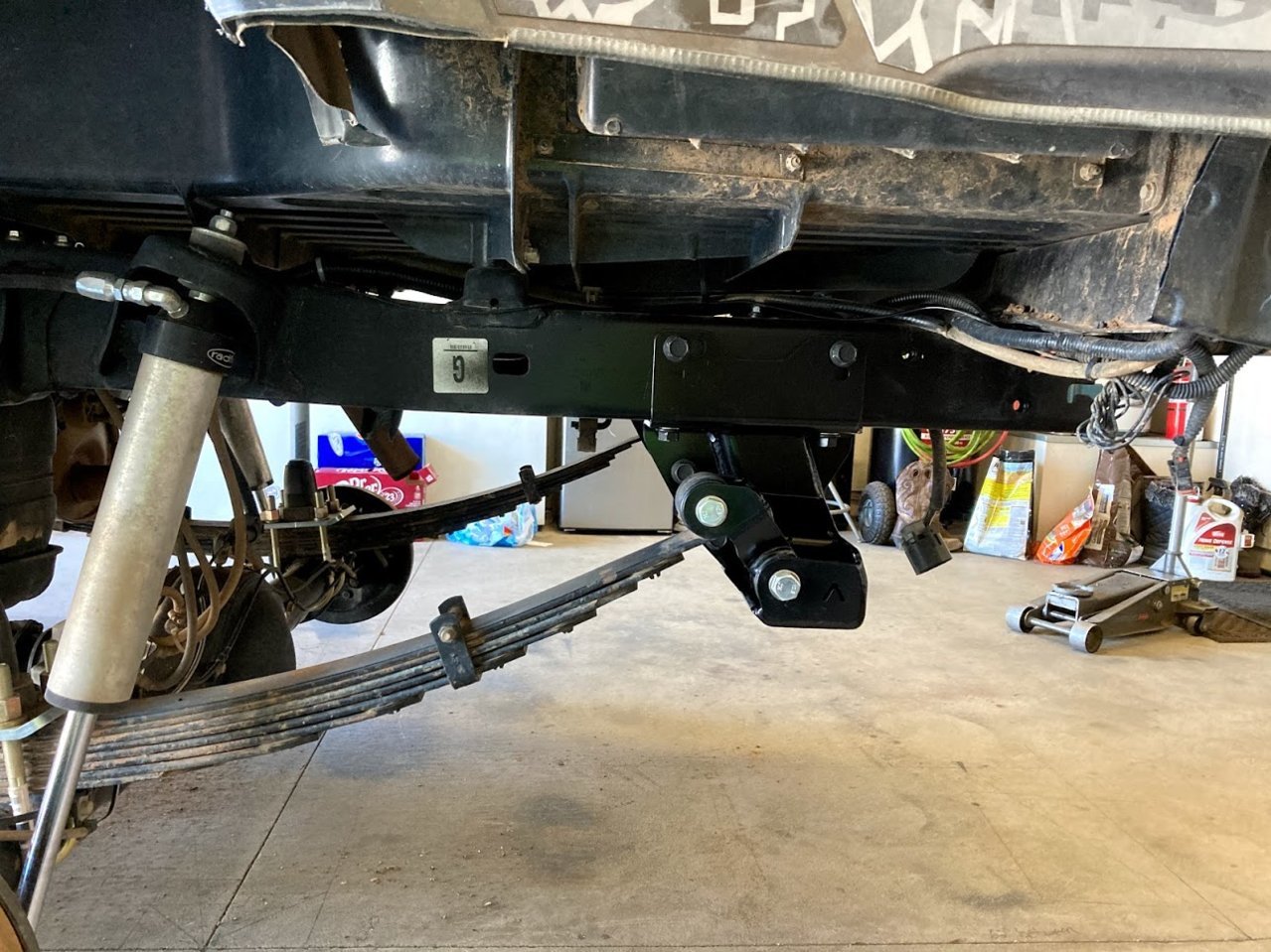

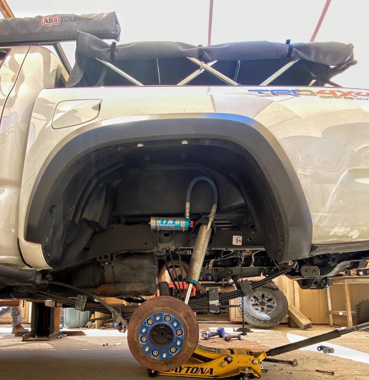

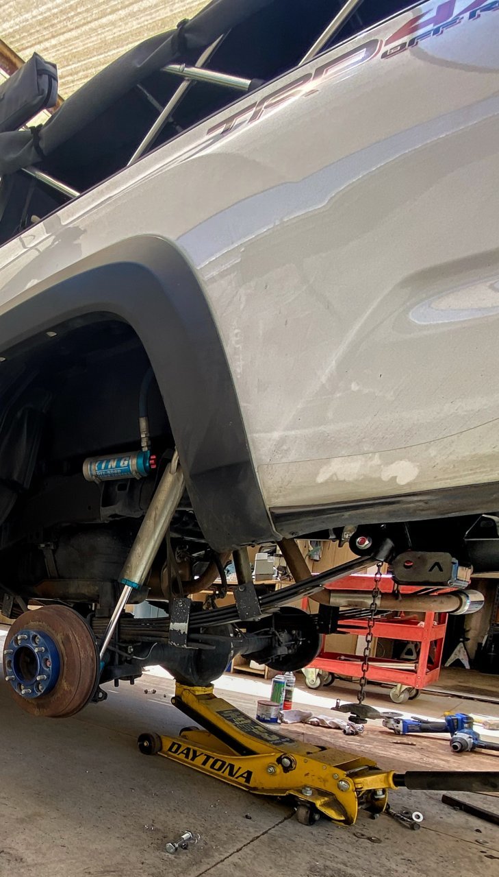

    55B340A3-2394-4BB8-B38A-11206F956795.jpg A44BDCEB-7869-48F4-ADC1-EC097BD21164.jpg 5CF99DF9-8ABD-4005-8004-BEB55669655B.jpg Finally got mine installed a couple of weeks ago. I’d been postponing this, but wimped out on the install. Glad I did because @Speed Freek killed it in around 2 hours, even with the chit chat, because if I hadn’t stuck around he probably would’ve knocked it off faster :D
    Hangers + poly bushings…

    Haha, chatting does add some extra time. I have done probably 40+ of the hammer hangars so I can do them pretty quickly since I know what it takes to get those darn rivets out! They dont just fall out that's for sure..
    But yeah these hangars really help the spring articulate better especially used in conjunction with the shackles since the new bushing isnt vulcanized to the shell and uses poly that can rotate allowing it to move without binding like the stock ones.
    And when used in conjunction with the relocation (I have done well over 50 of those) the rear wheel travel is hugely improved!
    The big change in having the hangars, plus the relocation with leafs and shocks you can barely feel the truck when you drive it off of small dropoffs since the travel drops out much further than stock and keeps the rear end planted pretty much ALL the time.
    IMO this is one of the best mods out there for the rear of the truck, once you go for a ride in one you're going to NEED one, haha.

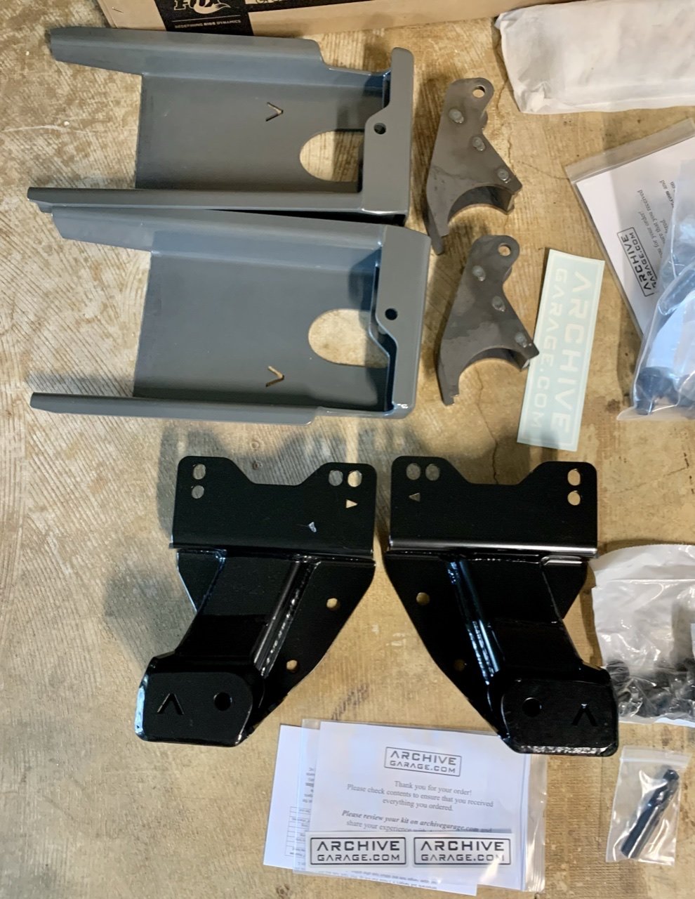

    These arrived just in time for the weekend. Anxious to see what they can do.

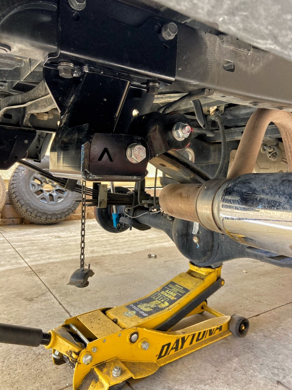

    Any tips on getting the lower rivets out? Top two popped right out. I would drill it out but the pilot hole i drilled is off center haha. Any harm in just welding it in and bolting the top two? Plug weld and maybe stitch the front and rear?
  12. Jun 26, 2021 at 9:55 AM
    #2872
    EatSleepTacos
    Mar 24, 2015
    #151688
    59,838
    Randy
    West Valley, AZ
    2017 4Runner
    Ball joint press and a bolt to push them out. After you grind the head off it of course

    I used an air hammer on the top ones that same way, but the bottom won’t budge. I’ll keep at it, but might end up just welding it on. I’m not trying to fight it all day.

    The lower ones have a welded washer on the back side that make them a lot harder than the side ones

    I’m saying grind the head off and then use a ball joint press and a bolt to press out the remaining rivet. No air hammer involved. The press will pop it out with no issue. Skip to 9:40.
    If you hammer on the lower ones too much you’ll just bend the frame up.
