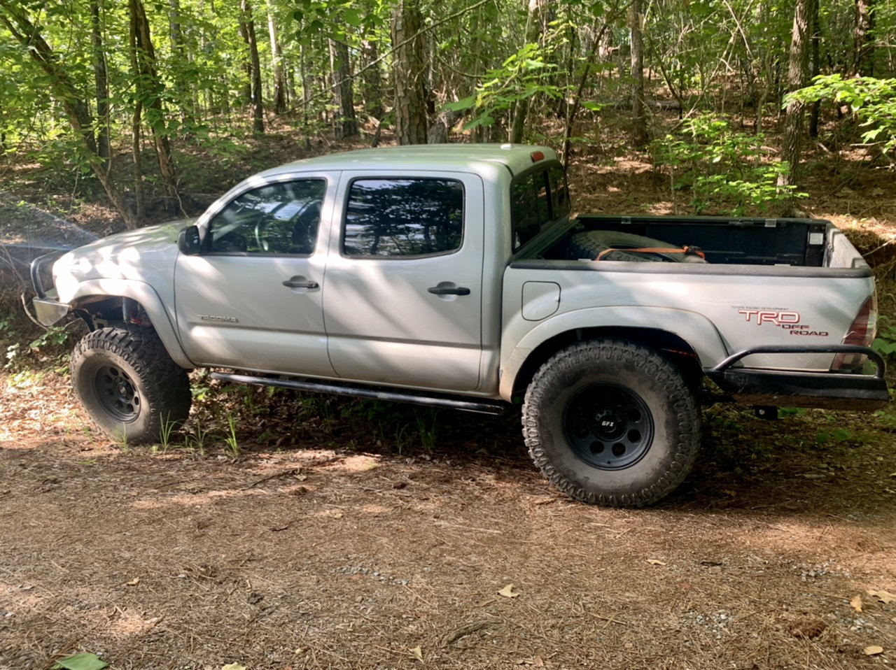

    Just ordered a set of Hammer hangers, shackles and a U-Bolt Flip kit. Will post some photos of the install once they and the Deavers arrive.
    A big thanks to Eric for his help.
