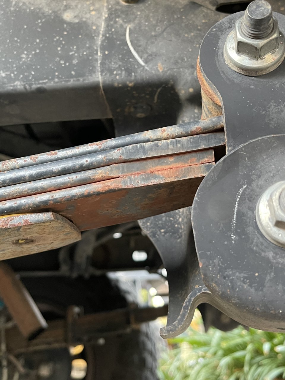

    I decided to space the bump up until I get a new leaf pack and then see where it’s at. No sense in doing it three times. Also, it’ll only be a 0.75” inch spacer for the bump stop which isn’t a huge deal. It’ll still compress under a hard hit at speed, but support the truck resting on it and crawling full tilt. That way I can keep the max droop at full tilt in case there’s room for another pack to droop before the shackle hits, since the dakars are a little shorter. If you saw how close it was to engaging fully it’d be a no brainer. I want all the droop and axle clearance I can get.

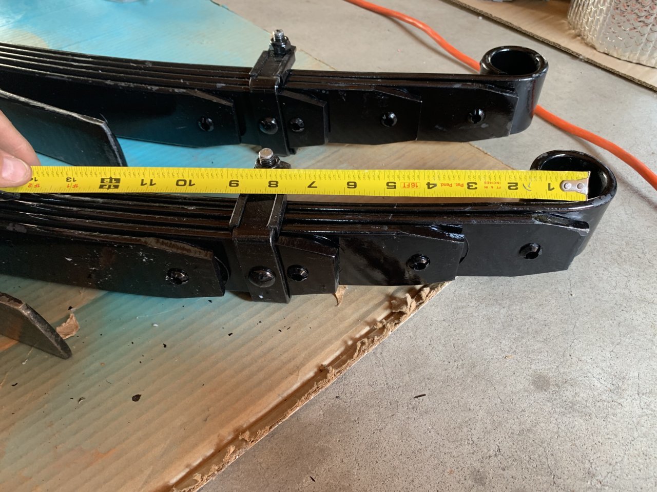

    I know for the time being I’ll need to cut. Based on this I would need to cut the 3 below the main leaf? I e see a lot of 2 and 3 leafs but looks like I need 2,3 and 4.

    I think just 2, because 3 and 4 are out past the sides of the shackle. Yours seems better than other people's

    yah that's what I was noticing. These are prob from 2017 maybe 2016 so a bit older.

    FYI - I received a "new" set of the Dobinsons L59-112-R leaf springs and installed them yesterday. The 2nd leaf now has a taper but may still have interference with the shackle at full compression. I am unable to test this easily, so I'll have to keep an eye on it.
