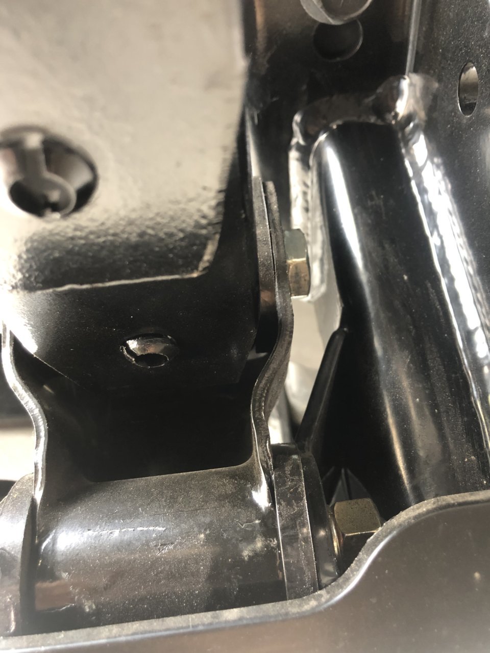

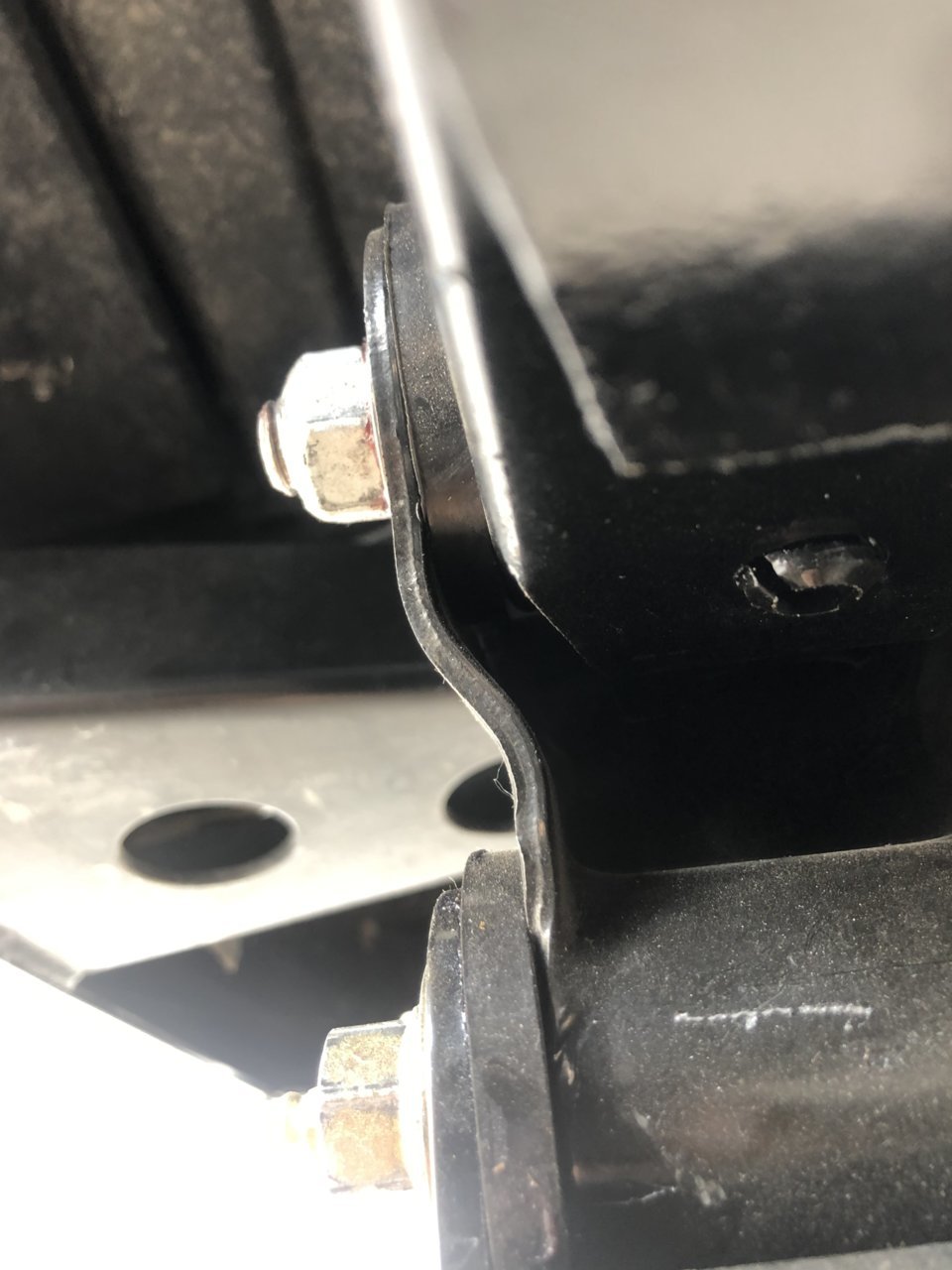

    Time will tell but it looks like there’s plenty of space to squeeze in there.
    These are brand new OEM shackles + 111’s

    Yup, the 112 used to be the only offending spring from Dobinsons, now all are

    Any leaves that extend inside the shackle cavity usually end up scraping the shackle, jamming into it and damaging it.
    Apparently many leaf spring designers don't understand how leaves slide sideways during articulation, or the clearance necessary for Tacoma shackles.

    Thanks for clarifying. I’ll still say that “usually” (speculation) and “do for sure” are not the same thing. Before black listing something it’d be good to test and/or wait for feedback. From what I see I’ve got a lot of room in there with the newer Dobinson’s and the picture I posted is the side with tighter clearance. The driver’s side has a much larger gap. I’ll do some testing over the next couple of weeks and get back to you, but so far I’ve been golden. About 150 miles so far with an easier trail done this morning.

    Head to a 4Wheel Parts of off road shop that have the flex ramps. Once you get the rear up on one side you'll see how much the leaves move laterally like @ARCHIVE mentions and you'll see if/how much binding you'll have with your setup.
