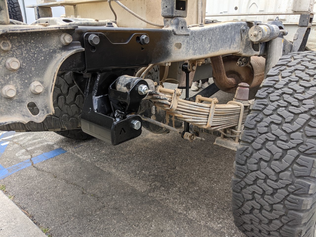

    This spring we had Aiden James Customs of Santa Monica install Hammer hangers on our custom Deaver springs with great results. The custom springs were, I believe, $300 more than the heavy duty Dobinsons (model 176).
    The new hangers! Notice the amount of leaf springs

    wow those v3's size is almost shocking even compared to my v2's. pretty amazing what @ARCHIVE has done with those.

    That’s some serious springs. I thought my Deaver III’s were beefy.

    You'd really benefit from a cross tube for those hammer hangers considering your camper. Only problem is moving the spare tire.

    Thanks. Carrying at least 7,000 lbs full time, according to Deaver that’s what was needed. Looks like the leaf pac from my old F250

    Yup! But like you said where does the spare go. Guess I could just travel with a tire repair kit - nope!

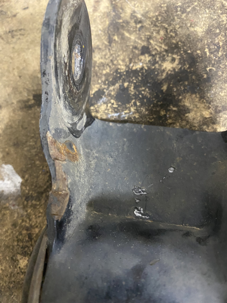

    Dobinsons 112 pack. These are the shackles I took of when I installed HH, so they will probably fan out more and be worse with HH. No more “speculation”

    Thank you for posting the evidence to help others understand.
    For others reading this:
    Any leaf pack where the 2nd leaf that extends inside the shackle cavity is NOT compatible with the Tacoma shackle arrangement. Currently, this includes all Australian leaf packs from OME, Dobinsons, which are based off the typical Hilux design, and the standard Alcan offering, must be modified to avoid damage to Tacoma shackles and jamming while articulating.
    The interference is due to leaf packs not being designed for the application.
    Know what you're buying people, be discerning
