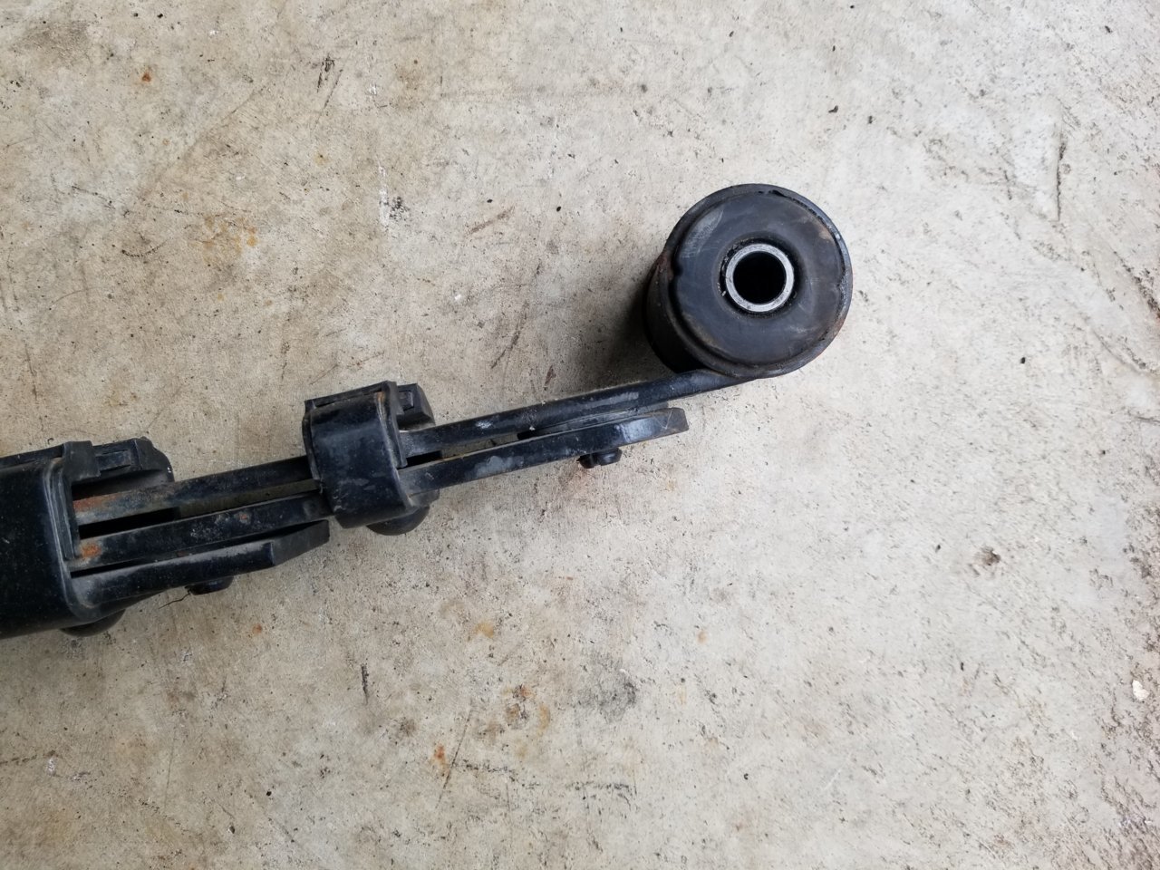

    2020 Tacoma TRD OR
    What is would you recommend as a solution to this? Trim the end of the second leaf? I'm getting ready to install my 111's with HH and I was planning to reuse the stock shackles.

    Check out these stock springs as an example.

    Do you have thoughts on trimming the leaf to look more like the stock geometry while the leaves are still packed together?

    I just wedged a pry bar in there to separate the leaves and cut with an angle grinder. It's not rocket science, just be careful to not cut the other leaves.

    Exactly, also drooping the axle out, with vehicle securely supported by jack stands helps separate leaf pack, which makes it easy to spread leaves with a shim of wood @TyLxer_VLI

    Ah good point. I did still had the truck up on jack stands after my HH install when I trimmed the leaves

    Okay nice. Good to know its not too much of a hassle. Still kind of sucks to cut into a new leaf pack that was sold to fit the vehicle as is. Live and you learn I guess

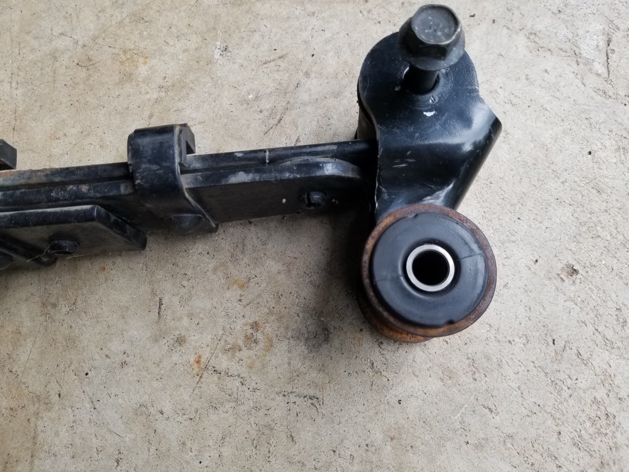

    On the topic, I just had a friend come over with some HD Alcan and his extend into the shackle too and have gouged it. He has HH and 3.6 shackles and archive relocate. Not sure if that’s been talked about yet.
