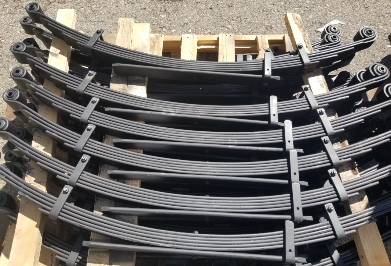

    The first batch of Archive HD springs have landed, have a few people lined up,
    100% Archive designed. Note the shackle clearance
    Made in USA with US 5160 steel, includes bushings (Deaver has no part in these)
    (A smaller batch of MD springs are also in production, hopefully Oct)
    Heavy Duty: Estimated ideal range upped to 700 (3")-1100* (2.75") added to rear axle, 600 min recommended weight (due to high lift). These will use 12" shock travel, as long as you don't seriously limit your up travel.
    *1100 lbs added to rear axle is possible within factory GVWR and GAWR specs due to weight transfer from front axle to rear axle and gear such as rear swing out bumpers.
    Medium Duty: Estimated ideal range 300 (3")-600 (2.5") added to rear axle, 200 min recommended weight, 750 max recommended for proper performance but will be lower lift. These will use 12" shock travel, as long as you don't seriously limit your up travel.
    Plan is to give a discount on 10 pairs of HD springs, probably $750 pair + shipping, below normal pricing (high steel prices).
    Discount is because of being the first buyers helping launch these and I will be asking feedback.
    Preference will be given to Archive Hammer hangers customers. Still need to come up with a name along lines of an explorer, had some good recommendations before like "Leif Erikson", so taking ideas to. For reference, my 1st gen Tundra springs are named after Ernest Shackleton.
    Start a conversation if you are interested. Thank you!
    History: I already tried an HD test pack a year ago on the shop Tacoma, and I would like test the MD on my truck as well (October hopefully) to verify lift and load capacity hit my estimates.
    Archive has about 5 years experience spec'ing and designing springs for the 1st gen Tundra, we offer HD and MD for the 1st gen Tundra with great results, so following same method for the Tacoma

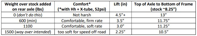

    Info from 2nd person to install the HD vs Deaver U402 stage 3
    Ok here is my experience with the Archive HD springs in table form with actual measurements. At 1000-1100lbs, these HD springs result in a comfortable and composed vehicle ready for spirited on and off road use. (Also comfortable at 600lbs)
    I am upping HD ideal range to 700 (3")-1100* (2.75") see quoted post above.
    *1100 lbs added to rear axle is possible within factory GVWR and GAWR specs due to weight transfer from front axle to rear axle, such as while towing and from adding equipment such as rear swing out bumpers.
    I did test the HD springs weight way over the intended range (1500lbs) for testing purposes only, and the performance did not fall off too bad, but logically got soft, but still had 2" lift and still could explore off road.
    Do NOT exceed Toyota's GVWR rating for your Tacoma.
