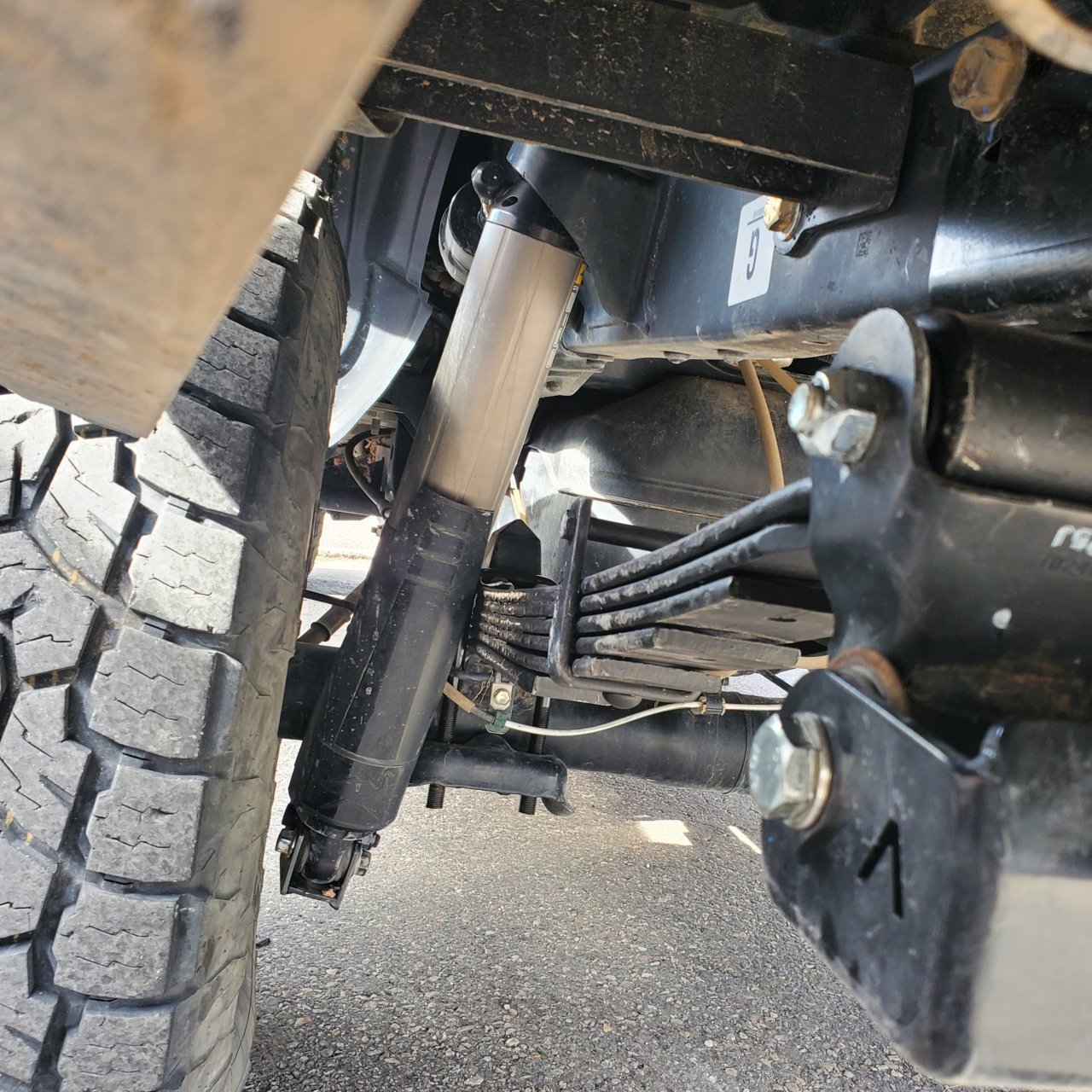

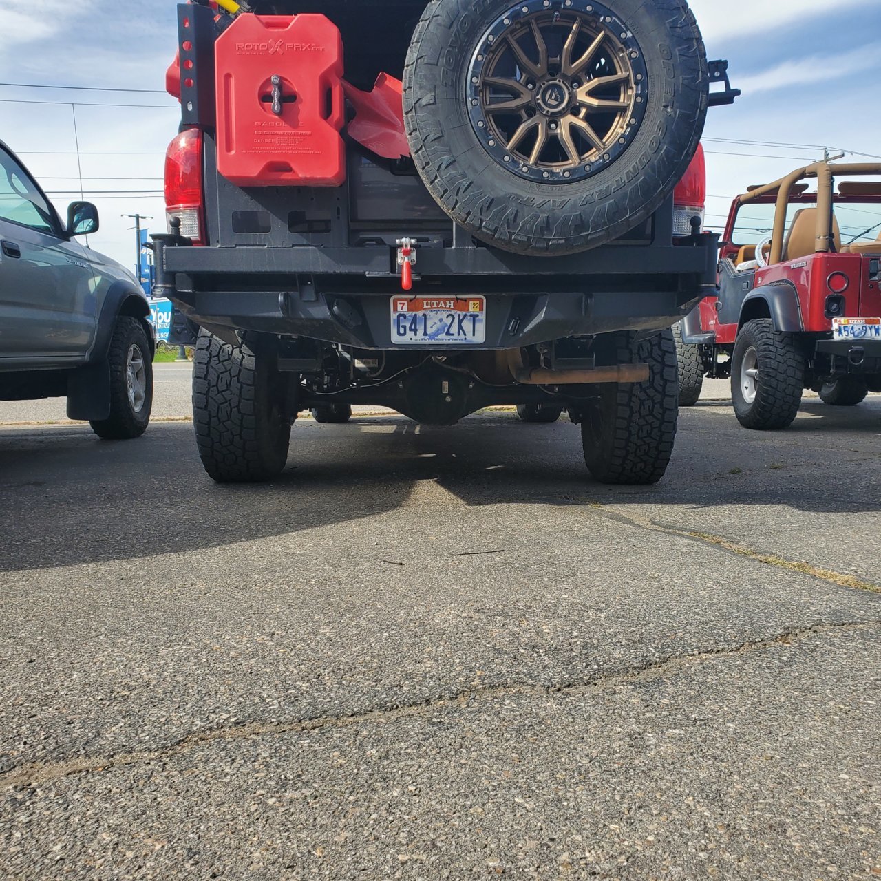

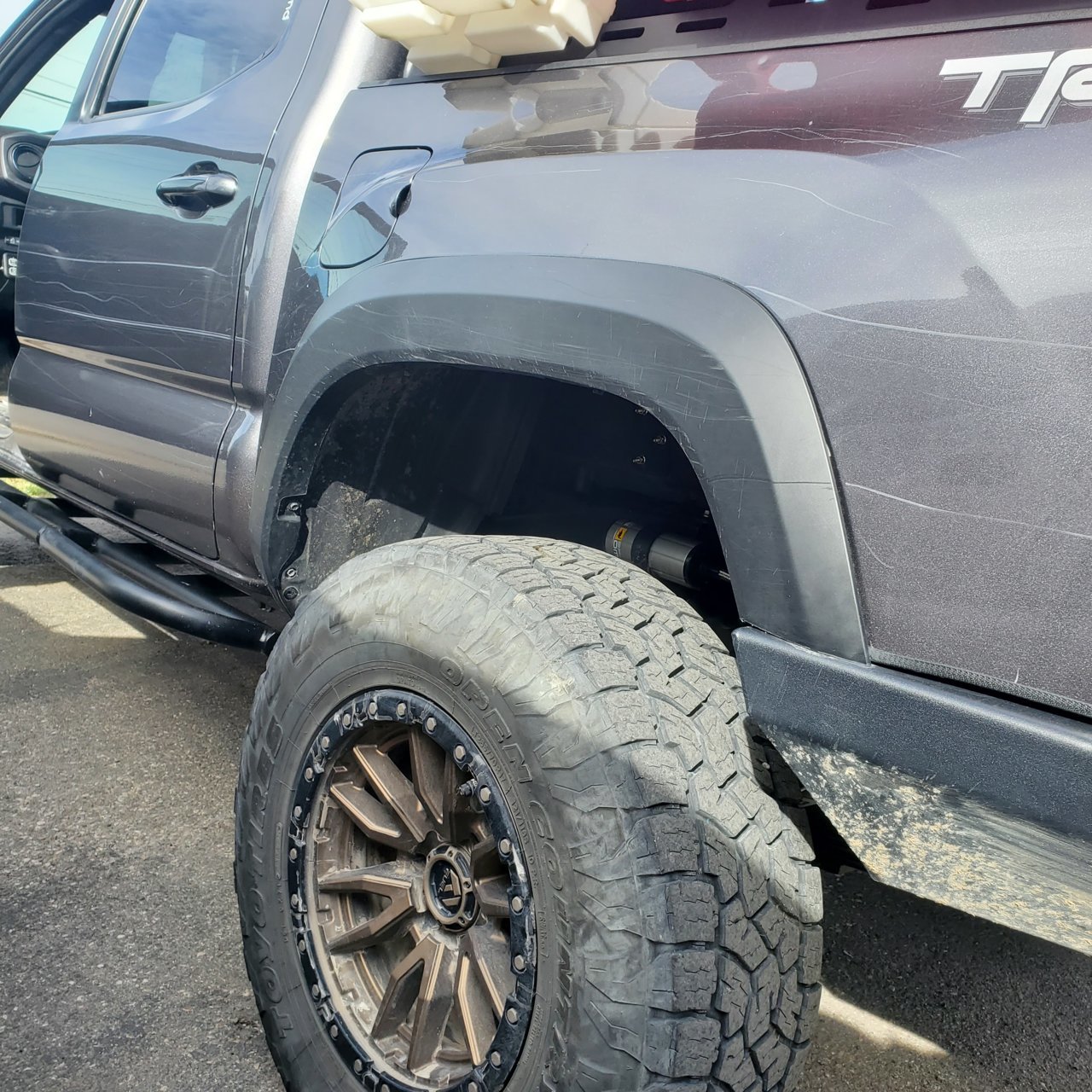

    Just got my HD springs installed. Much better lift then the old man EMU HD springs.
    Old Man Emu HD springs Measurement from axle to my frame, next to the bump stop cover is 8.67 inches giving me about a 1/2 inch lift over stock
    Archive HD springs Measurement from axle to my frame, next to the bump stop cover is 10.64 inches giving me about 2.5 inch
    2017 tacoma
    MY truck is VERY heavy, Steel front and rear bumpers, steel skid plates, steel rock sliders, gas-tank cover. running on 33's. Check out my instagram for pictures of the gear that I have on my truck @birdoverland.
    Ill be filming a YouTube video this weekend with a review
    I have the Hammer hangers with support cross-tube installed
    BEFORE
    AFTER

    my estimate is around 7800 LBS. im going to weigh it this weekend. my buddy has a similar build at that weight

    Wow and I thought I was heavy. I’m around 7k fully loaded and deaver has the xxxhd or what not on order and said they couldn’t go higher which is about 15-1600 over stock. your another 800-100 more. How’s it sitting?

    I love that i can get in and adjust my BP51s now without putting the truck on a lift. I think its sitting perfect right now
