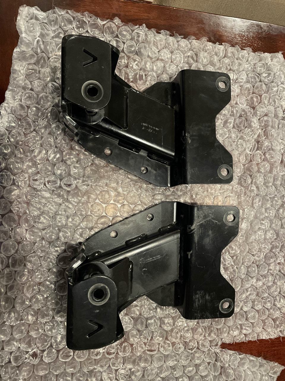

    I just picked up a set of hammer hangers off of a member here on TW, and I am wondering what version they are. Really just want to make sure they will work with my setup. I am running an Icon RXT leaf pack on option 3, and I plan to use the stock shackle. Any info or advice would be greatly appreciated.
    dumontrider likes this.
  18. Oct 31, 2021 at 12:55 PM
    #3178
    ARCHIVE
    ARCHIVE [OP] Well-Known Member Vendor
    Oct 29, 2015
    #168099
    2,253
    Eric
    Orchard Park, NY (Buffalo)
    '05 Taco, '22 Tundra, '91 Cummins
    2.5" Fox relocation * Hammer hanger * Archive MD springs
    Of course they work with all springs.
    Those are Version 1, you'll get a small bit of lift to offset the low lift from RXTs.
    The stock shackle is a good choice, works totally fine, but the rubber bushings may limit droop if you have 12" shocks
