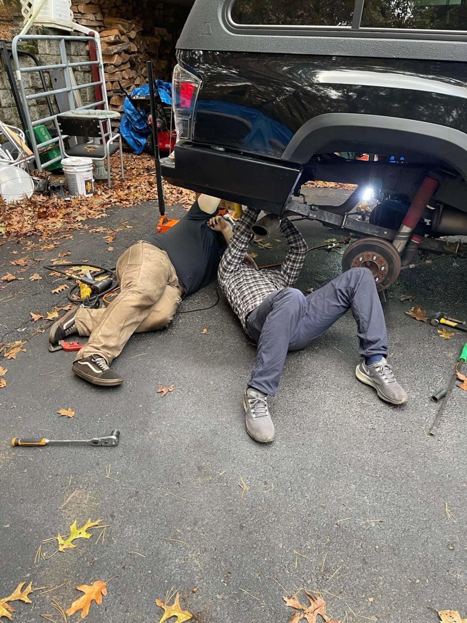

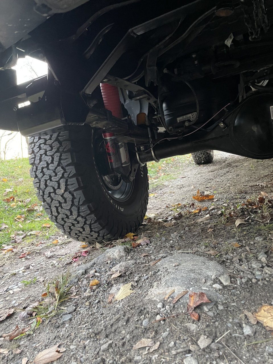

    Just installed these yesterday. Everyone talks about how hard it is to get the frame rivets out - and they're right. Those things are really in there. I thought we had a good plan in place to grind off the heads and then push them out with a ball joint press but it wasn't that simple. If I were to do it again I would:
    1. Grind the heads off the rivets, and then keep grinding down a couple mm into the stock hangers
    2. Pry off the stock hangers with a pry bar. You can get good leverage on it from the inboard side
    3. Grind off the remaining rivet shank down to the frame
    4. Use BJ press, pneumatic hammer, or hammer drill to remove the remaining rivet
    The only other note I have on the process is to go ahead and drill out the rivet holes with a 1/2" bit before trying to install since the hardware is too big to fit the rivet hole. Oh and the vertical frame rivets have the washer tack welded on which I wasn't expecting.
    Keep all the hardware loose until you've got everything together! The crossbar's tolerance is super tight. We had to leave one bolt out initially until everything else was tightened down, then had to ream out the hole just a little to make the last one fit.
    Haven't gotten to do a lot of driving just yet but I did notice that the truck felt more in control at higher highway speeds on the way home.

    I am glad that you and Drew were finally able to get them done. It's interesting because out of the three that I have done so far, I didn't have to use the tack-weld method. I would have jetted over there to help but I had to take my kids out for Halloween. I was a little worried when he called me at 4pm to ask about the rivets and I was worried you guys weren't going to finish before nightfall. I am glad you got it done though. You are correct about the crossbar tolerances......on the second ones that I installed, we bolted up everything loosely, the hangers and crossbar, then tightened the hangers, then the crossbar. The tight tolerances just goes to show the exact quality that @ARCHIVE makes then to. :thumbsup:

    Ha yeah man me and @tacobell007 were in a full on battle with the rivets for a while there. Wasn't sure we were going to get it done before dark either. Once we ground down the rivets to the frame (we had already popped off the stock hangers) they came right out. Your advice set us on the proper track, so thank you.
    As to the crossbar the only one we couldn't get lined up initially was one of the frame connections. The holes just didn't line up perfectly and needed a little extra encouragement.

    It almost sounds like you didn't get instructions, because they warn installer about the welded washer and drilling the rivet holes to 1/2". You didn't use the stainless shim for cross tube with the Hh in the rearmost position did you? Because that is only for when Hh are moved towards the engine in the foremost position. First time I heard the fit was tight. The cross tube is built in a fixture that limits how wide it can be

    Oh I got the instructions, but I did not read them :anonymous:. No, we are in the proper holes for the crosstube. The adjustment was very minor maybe 1mm but enough that the hardware wouldn't slide in without it.
