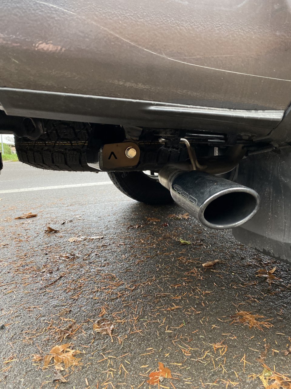

    Hammer Hangers installed with help from my brother!
    Ride quality is improved as advertised and they look sweet. I’m happy with the purchase and would recommend them to others. Like someone once said on the KDMAX thread…don’t be be stupid…just do it!
    Removed the exhaust and mud guards for more work space and cut the stock hangers off for better access to the rivets. The bits from Archive did a great job so be sure to get them.
    Thanks to all the helpful posts and @ARCHIVE for a sweet product!

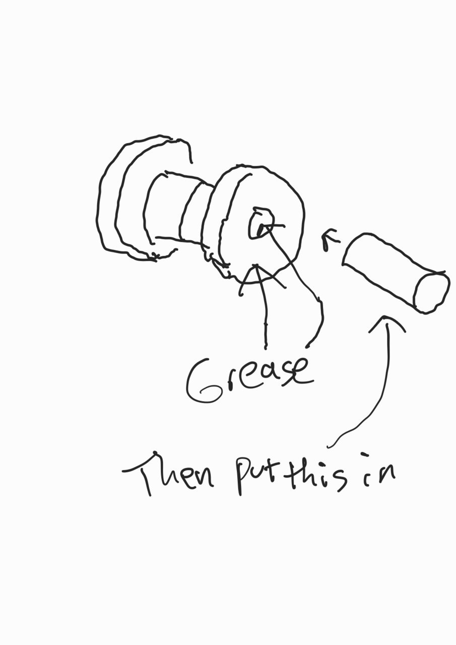

    I did the outside to get them in, the inside to get the metal bolt tube through them, and the sides of the outside before it goes in the shackle and I have never had an issue......plus.....

    You can put a light coat of grease on the outside of bushing barrel/leaf spring ID to prevent the leaf ID from rusting. But the bushings don't turn inside the spring, the bolt sleeve turns inside the bushings.
    The areas to heavily grease are the outer face of the bushings and the inside the bushings

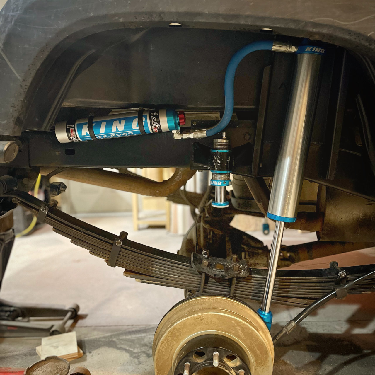

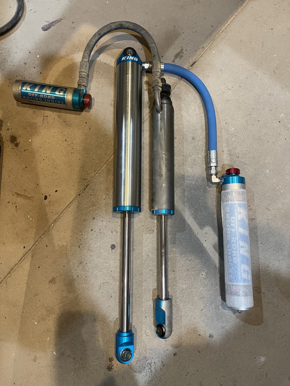

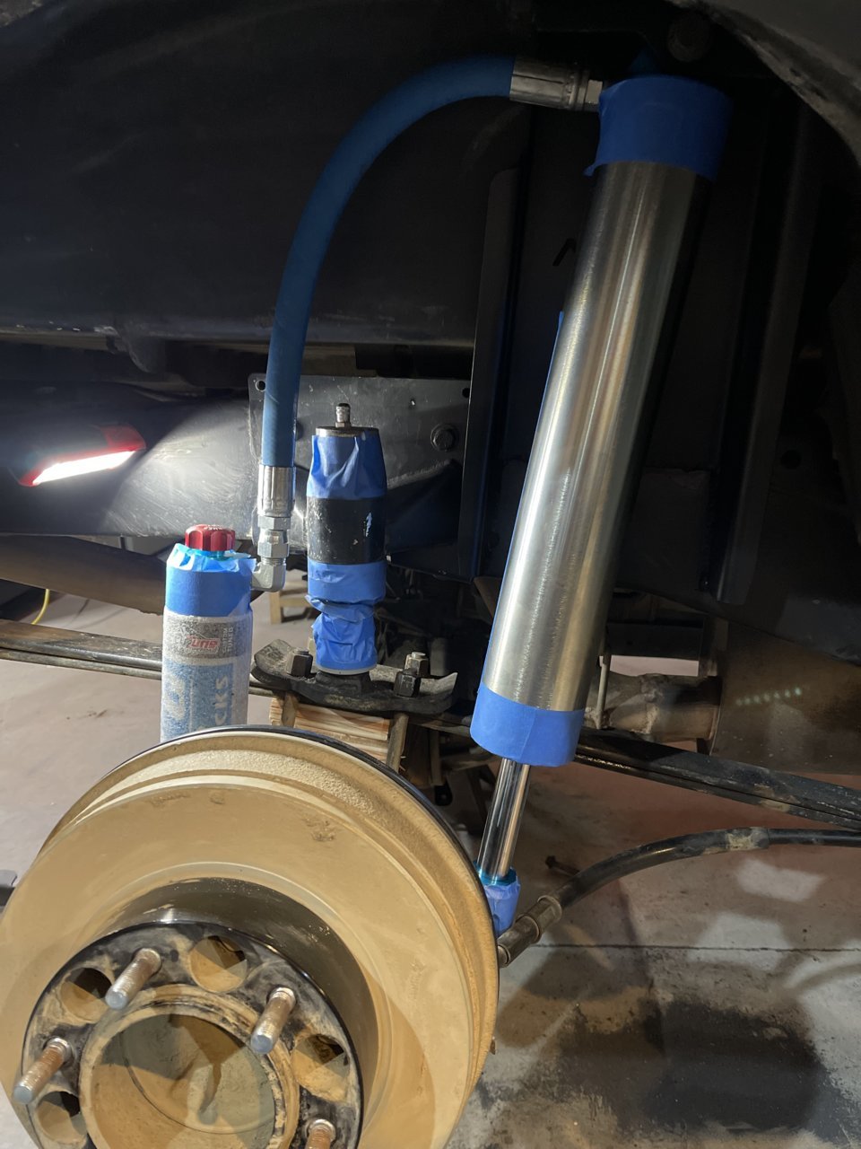

    Huge shoutout to Eric at @ARCHIVE for his amazing shock relocation kit! His communication and customer service has been nothing but extraordinary, responsive, and helpful.
    I was able to stuff KING 3.0x12" smooth bodies (2.5 reservoir w/ comp adjusters) into the kit without a hitch. The only modification I needed to do was modify a 3/4" wrench for the top shock bolt nut since the 3.0 body is larger it barely provided enough room to get a wrench back there. Everything clears perfectly, measured and installed at full bump (1/2" shock shaft showing) which I can also adjust later on with the King bumpstops.
    The photos below show the comparison of 3.0x12" shock to an OEM EXT King shock. As well as the reservoir mounting with the larger resi's. Accutune is who I went through to provide the shocks (waited 9 months), doing their custom "adventure" tune to match the weight of the truck (6500lb's). So far the ride quality is phenomenal, incredibly smooth and very controlled. No testing for high-speed or jumping has been done yet but I'll provide that data in the springtime.
