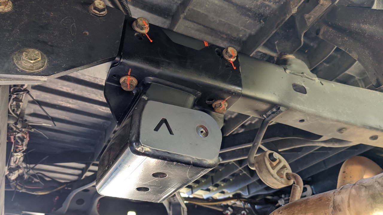

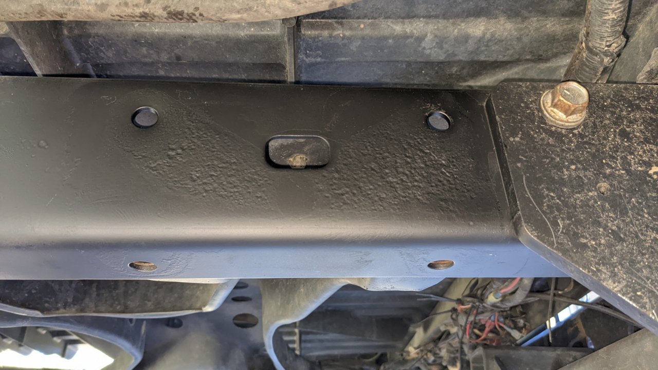

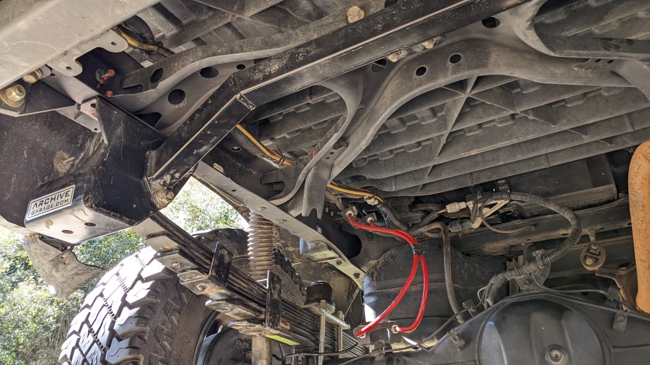

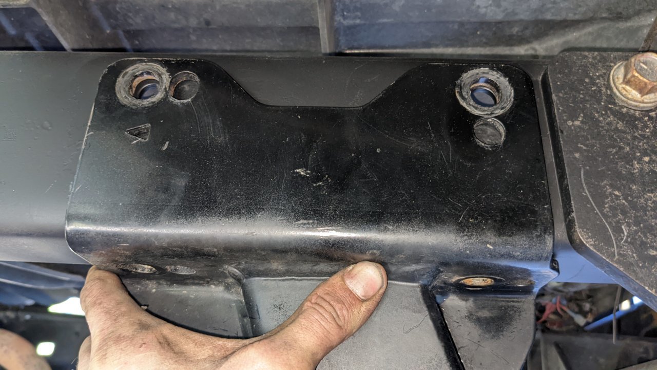

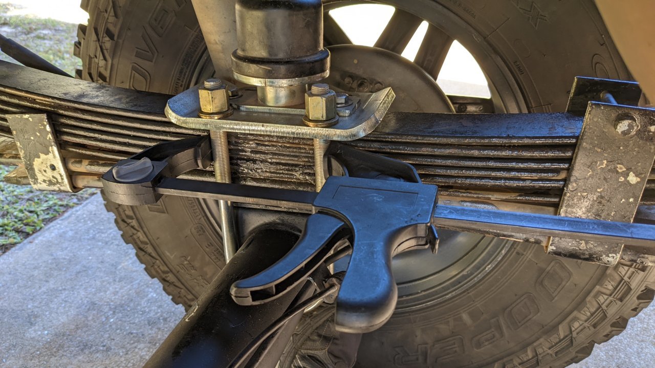

    Alright so my initial reaction above was written after just a quick 5 mile shakedown run to Taco Bell and back.
    Here's some more complete thoughts after a little highway driving.
    These things are phenomenal.

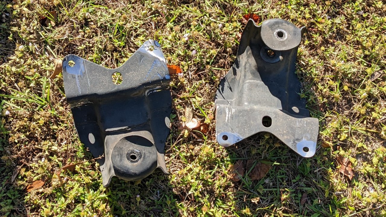

    They look sturdy in all the photos and even on the one or two trucks I have seen with them in person like @TacoFMS but when I picked them up from @Dayman Karate I was impressed by their heft, after finally wrestling off the old hangers (which honestly seemed flimsy even when I first got my truck as bone stock) I have to say these Hammer Hangers are Beefy Chonkers!
    The old hangers I could flex with just my hands, and after cutting the rivets out and holding them in my hands I realize they get most of their rigidity through being riveted to the frame, they were easily bendable by hand and deformed greatly as I used both hands to wiggle and pry them off before the last remnants of the rivets would let go.
    I have to say it's honestly like Toyota didn't want these sobs to ever come off.

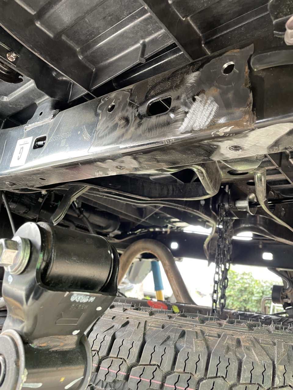

    They're absolutely flimsy, I had one minor spot of rock rash on one of them as I've only gone on more technical rock crawling trails a handful of times but they were still tweaked up, hell even just torquing the bolts to factory spec pinches the stock hangers shut some.
    That said, the only saving grace in this job is that the rivets and gangers were relatively soft steel.
    I think I threw every trick in this thread at them, ball joint press (more trouble than just more drilling but less hot steel rain?) drilling part way through and sir hammering (mildly successful) drilling through larger (most successful) air hammer (mostly just makes noise) sawzall (great for getting rivet heads off so there's less to drill and grind but went through a lot of blades due to force and angle) cutting through part of the hanger to get the vertical rivets, (recommend this, don't even bother trying to save the factory crap) grinder with cut off wheel, flap disc, and even a grinding wheel, and ultimately brought out the air due grinder with burr bit.
    Those rivets just do not want to let go!!!
    If I had some extra hands I would have pulled the bed and used my plasma cutter, as was did this all solo and was on a time constraint so didn't want to rip apart the whole truck.
    Ultimately I drilled them out at 3/16, 3/8, and 1/2 and still, the passenger side I had to use the air chisel between the hanger and the frame to get it to come off enough that I could work it off by hand the rest of the way as there was a thin bit of rivet left just barely hanging on but that was enough to hold fast.
    Honestly I was a little surprised with the bit of rust that was behind them, hit that with a wire wheel and went over it with some Rust-Oleum contractor spray enamel.
    At least with these if I ever feel the need I can unbolt them check and wire wheel or repaint as needed easily, but being as I never see salt down here in the southeast I'd be curious to know how much rust is behind the factory hangers on a Northern truck. Anybody who still has the factory hangers may want to try beating on the inside of the frame opposite the brackets or checking for any kind of swelling from corrosion between the plates.
    Still not sure if these are mounted forward given I'm using the forward holes or rearward given they are further back on the truck.

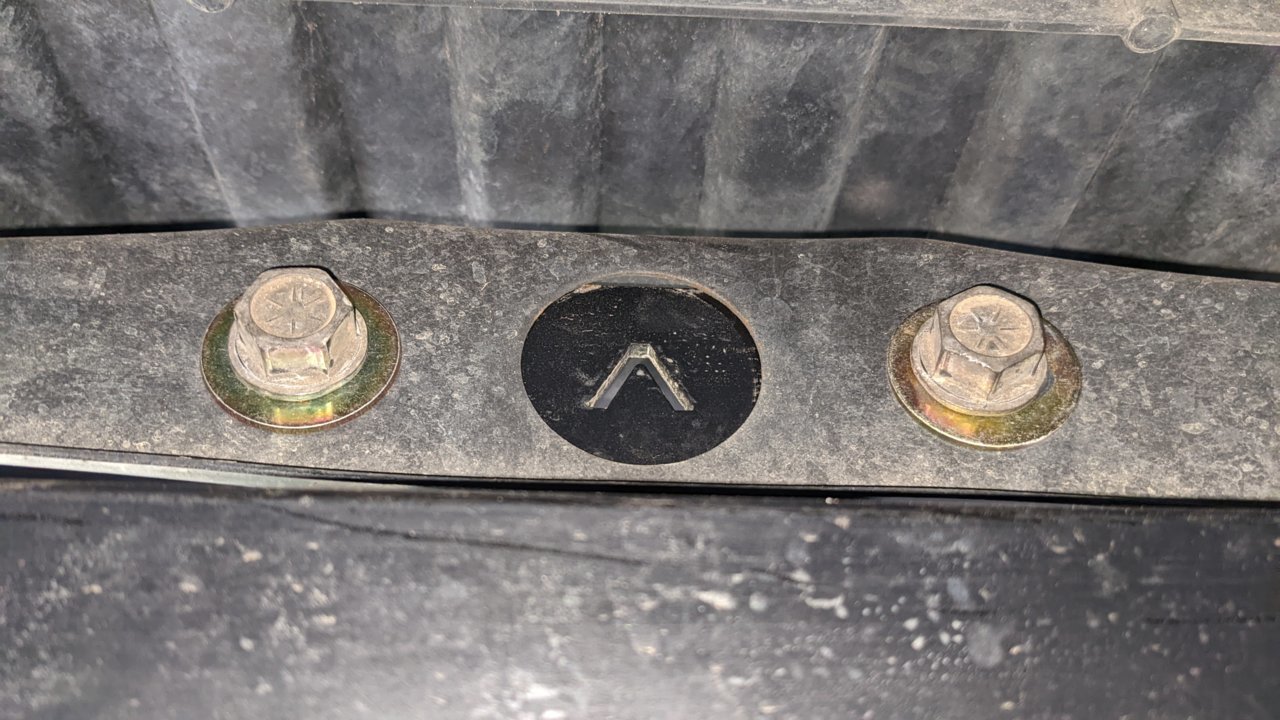

    Next up the cross tube, came with a shim, shim wouldn't have fit so not sure what it's for.
    As is after torquing down the HH's I had to start the high clear cross tube from the back near the top and persuade it forward with some solid hand smacking then pivot it up into the X brace and use a spud to align the holes. Don't know if that means my frame itself was tweaked in too and not just my factory hangers... Hopefully not, either way the cross tube noticeably firms up the rear end and that's even before driving it!
    I was really impressed by the little laser cut "A" that pops up perfectly centered in the gap of the factory bracket, clever, a little "Apple'y", unnecessary, never going to be seen and I'm sure it adds a step in manufacturing but still, clever, it really gives a high quality "this was really thought about" feel.
    I was using a Timben active off-road bump stops and U bolt flip kit but they're really tall, a positive and a negative more on that in the ride quality section, decided to try the wheelers super bumps, also put in Dayman's old OME HD packs and added a 1⁰ angle shim "fat" end forward to pinion down, plus the middle leaf from an original factory 3rd gen leaf pack as the Dakar's tend to "W" under load and my truck is heavy, I do not regret the time it took at all definitely seems to help so bow I have Dakar HD+ pack?
    Install tip, if your U bolts are splayed a bit wide at the top a squeeze clamp makes them a lot easier to get in the plate holes.
    The geometry on the HH's is really good, the shackles went right into them (though getting the nut started on the rear most bolt was a small pain as it's in such a tiny pocket with access from only one end) with just a tiny bit of pulling down on the rear leaf eye and the bolt slid all the way through easily.

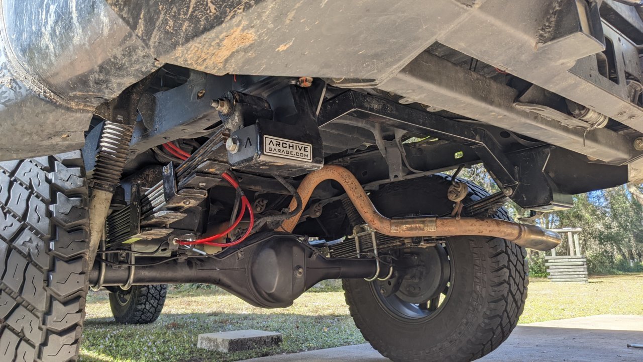

    Might finally be giving my TRD cat back the trail slash as at full even droop left/right it makes light contact, at uneven droop I imagine it will touch harder and when I get the shock relocation done it's definitely going to be in the way.
    The question is should I just hack it or do side exit "boat" exhaust?
    Specked Deavers are still on the "eventually" list though but for now a lot better than it was.
    It looks so good though!
    And considering the amount of overhead drilling cutting grinding (especially that dang air die burr bit making billions of tiny needles) the number of burns and embedded metal slivers in my hands knees and back were minimal, wear safety glasses and a face shield too!

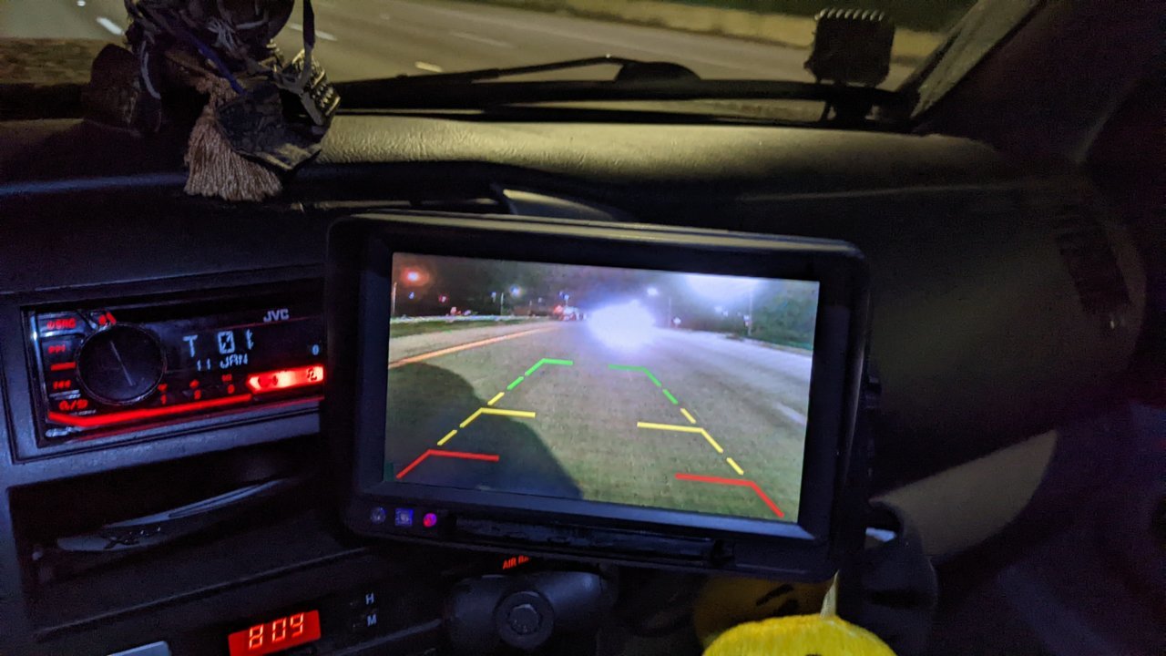

    Hammer Hangers and the cross tube nearly completely eliminated all my "driveshaft" vibes which were apparently just the flimsy hangers flapping in the torque.
    If you're lifted and or running larger tires I would honestly consider these mandatory, the sticker shock is a little high so I'm extremely thankful for the timing and hell of a deal of Dayman selling off his kit, but the end result was well worth the drive the 16hrs of driving as the next who knows how many hours of driving will be so much smoother, confident and call me crazy but quieter too!?
    My backup monitor and passenger seat used to headbang like it was listening to an unheard death metal band, now there's barely a little wiggle on the highway.

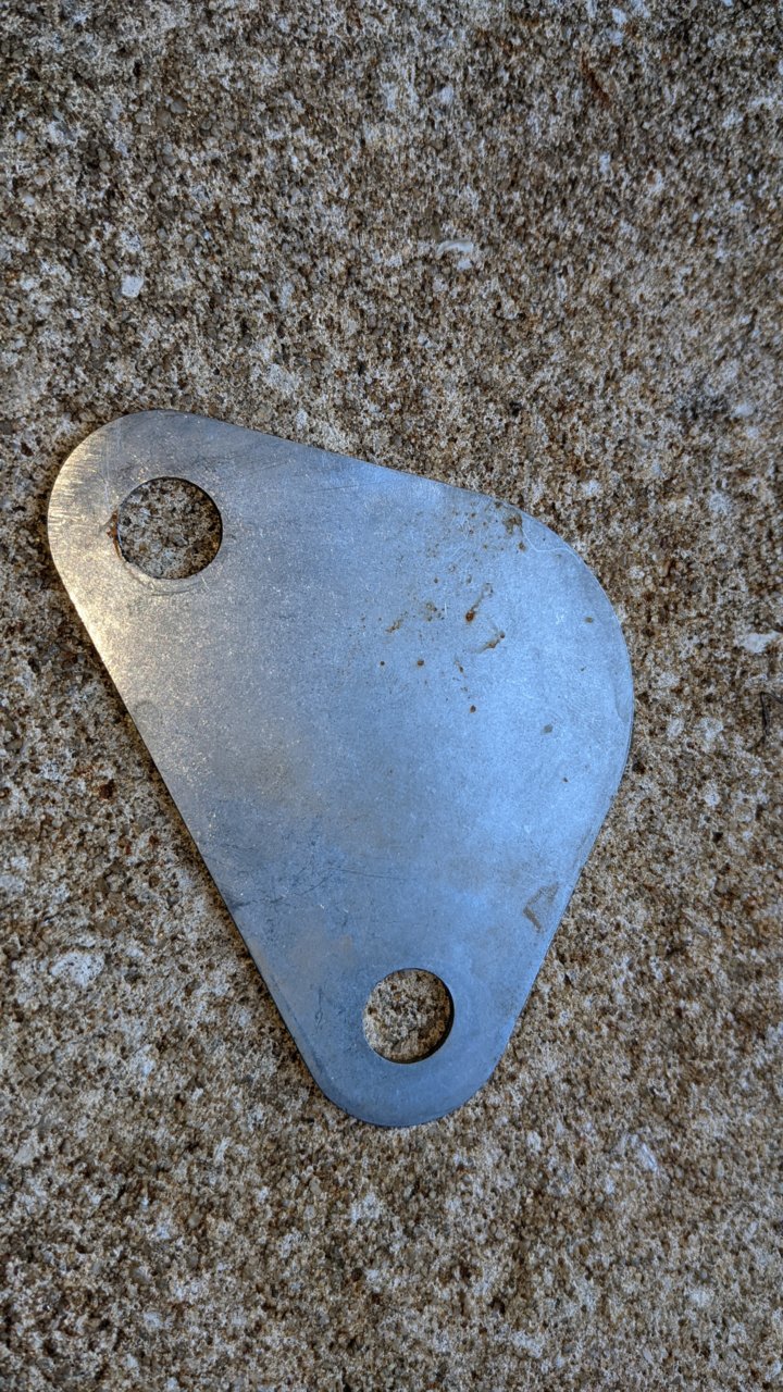

    Thank you for doing the in depth write up! Couple things. The cross tube shim is ONLY for when the hangers are moved forward to "stock" location, because the frame rails taper apart.
    Fitment can be complicated by aftermarket bumpers. Look how thick the frame plates are on that bumper, the bumper will definitely move the frame rails where the bumper is built to, especially after you remove the rivets, and the aftermarket rarely cares about accuracy as much as Archive Garage does and delivers in every kit.
    The Dakars with Hammer hangers in rearmost position will lift slightly because the Dakars are so short. If you were to move the Hh to foremost "stock" location (and use shim with X-tube), then you would drop down a bit.

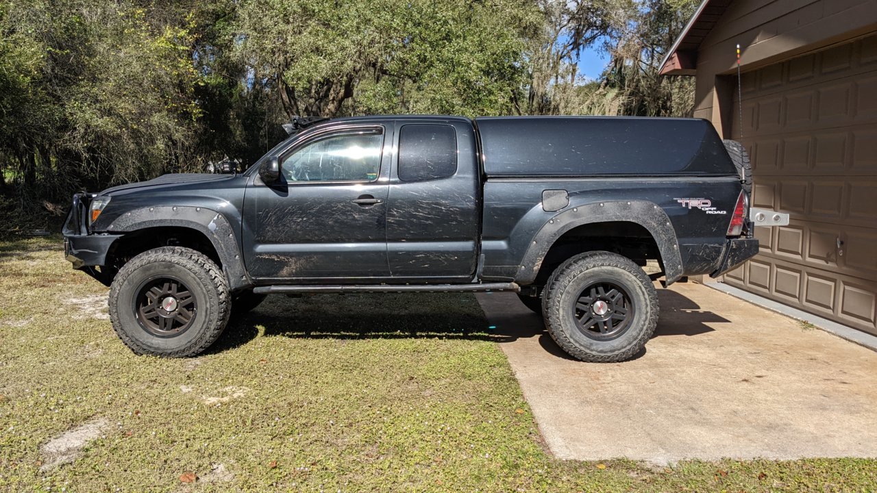

    Also, looks like your side shot was taken right after you pulled it out of the garage haha, for some reason some peeps measure right then, before they drive it.

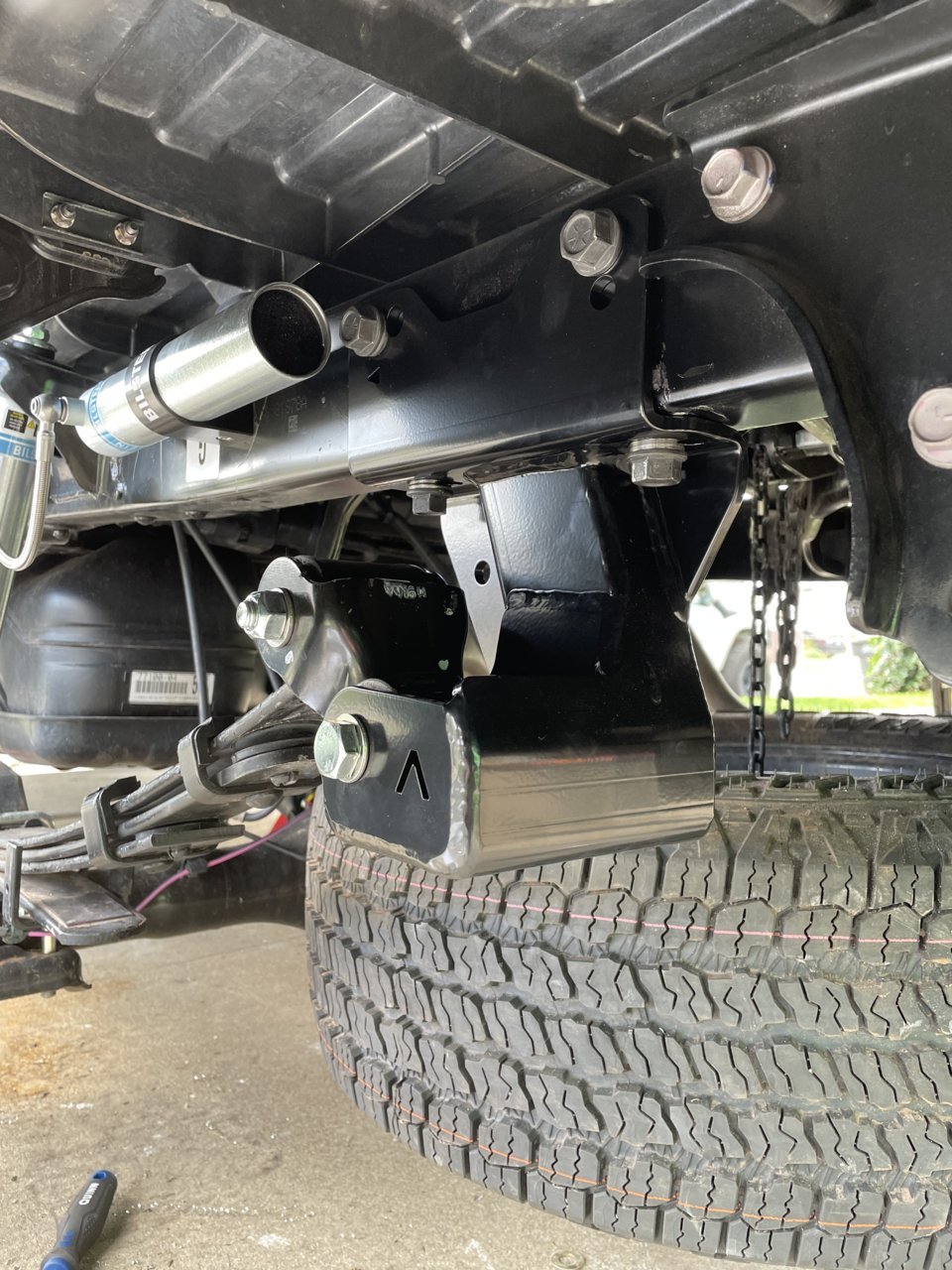

    Yeah, bumper is an All-Pro Off-Road (I know you have reservations about their springs in the very least!) so that may certainly be a factor in regards to fitment. The bumper reduced torsion of the rear some but the weight also made the it sway and roll more side to side when added. (Rectified by the Hammer Hangers and bar) The bumper fit pretty well, if anything it was slightly wider than the frame and pulled the frame out ever so slightly. While I do have some minor complaints about the bumper in general for what I paid for it (used) I'm happy.
    From what I have read All-Pro actually has an outside shop jig build them so the accuracy was there generally speaking for me at least.
    They're definitely thick frame plates, they pass through the bumper and become the recovery shackle mounts.
    I'll leave the hangers in the "rear" position as eventually I will probably go custom spec Deavers. I'm not entirely against a little rake and I'm sure it will settle some, the side picture was indeed taken immediately after install and before driving though after 120ish miles it's still riding high!
    My understanding is the fabbed shackles may also give me 1/4" drop ish?
    The fact that my "order of operations" was wrong on install (torqued the HH's first before fitting the cross bar) yet the cross bar still went in square with minimal convincing as well as how the HH's fit in position while still providing clearance for a rear plate bumper mount plates again highlight the consideration and precision of their design.
