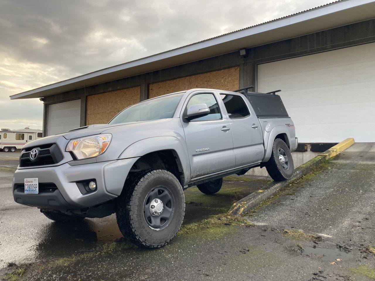

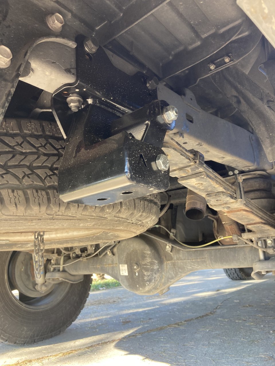

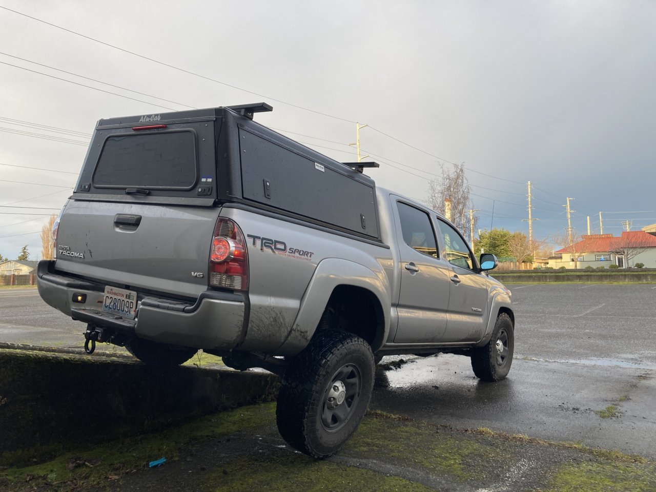

    7F2B0695-650E-4BE1-80C2-AC56495571C4.jpg 697EB3D4-4D2A-4CAB-A485-8294F10D9D19.jpg 9B97E506-1C0F-4DD2-81A7-A5E42236724F.jpg Got Hammer Hangers installed with archives shackle. Pretty stoked so far, less jitters in the rear and better overall ride, excited to see how they tow. Travel seems to be increased as well but I never took any detailed measurements. I got the icon 3 leaf AAL, overload out, 5100s all around, 265/75/16s.

    when you say less jitters....like there's a lot of uneven and pot-holed streets around denver. I get a lot more rear end shake than front end on those. These help with that?

    They will, but I think the typical jitters are the take off especially in reverse shudders the truck gets like the clutch or transmission is shaking.
    The Hammer Hangers definitely help to keep the rear more planted and stable though across rough terrain, even if that terrain is just pot holes.

    Because Hammer hangers are much more rigid than stock flexy hangers, the frame and bed don't bounce and jitter like happens with stock hangers. Hh make the rear ride quality better and more compliant, even handling gets sharper with less sway.
