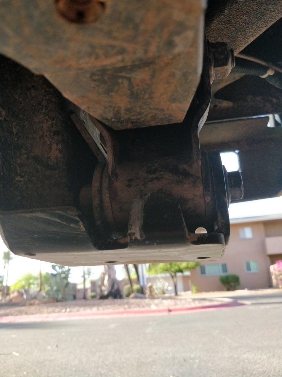

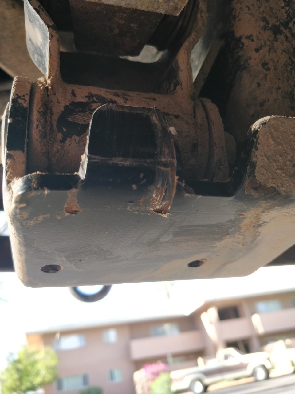

    Thank you for the pics. Looks to me like you trim that tab off and that will fix the issue. I believe the tab guided the leaf under.
    I have seen this happen with Dakars and the stock hanger on @alex.busta 's truck, had to cut the stock hanger to get the leaf unstuck.
    It looks to me that OME designed this pack for the Hilux first and just carried the design to the tacoma, I think that matters because the shackles are opposite, there would be no issues on the Hilux.

    the issue is with any spring and the stock or 3.6 shackle

    I'm not having issues but I don't have a shock relocation. The issue is with people running longer shaft shocks and the shackle hitting the hanger when its extending. If you dont plan on running a shock relocate just install it. If you do, trim your tab down.

    Not a shock relocate because @ETXTacoma doesn't have a relocate, just 12" travel shocks in the stock location.
    It's not the shackle hitting, it's the 2nd leaf on the Dakar pack, Dakar packs are built different than other Tacoma packs.

    Yea, I do not have shock relocate, all I have is 12" travel shocks in the stock location and Dakar springs with the stock shackle. Possibly going to a different shackle may fix the issue, just not sure?

    2) Please don't make a bigger deal than it needs to be over the hanger tab interference with leaf. The tab can be trimmed off to address issue.

    Sorry to hear that, that tab now feels like a drop in the bucket. I am going to trim mine down and call it good I think.

    Agreed its the tab. Im running 12" Kings with a BAMF relocate and All Pro Expos. Zero contact issues. Excellent product but from time to time these issues arise with DIY / aftermarket parts. Fabrication on top of already fabricated parts is necessary some / most of the time.

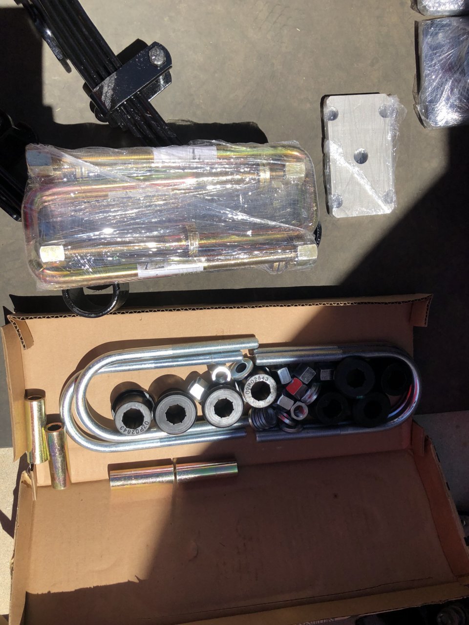

    Getting stuff together for this weekend. I have the older #2247 bushings from deaver so had you add a couple spacers. Came with 4 total. If i add #1 1/8” spacer on shackle/hanger spring eye where do the other two go?
  19. May 30, 2018 at 5:39 AM
    #339
    FishingInSand
    FishingInSand Well-Known Member
    Nov 28, 2016
    #203531
    1,094
    Corey
    Temecula
    06 now with 4x4
    Some stuff here and there
    On the forward hanger, other side of your leaf pack
  20. May 30, 2018 at 5:48 AM
    #340
    Slvr14tacoma
    Slvr14tacoma Well-Known Member
    Jun 25, 2017
    #222390
    627
    Mid travel
    Ok that’s what i was thinking but seems weird that ive been running them without issues from deaver. Just curious as to why “one per spring eye” if ive been running then from deaver with no issues. I thought they went at shackle/ hanger connection at first @ARCHIVE
