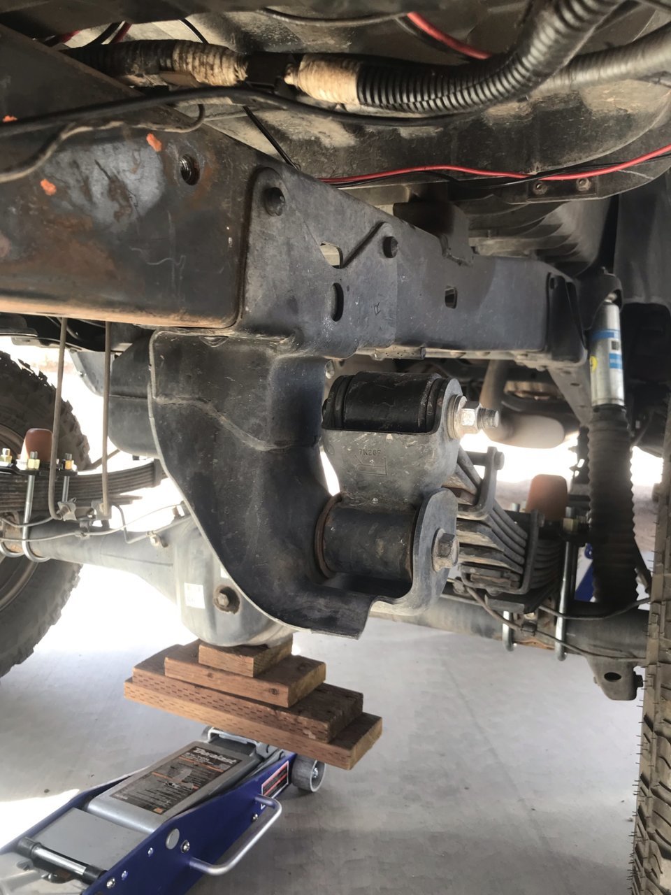

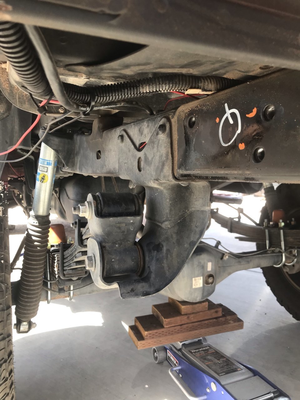

    Couple nuts and bolts 4x converted

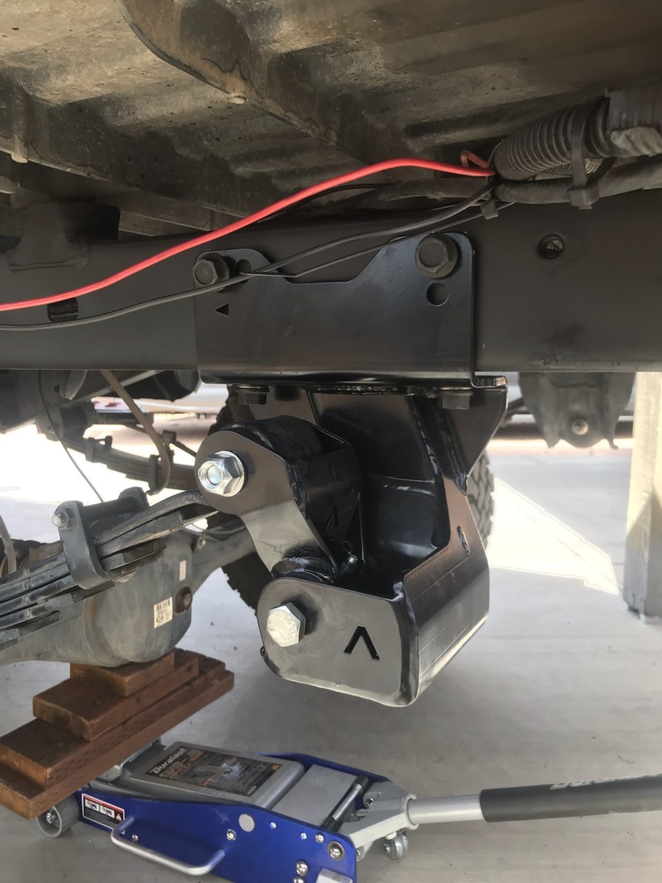

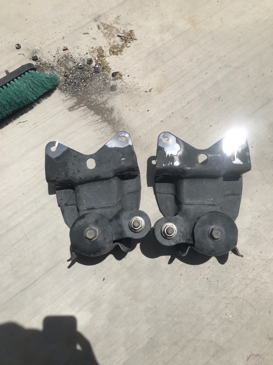

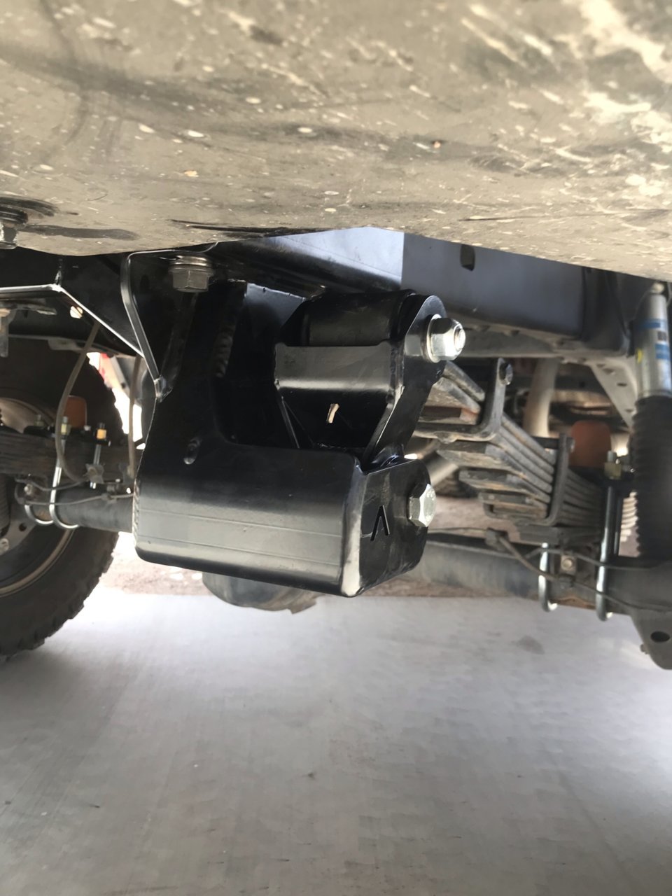

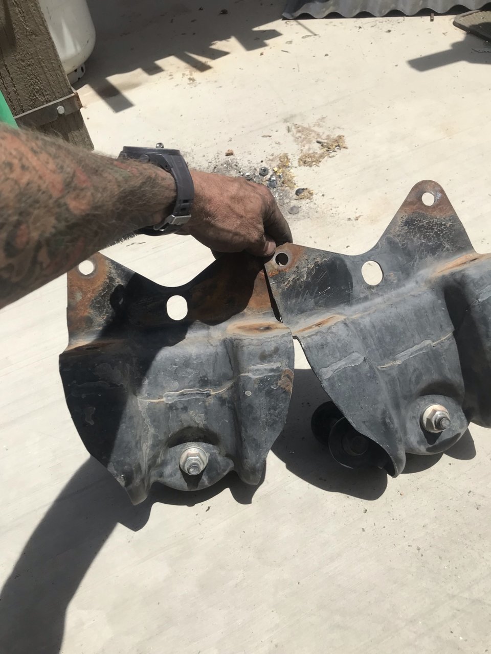

    FINALLY, Took the opportunity of the long weekend to knock out my Hammer install!! @ARCHIVE Garage You guys got that figured out really well! I had no trouble removing the old hangers.
    The instructions are pretty self explanatory. Little confusion about the forward and re hole positions. When I managed to get the first hanger off it made more sense.
    Managed to keep the old one is good shape if anyone wants them?
    I did find the trick to the front rivet on both sides is easier to remove with an air hammer and sharp chisel. Also helpful if you have cut side fenders from a HC bumper, allows a ton more work room for drilling the two side rivets out.
    DS stock hanger.jpg DS Hammer hanger.jpg PS stock hanger.jpg PS hammer hanger.jpg Hammer hanger pic.jpg old hangers.jpg old hangers2.jpg
