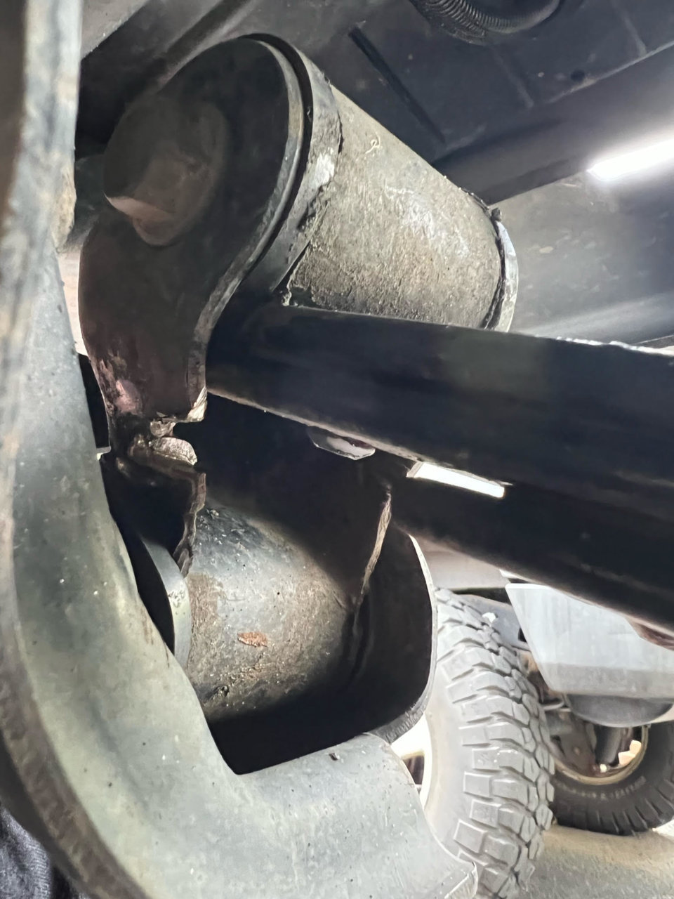

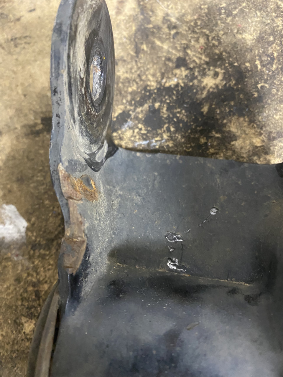

    If you're going to buy springs from Australia where they only speak "Hilux", then prepare to trim the packs for your Tacoma. They could fix their issue at any time, but they seem to like making a product that doesn't function properly.
    Here's a pic of the the new 3rd iteration of Dakars, they got worse AGAIN. This one hadn't even been on the road yet.
    and this

    There was no mention of Hilux. They are described as leaf springs for Tacoma 2005-2022. I'll see how they do. I could provide some input once I get the HH

    No, the Australians only comprehend Hilux shackle arrangement, so that's the problem when they're selling springs for a Tacoma.

    I wish I would've known of this issue... They are on their way so there is no turning back now. I'll report back.

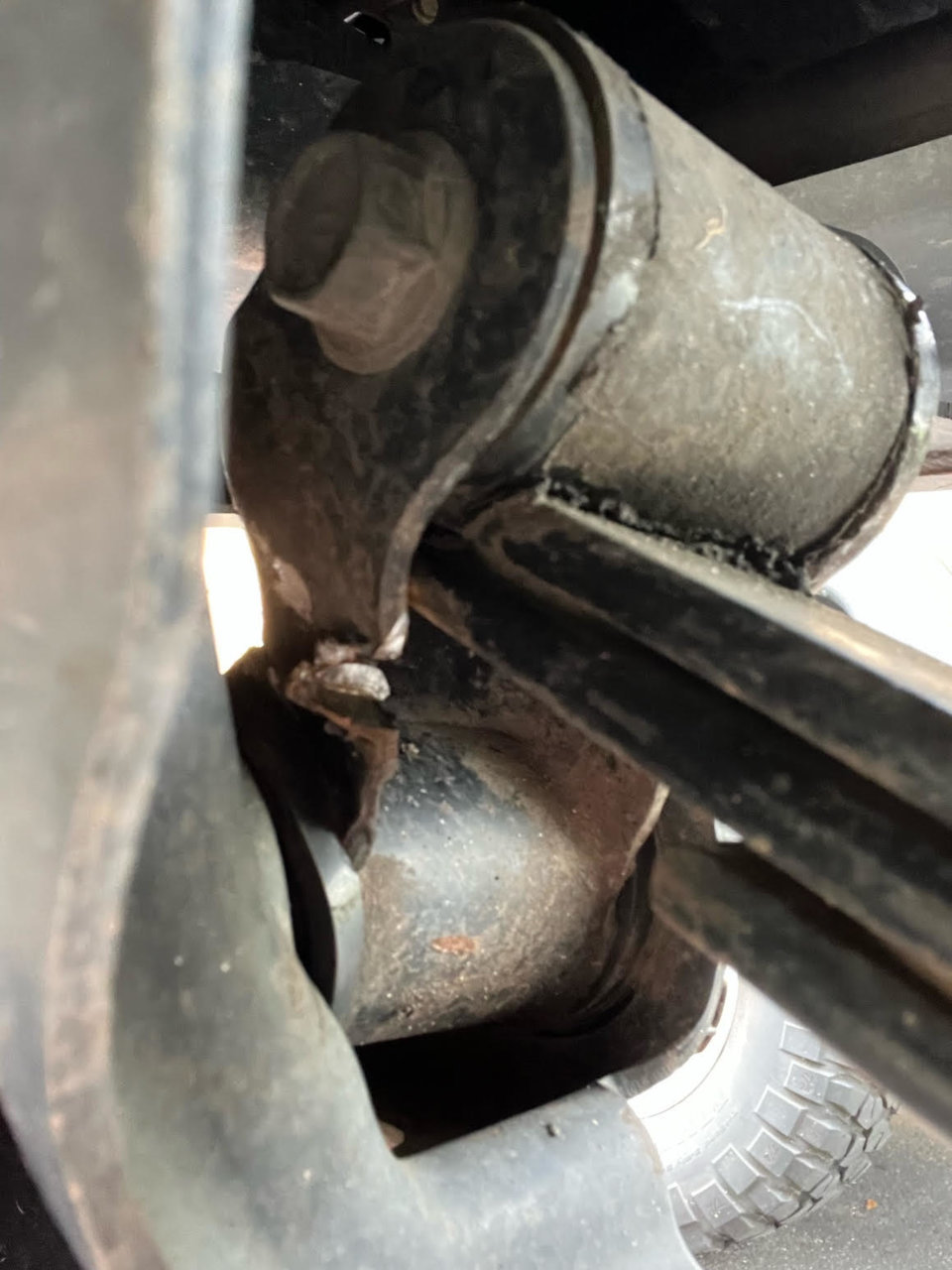

    Happens with STOCK hangers , here's 2 customers with stock hangers and Dobinsons 112s BEFORE they switched to HH.
    This one is from @BamaTaco56
  9. Jul 22, 2022 at 11:19 AM

    I'm confused, so this won't happen if I get HH shackles?

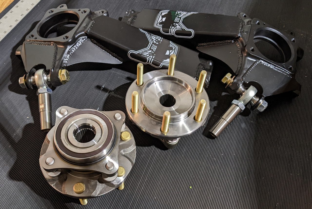

    Locker anytime Fog Lights anytime Full LED light conversion TRD cat back Rear cat delete Exaust Y reroute away from actuator Alloy Clutch master 2000 4Runner "Dog Leg" shift leaver Marlin shift seats and bushing Rear seat delete Rear diff breather extension Chrome grille swap Debadge Rear seat delete Honda blower motor beefy plug and wire mod Anytime 12v and USB with volt gauge in bed Blue Sea fuse box Hella AND 70's Caddy horns Low profile recessed hex drain plug swaps Alluminum battery strap 7pin relocated Backup cam on anytime Various other creature comfort and personal taste mods.
    Yikes! That's bad.
    My were only *chef's kiss* to the shackles before HH+3.6"fab shacks.
    Been holding up great by the way, started eating tires as it's just so much fun on and hopefully very soon again off road!
    My trucks so heavy but the HH and cross tube made it feel tossable again, especially with my new solid engine and trans mounts it just feels performance but I need to get my gusseted spindles and wheel bearings which is today's project done before I can go play hard in the dirt again.

    It will happen with ANY hanger you run, BECAUSE the issue is with the SPRING DESIGN
    This is not aimed at you, but at the community at large
    THERE'S ONLY 1 WAY TO FIX THE SPRING ISSUE......IT'S TO FIX THE SPRING ISSUE
