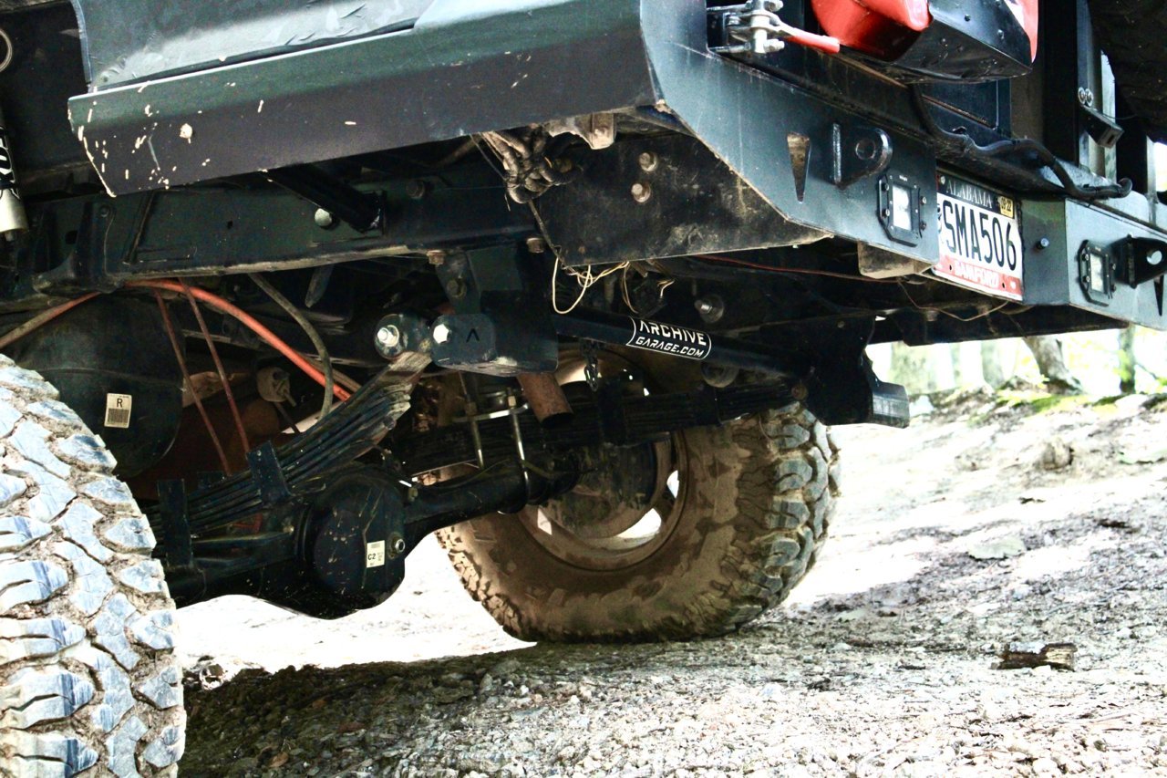

    Forgot to post these sweet shots of archive products in here!
