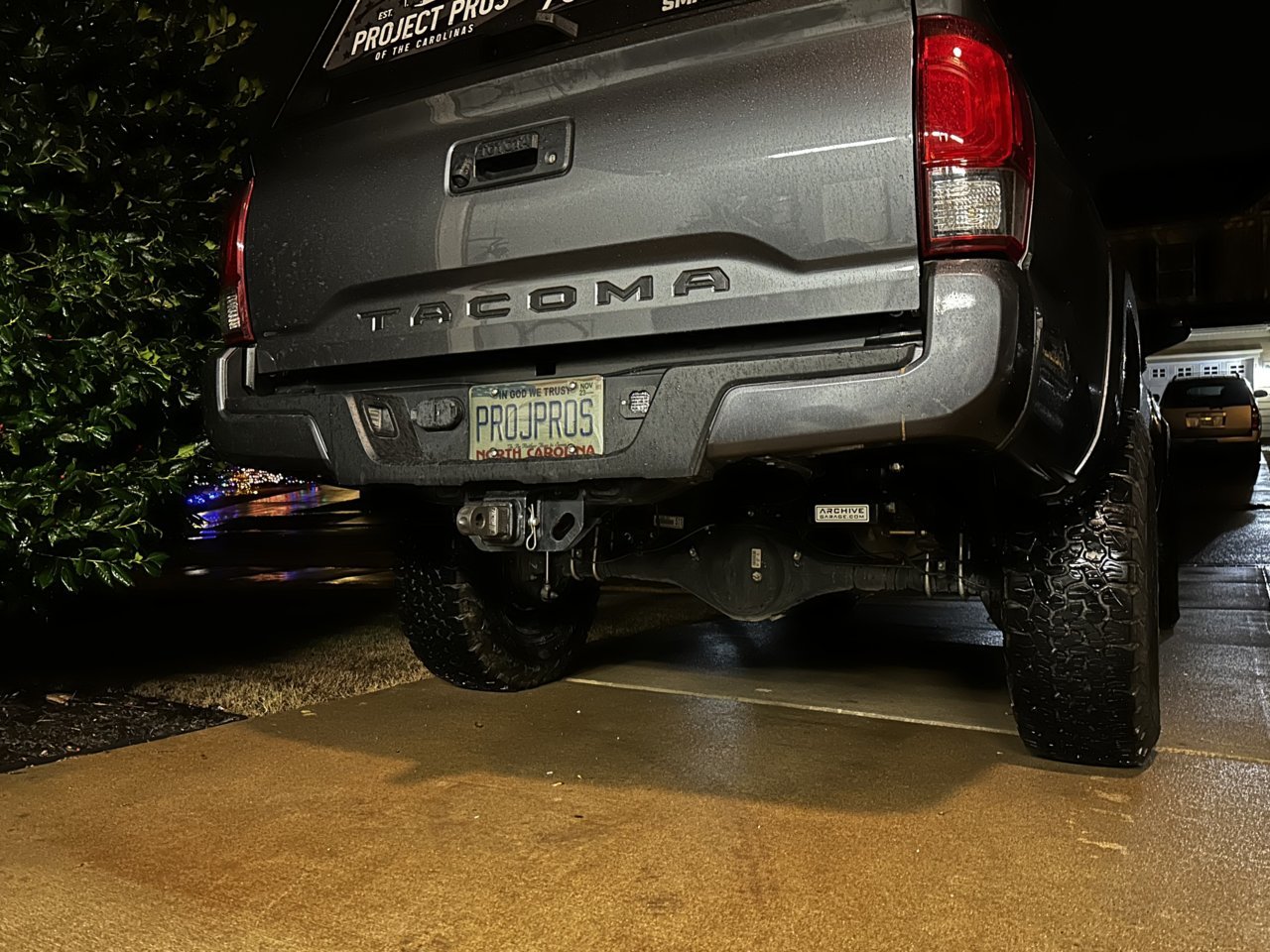

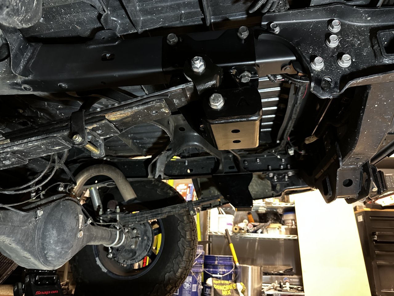

    Got mine installed today, took me about 2hrs to do the install but had to wait 3hrs for the ups driver to finally show after I removed the factory hangers for my steel-it delivery.
    I knew they were going to do something, but holy crap…I wasn't expecting the rear to feel like a completely different truck! 8F5910B2-3D7D-4762-953E-62B6374DED94.jpgADD080E4-C5AE-4688-86CB-5F8DFE817B2B.jpg
    drizzoh, a2lowvw, LOLLY and 7 others like this.
