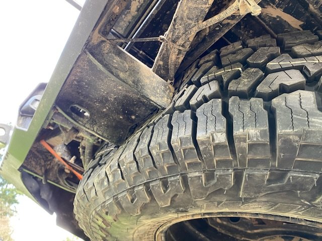

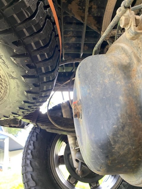

    I never dropped my stock hangers on a rock, yet they still bent from rough dirt road driving in Baja with a heavy load — a wedge camper with a full interior build, in my case, which puts me right at GVWR for the rear axle. I’m the second person I know this has happened to without rock contact to the hangers.

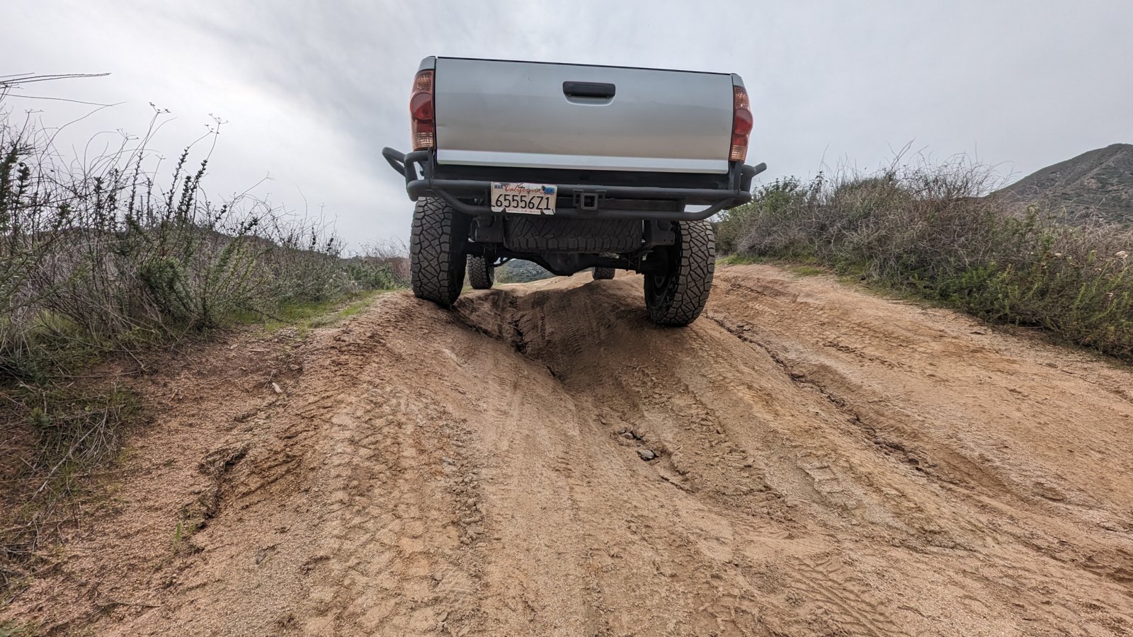

    PXL_20240225_200503290.MP.jpg I got a 34" in between hangars. Minor modifications to fit, maybe 5 minutes with an angle grinder. I also use my bed for work daily and don't want my full size spare stolen out my truck which is way too easy to do locks or not lol.

    What rear bumper is that and what springs are you running?
    My Deavers moved my axle back an inch, and my rear BAMF bumper takes up more real estate under the bed, necessitating that I deflate and ratchet-strap my 33” spare in place so it doesn’t drag the differential during suspension compression.

    It's the warfab hc bumper, and dobinsons +2" springs. I swear these dobinsons are ridiculous, they are not my limit my 12" shocks are lol. I only went this way based off Eric's recommendation and it has been sweet. But now I need to get something longer lol
