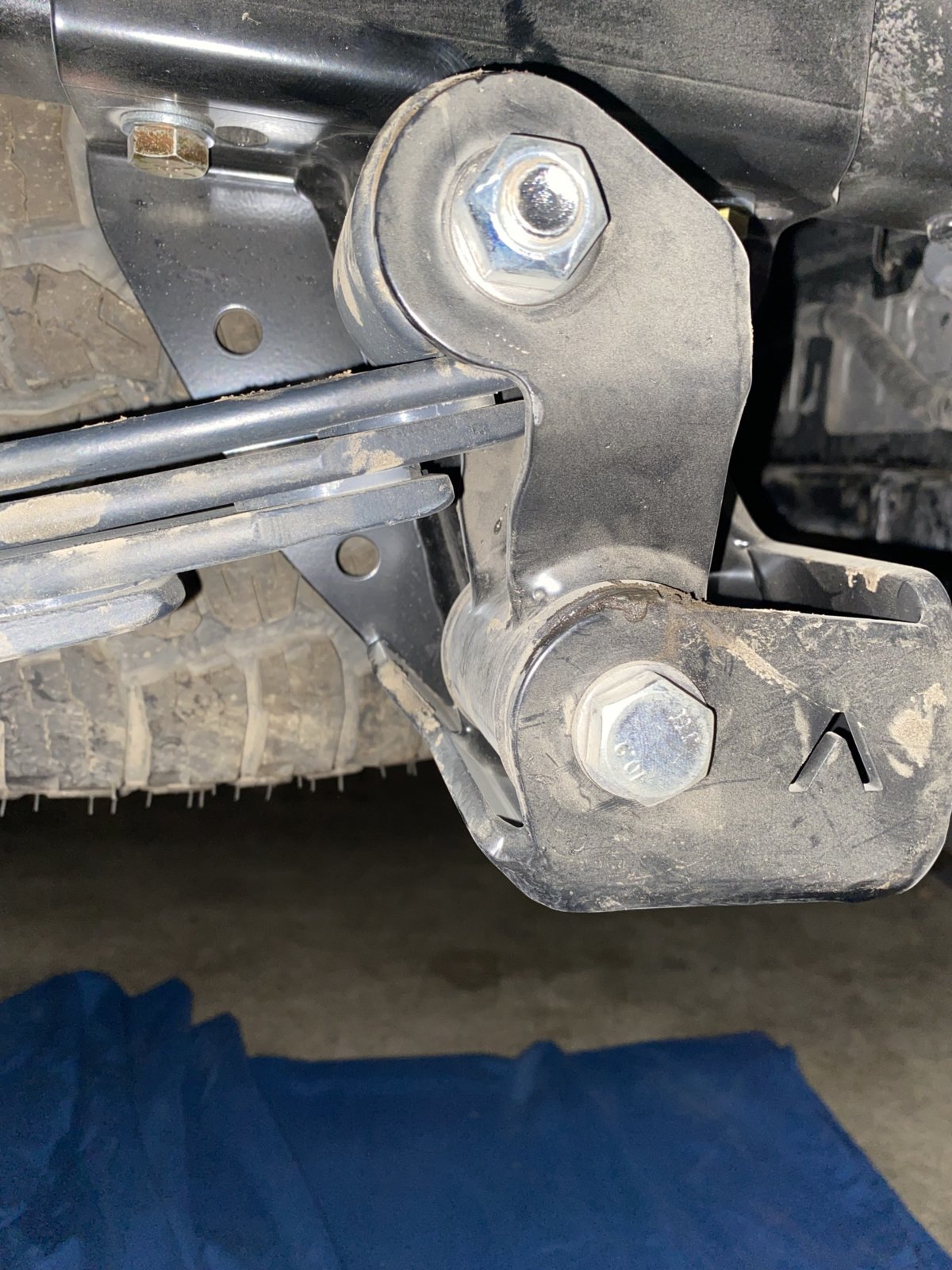

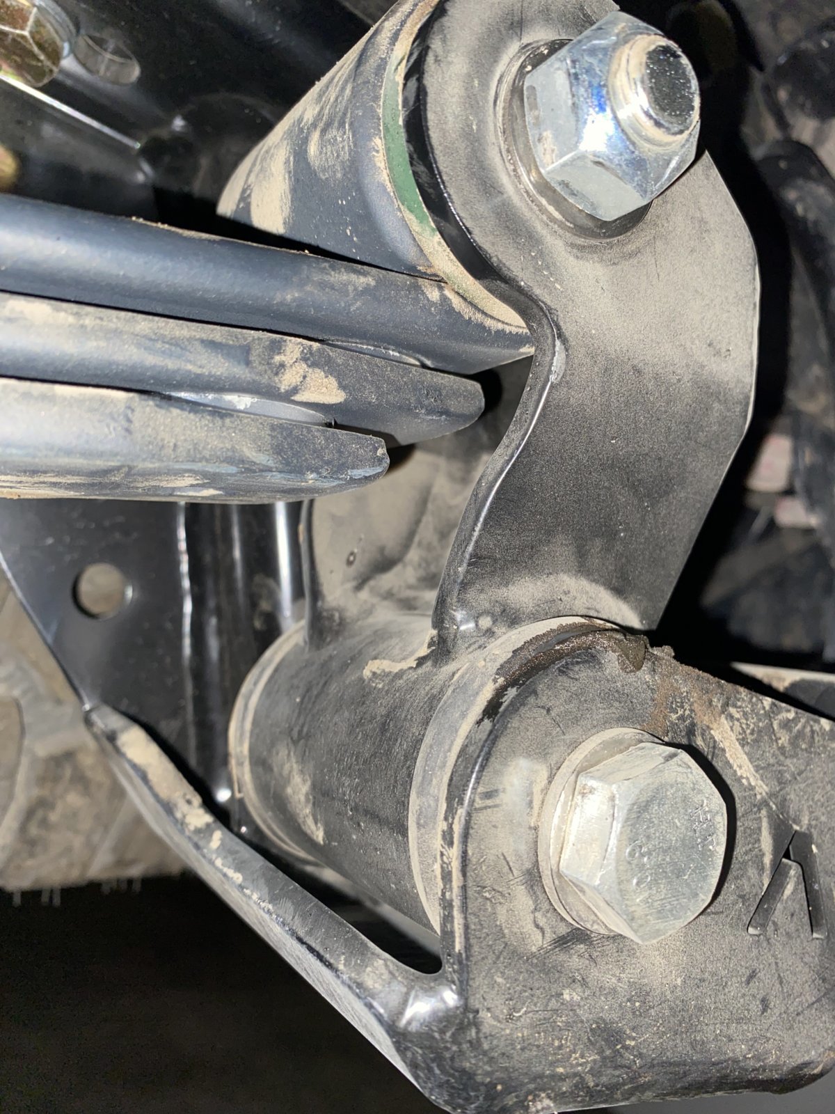

    I’ve been off-line enjoying my new set up and just saw your post.
    I ended up deciding to not cut any of my new IronMan leafs.
    I had been running IronMan’s regular leaf springs in my OEM shackles for the last three years with no problems/wear/damage (and they extended about the same amount into the shackle). When I spoke with IronMan about this issue it was the first they had heard of it; they did say cutting out a small portion of the second leaf wouldn’t affect performance, but I never asked about their warranty.
    I also did a lot of internet research and other than the mention of the issue in this thread (that don’t include IronMan leafs) I couldn’t find anything about this problem and IronMan products. That doesn’t mean it hasn’t happened, but given the internet’s proclivity to act as a megaphone for people with grievances it does give me a level of comfort that it isn’t an on-going problem.
    I’ve attached pictures of my new heavy duty IronMan leaf springs installed in my new Hammer Hangers (after about 600 miles of pavement and dirt). The angles of the pictures can be a bit deceptive, but if you wanted to cut the second leaf you’d probably be looking and removing somewhere between a ¼ to ½ inch of material.
    As for weight, the I installed a FWC Swift that weighs 1,151 lbs wet. I couldn't be happier with the heavy duty springs and the HH combination.

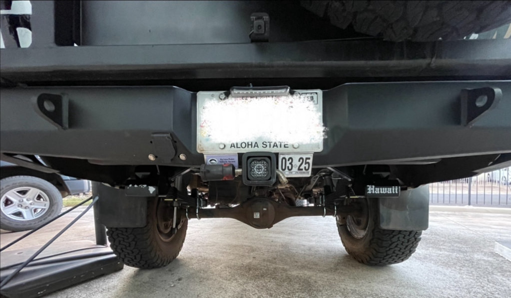

    friend just installed my hammer hangers for me. liking the way it can be seen from behind.

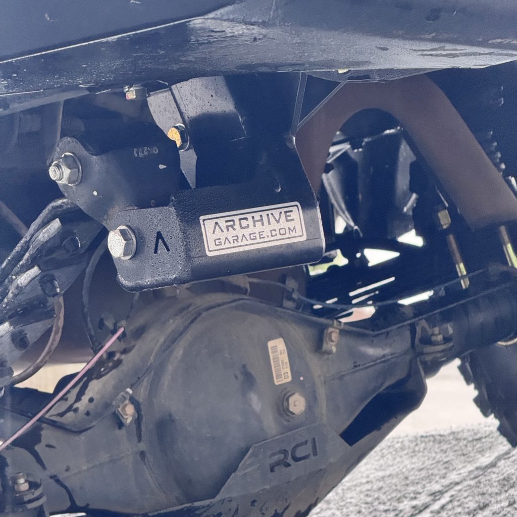

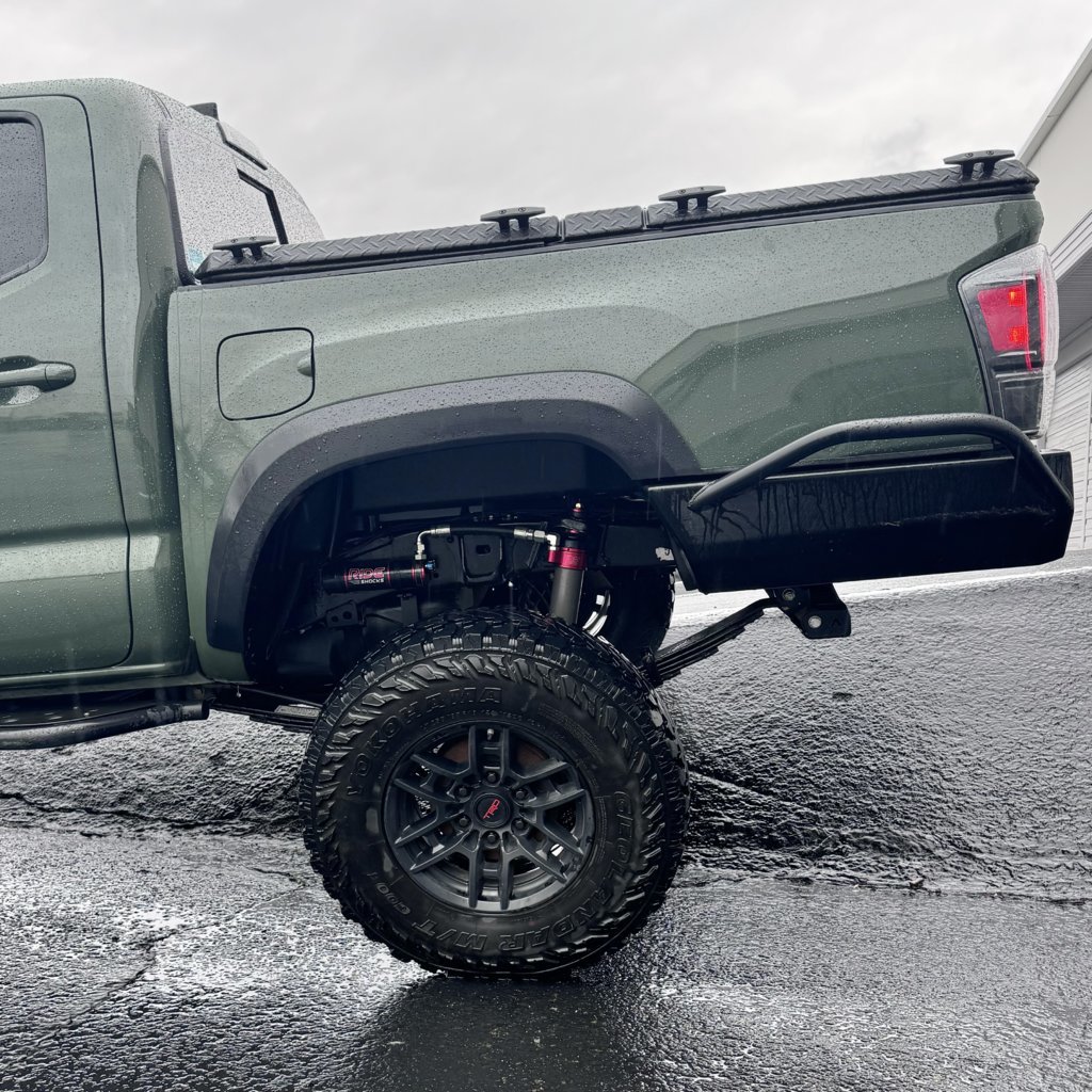

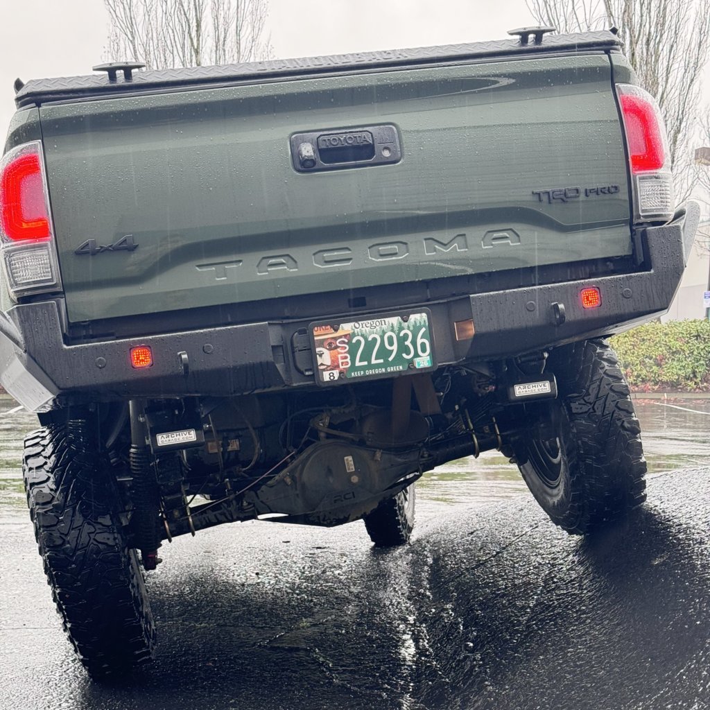

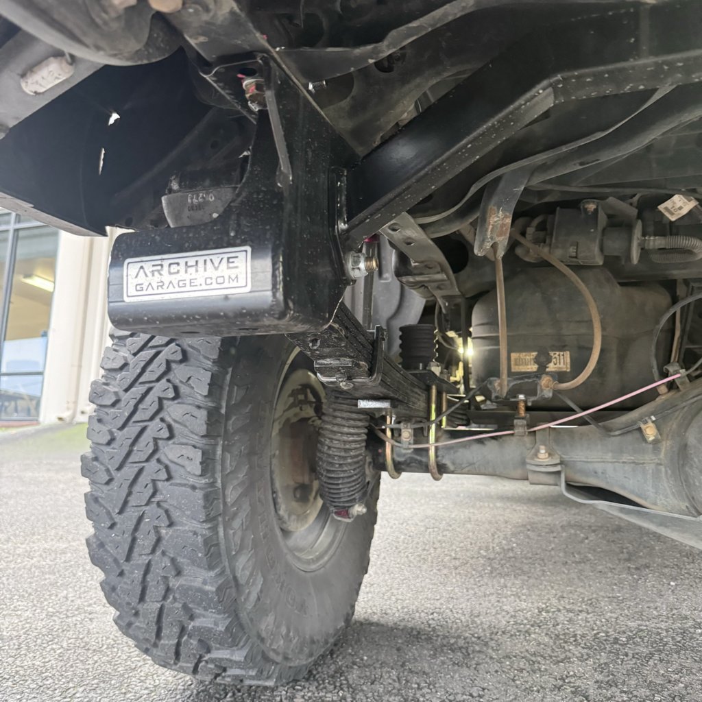

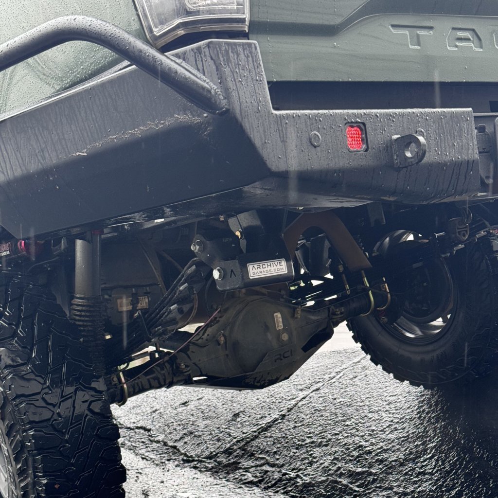

    After 350 miles on the recently installed Archive Garage HD leaf pack, I had a shop install the Hammer Hangers + Cross Tube, while keeping the stock shackles. I waited on installing the hammer hangers so that I could get a feel for the incremental increase in ride quality, and it was sure noticeable!
    The strange feedback and bounciness I felt with the stock hangers got worse when putting on the HD leaf pack. The rear end of this truck rides great now and I wish I had installed Hammer Hangers years ago.

    who makes that rear bumper?

    Looks like you need some longer brake lines

    Bay Area Metal Fab
    From what I’ve observed it is fine. I added a 1” spacer under the brake line bracket where it attaches to the axle. I’ve taken this setup off-road and fully flexed out the rear with the driver side rear tire off the ground and there was still sufficient slack in the brake lines.

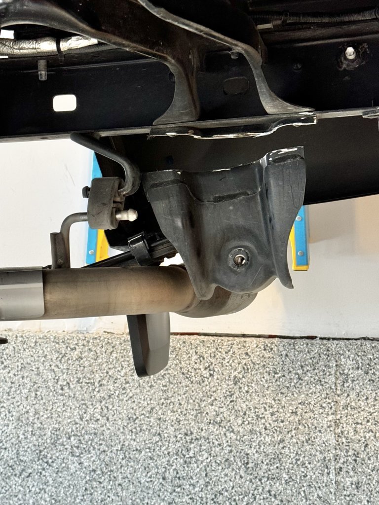

    Just fyi, this technique worked. Albeit, loud asf and my neighbors probs hate me but it was effective.
    Flat chisel on the air hammer knocked the rivet heads off the hanger side. Gave a the hanger a few good wacks and it came off; leaving the shank of the rivet exposed. Ground those down with a flap disc, then attacked the rivet head from the frame side with the flat chisel until they popped loose.
    These things are badass! Swapped my OME Dakars for Eriksok HDs and couldn’t be happier!
