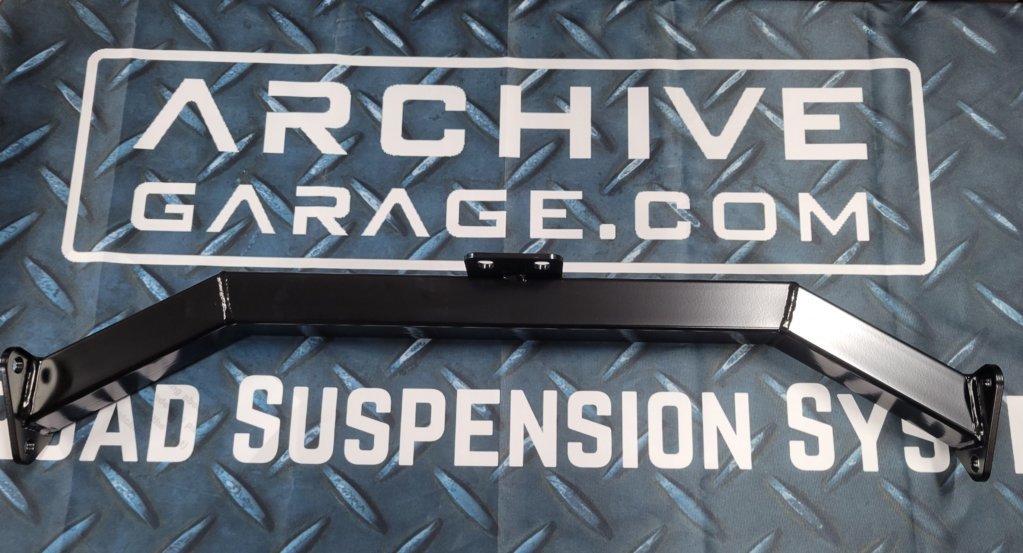

    dumontrider likes this.

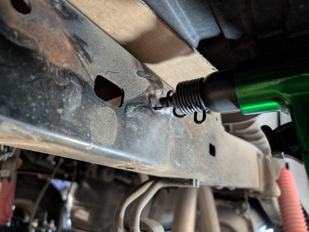

    I finally installed my hammer hangers. It was more of a pain than I expected. "Buy an air hammer", they said, "it will be easy", they said.
    That is a photo of the air hammer bit stuck in the frame.
    It turns out the air hammer only helps a little. The rivets are so mushroomed that they can't really be hammered out when they are through more than one layer of metal. For the horizontal rivets I was able to pop some of them out after removing the stock hanger and grinding the remainder of the rivet flush to the frame. At least one of them still had to be drilled. For the vertical rivets the air hammer was only helpful to free the stock hanger from the rivet. I still had to drill the rivet to get it out of the frame+cross member+welded washer. Luckily I could use my floor jack to put pressure on the drill.
    It probably doesn't help that I bought the cheapest air hammer on Amazon. Many people have suggested an air hammer, but those suggestions are usually along the lot of "if you have an air hammer it will make quick work of this, but I don't have one so I'll drill out the rivets." I suspect few people have actually tried it since it's not a super common tool.
    After literally hammering on the stock hanger, I am still not convinced that the extra stiffness of the hammer hangers is significant. I do think the high clearance crossbar will help when I eventually get around to relocating the spare tire. And Archive has a nice system of parts that are all designed/tested to work together, so that makes it worth it.
