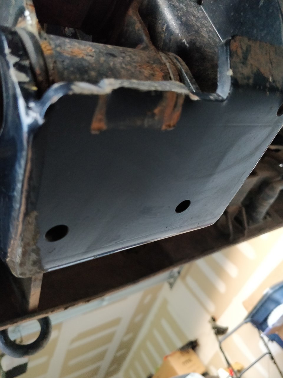

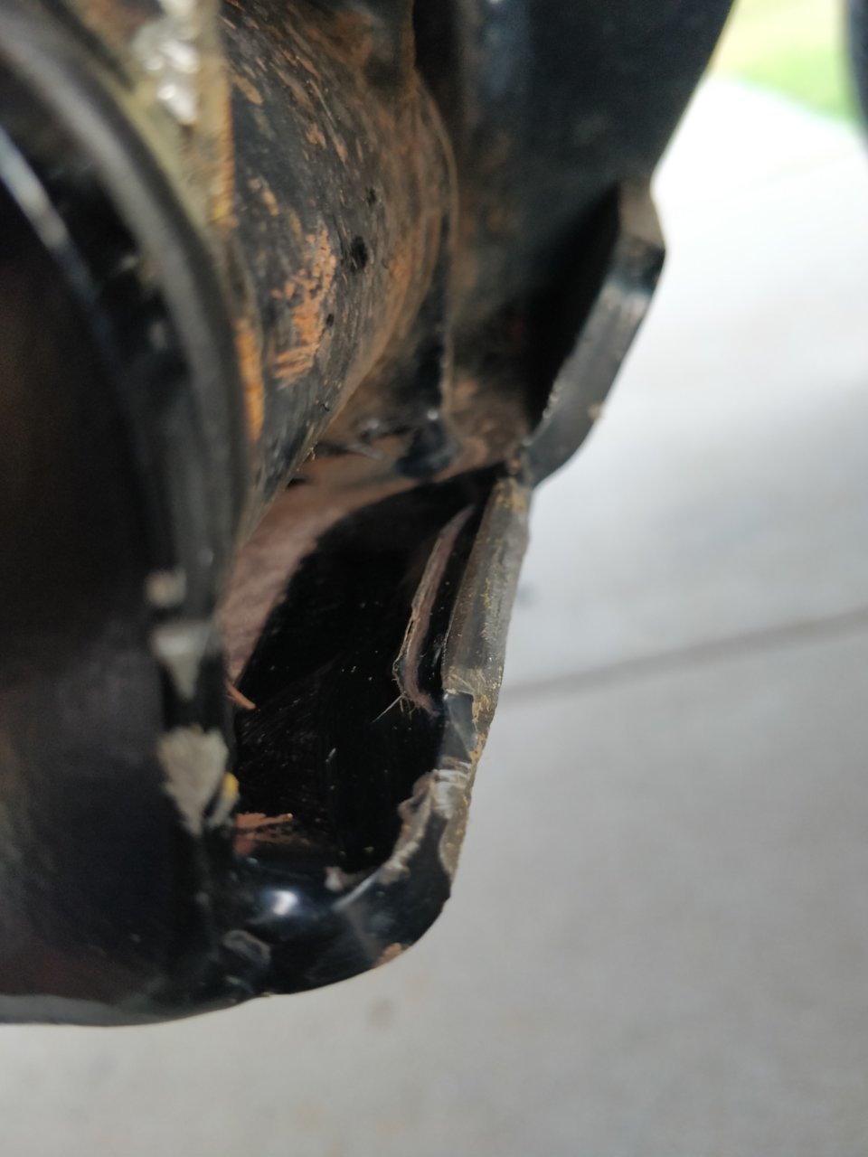

    If you have the older style with the tab and you run a Dakar leaf pack make sure you cut that tab off before your next trip. I just cut the tabs of mine and found that both sides had bent back and cracked the powder coat.
    I'm not kind to my truck but I'm surprised that the leaf could put enough pressure on the the tab to bend back 3/8" steel enough to crack the coating.

    Thank you for posting, sorry for the issue Shay

    I have a grinder with cutting discs waiting to be used to cut these... just need to get it done!

    I did it with the tires still on, was a bit awkward but did the trick
