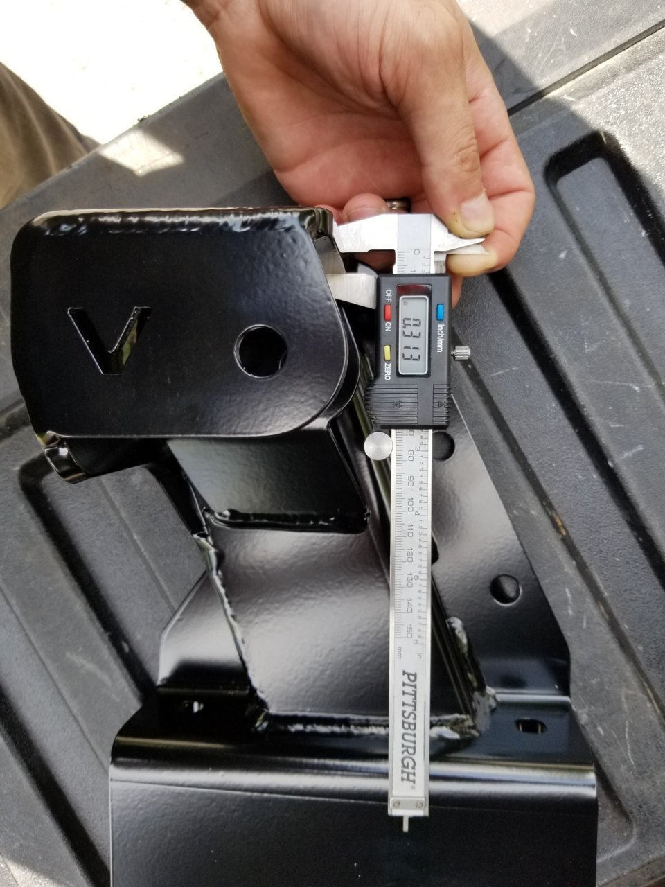

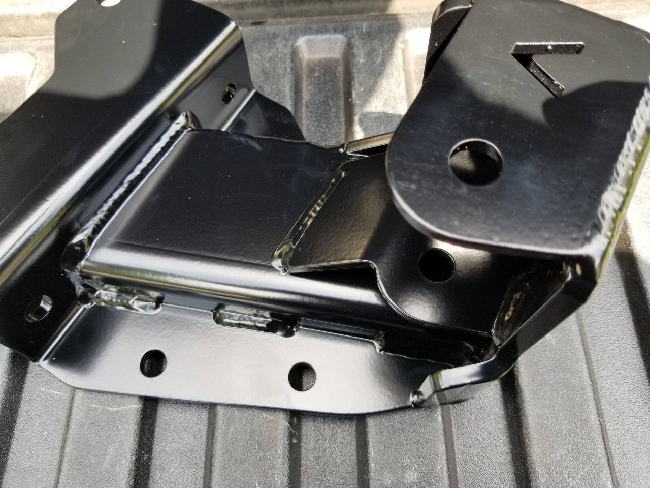

    Another update to this batch currently shipping is an increase in thickness of the bottom angle plate to .3125" from .25", and still made out of higher strength 50,000 psi steel (normal A36 structural steel is only 36,000psi)
    This update is for max resistance to bending, about 25% increase, and max improvement in ride quality. No one has bent one, just something I wanted to do, Archive is committed to continual improvement.
    Edit 8/22/18: I've found a way to go back to 1/4" on future batches while having about the same strength as heavier 5/16", by adding a stiffening bend to the leading edge

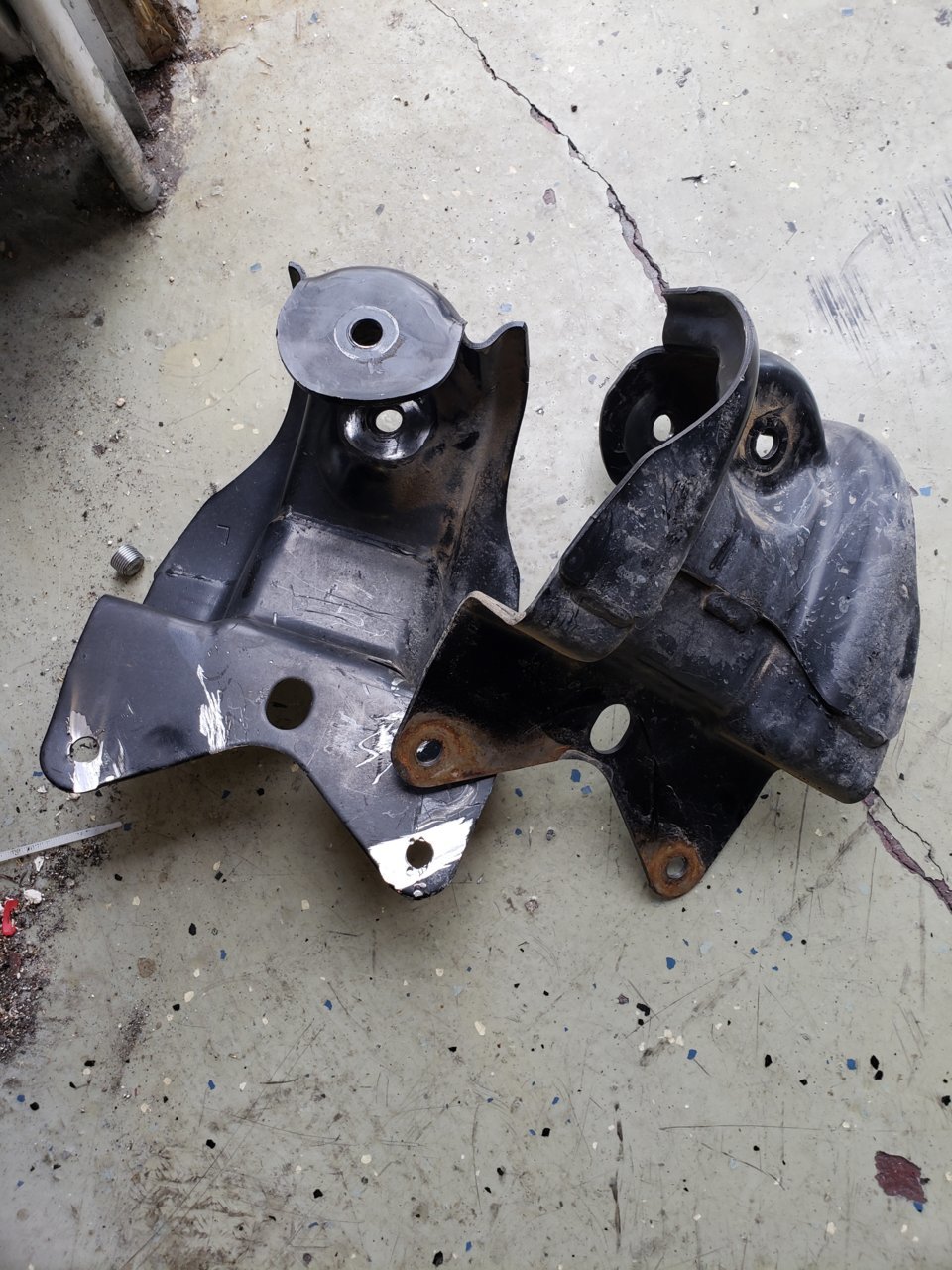

    I got my hammer hangers installed yesterday at my buddies fab shop. He used an angle grinder to cut off the rivets and an HD air hammer to bang em out. The whole install took a few hours for him.
    I havent taken the truck offroad yet after the HH install but just from driving on the street I can immediately tell the improvement in ride quality. Its the real deal guys! I run my springs SOA with stock shackles with OME Dakar ELO96R HD leaf pack and gained about 3/4 inch lift with a constant 400lbs load. I highly recommend these hangers from Archive Garage.

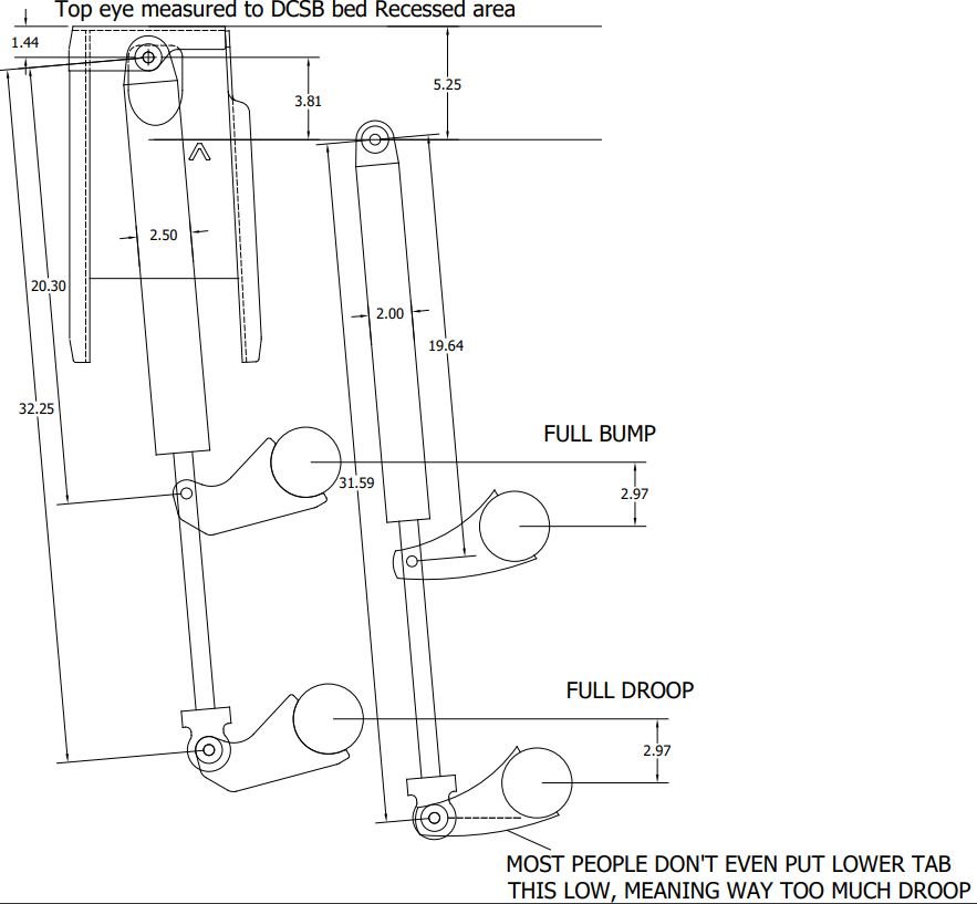

    Just an FYI if you’re running Deaver leafs, maybe opt for different length shackles as the stocks don’t seemed work well. Truck was put on a lift for tire rotation and was lowered down and the shackles were stuck rotated down. Easy fix but shouldn’t be happening. The dealership was able to drive it like this which leads me to believe it was pretty locked up.

    I recommend putting limit straps on it then. Or maybe you could put a plastic block were the shackle contacts the hanger to keep it from rotating down that far. The Deavers are long and the main leaf is being pinched between the hangers.
    Do you have the standard U402 expo? Or something else.
    EDIT:
    The real reason for this issue has nothing to do with Hammer hangers, they do their job to increase droop over stock hangers.
    You are getting excessive droop because of your shock relocation, either its DESIGN OR THE INSTALL are allowing excessive droop.
    That brand relocation puts the top shock eye ~3.8" lower than the Archive relocation does, but the King 2.0x12 is only 1" shorter collapsed than a 2.5x12.
    That means you are either bottoming out your shocks or you have spaced your bump stops by several inches.
    (I have a right to explain why something is happening, especially when my products have been accused of causing an issue. This is not an attack, merely a factual explanation.)
