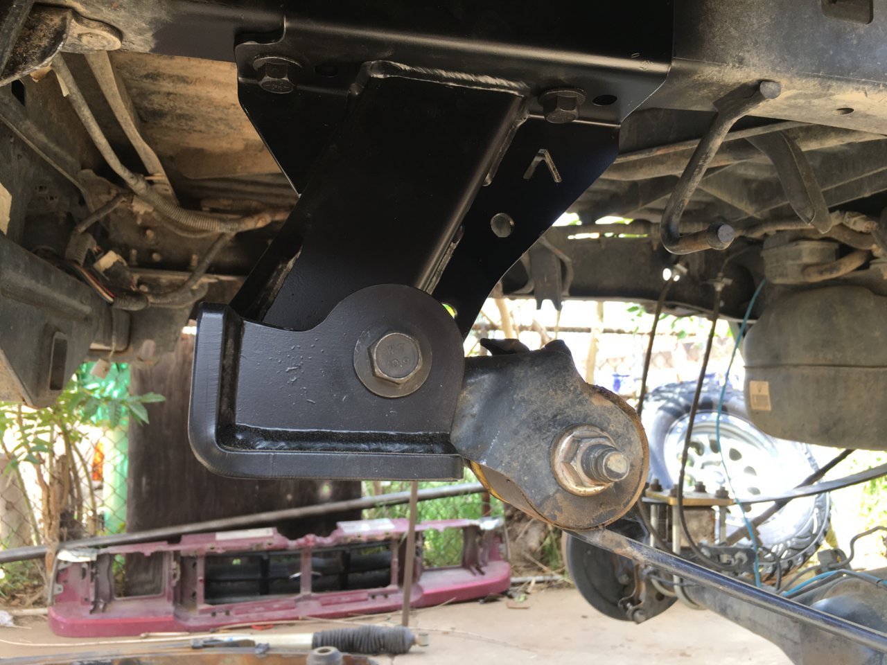

    I still haven’t run the truck with the leafs assembled to know if this will be an issue. I noticed the bind with a stripped pack. The only sure solution I can think of is to limit how far below horizontal that the shackle is capable of moving.
    You have already compensated for longer leaf packs with the mounting position. I’d also be curious if this is an issue with longer shackles.
    My stock shackle at full droop.

    I think a longer shackle like the 4.5" option would prevent the shackle from getting to horizontal for long leaf packs, but may limit gains in droop.
    For Dakars, it would probably still lock only worse because the main leaf would be bent into more of an arch.
    So best way is probably to come up with a way to limit the shackle from getting past horizontal.

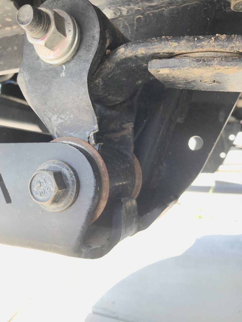

    I’d be fine with losing an inch of down travel if it meant not damaging my hangers and shackles.

    Ehh that tab looks like it's been bent upwards. The tab on both of my hangers are at a 45-55 degree angle. Yours is straight up towards the sky. I don't know if that's one of the earliest versions (the pictures in the first post suggest they are not) but that could be why you're binding at droop.

    It is, only on one side from either the shackle pushing it up or the leaf contacting it. The other side is at a proper angle.

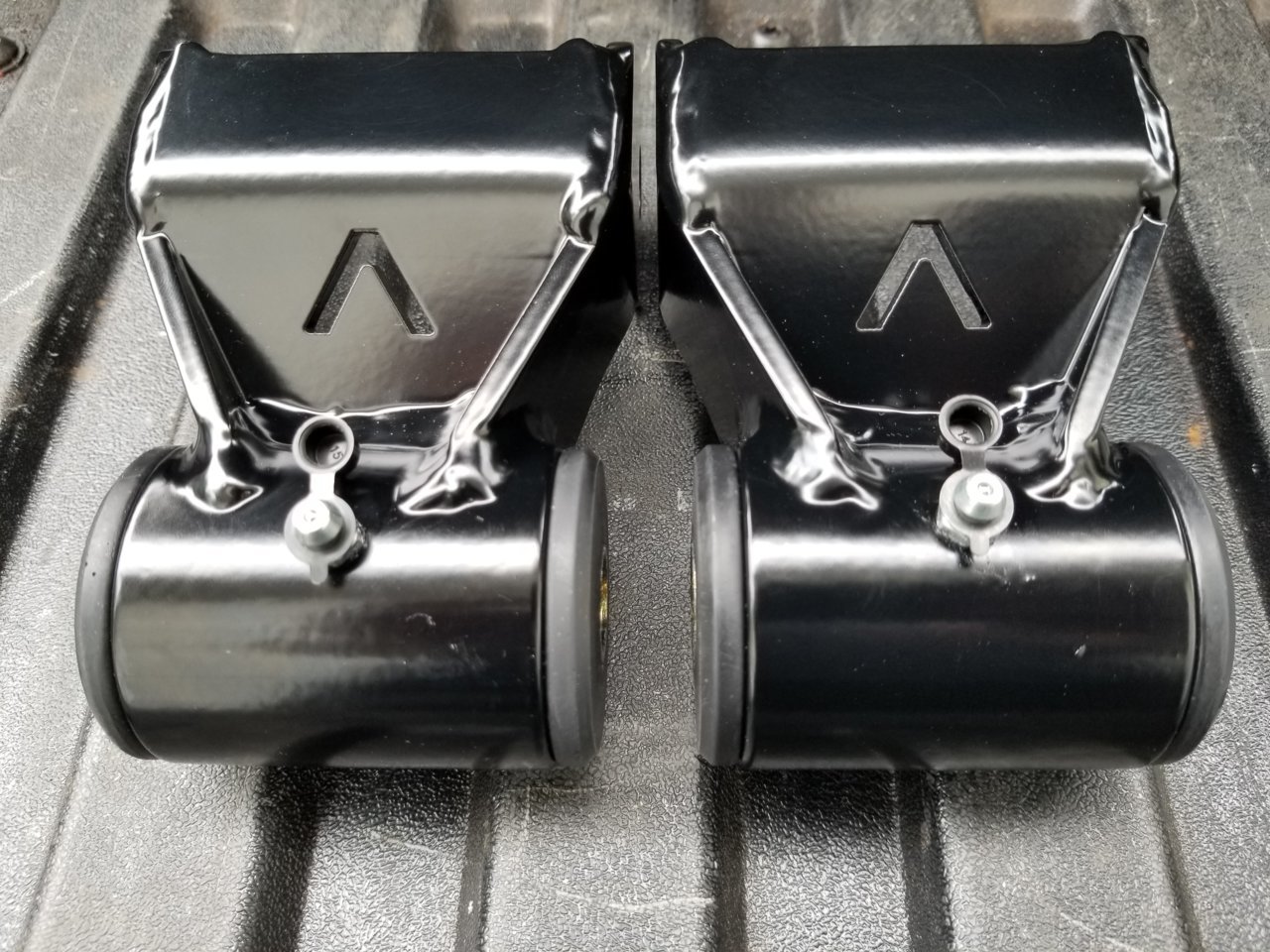

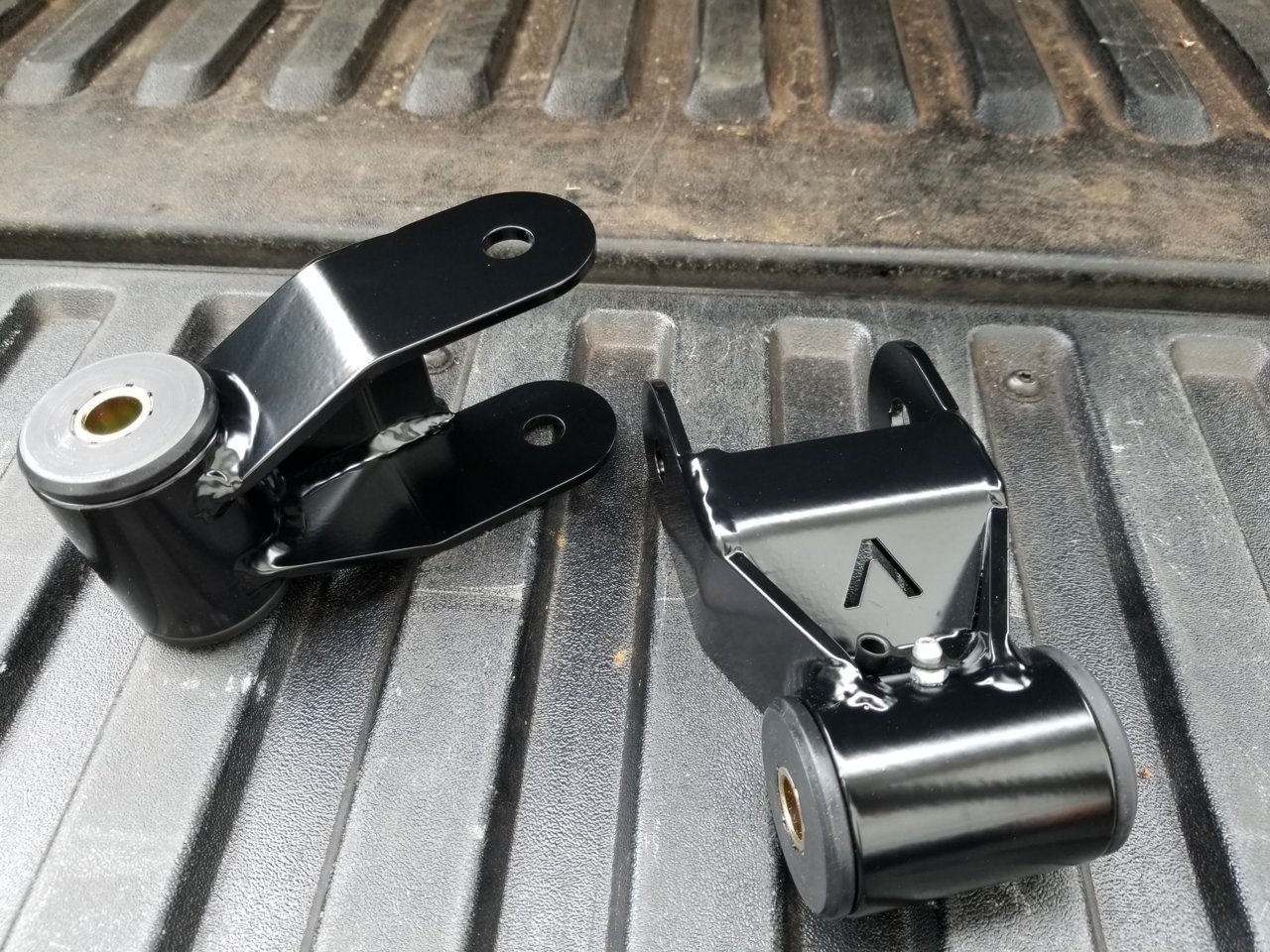

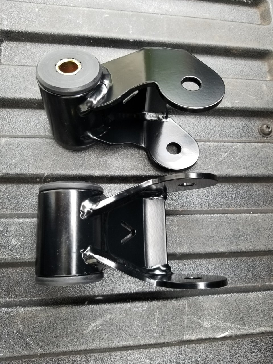

    Pics of updated 4.5" shackles

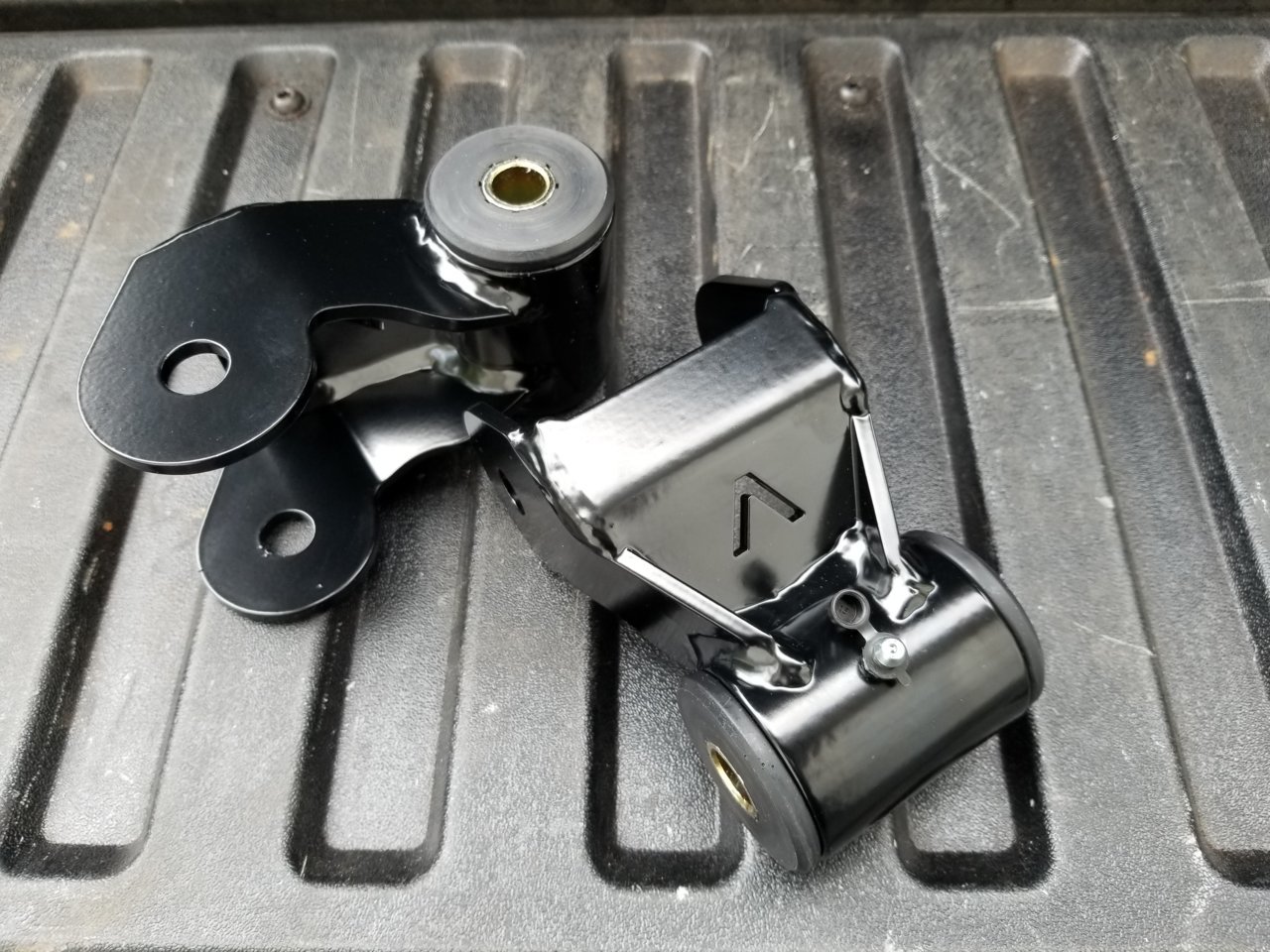

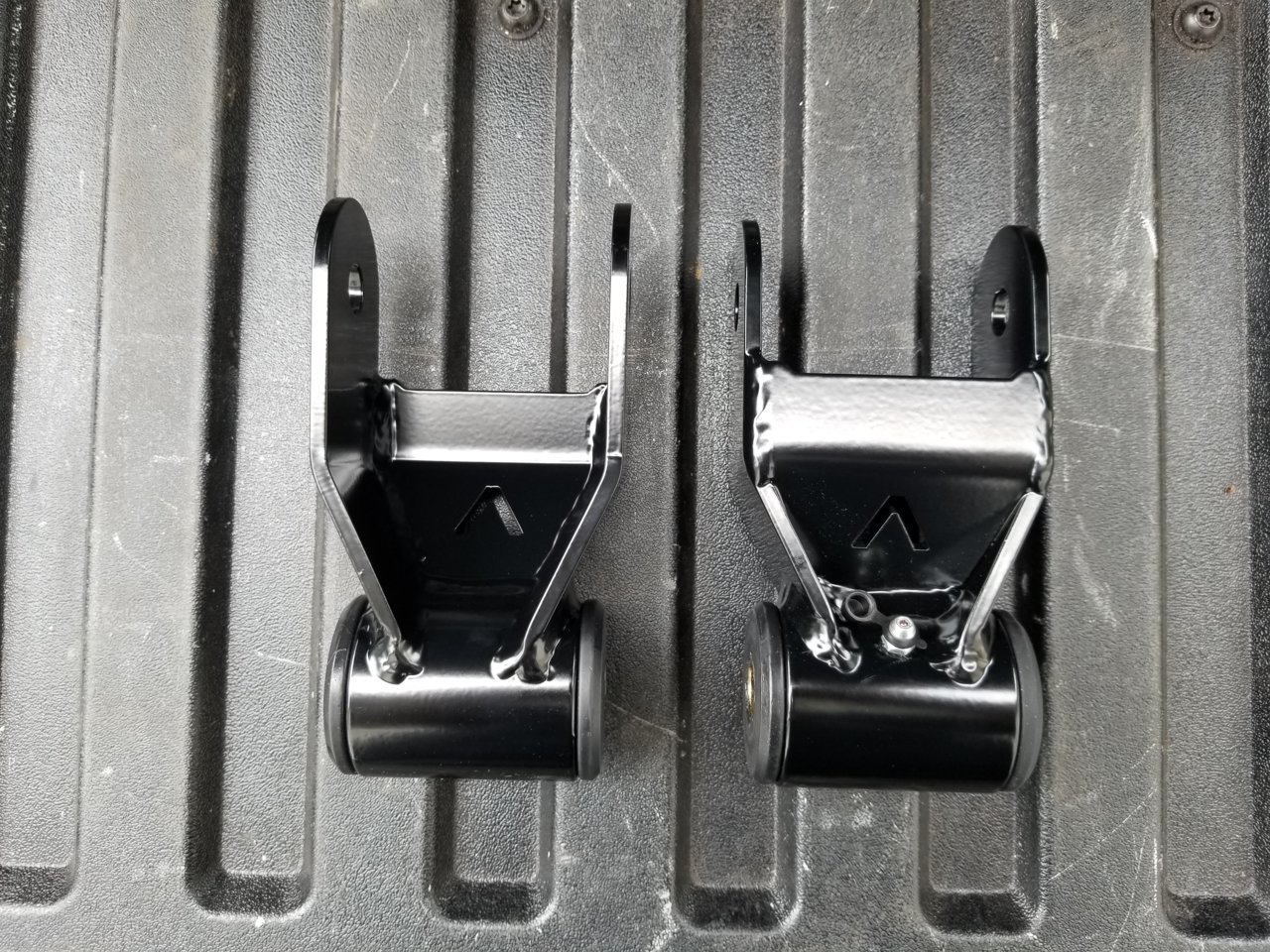

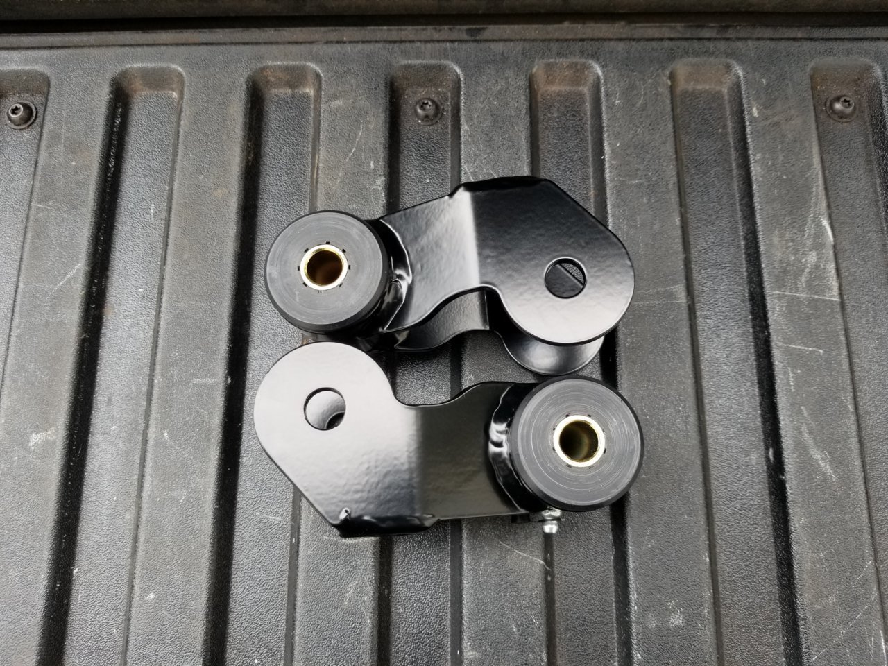

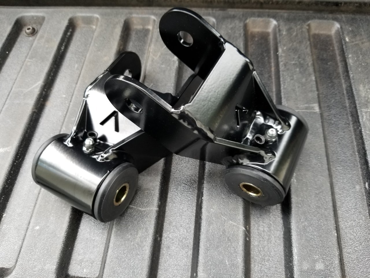

    Pics of updated 3.6" shackles, the changes are aimed at fitting the challenging OME Dakars hopefully without rubbing the leaves.
    Not sure if the too long Alcans will fit without rubbing, might need to jump up to 4.5" shackles (Alcans are too long for stock hangers and shackles).

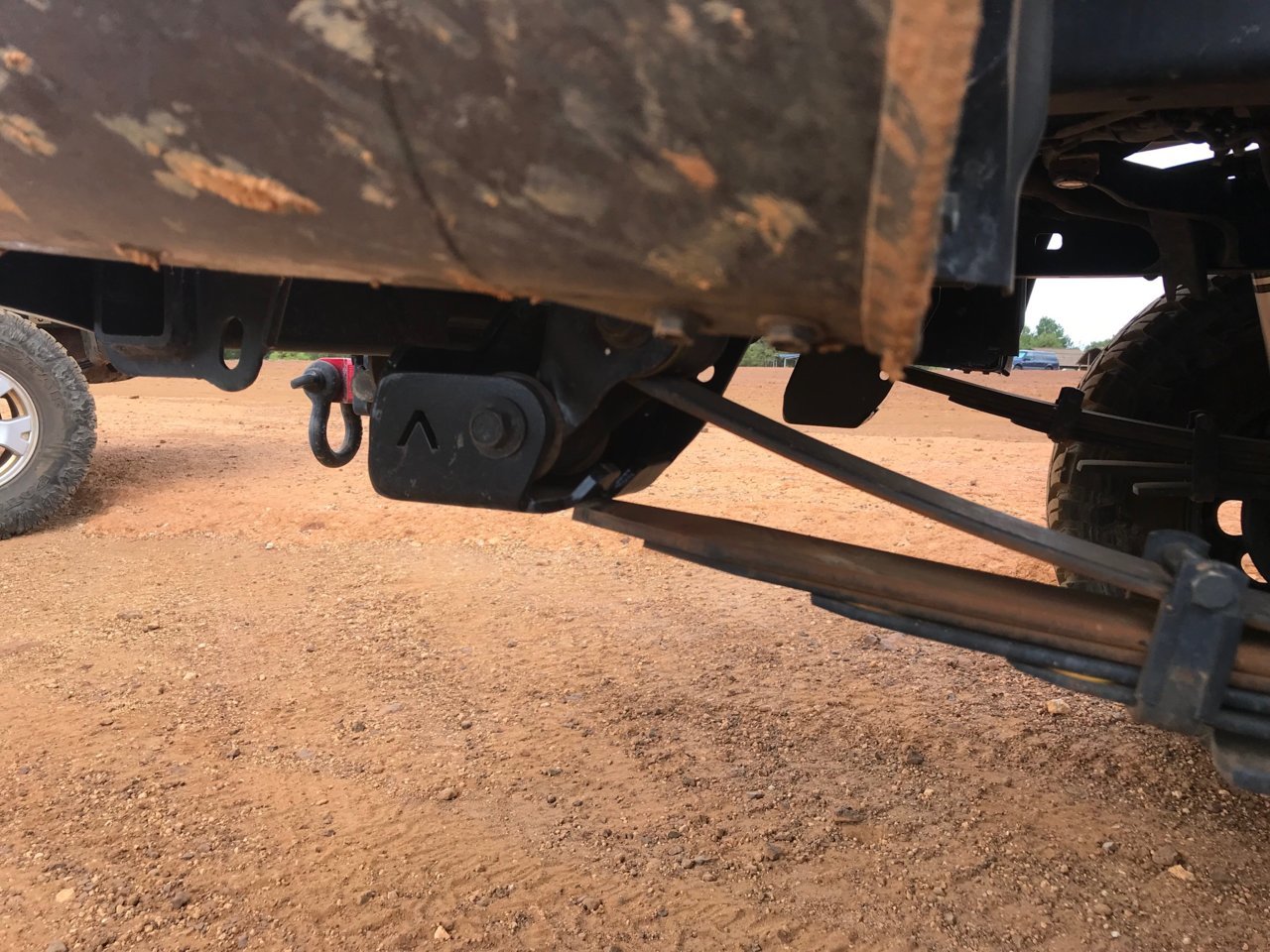

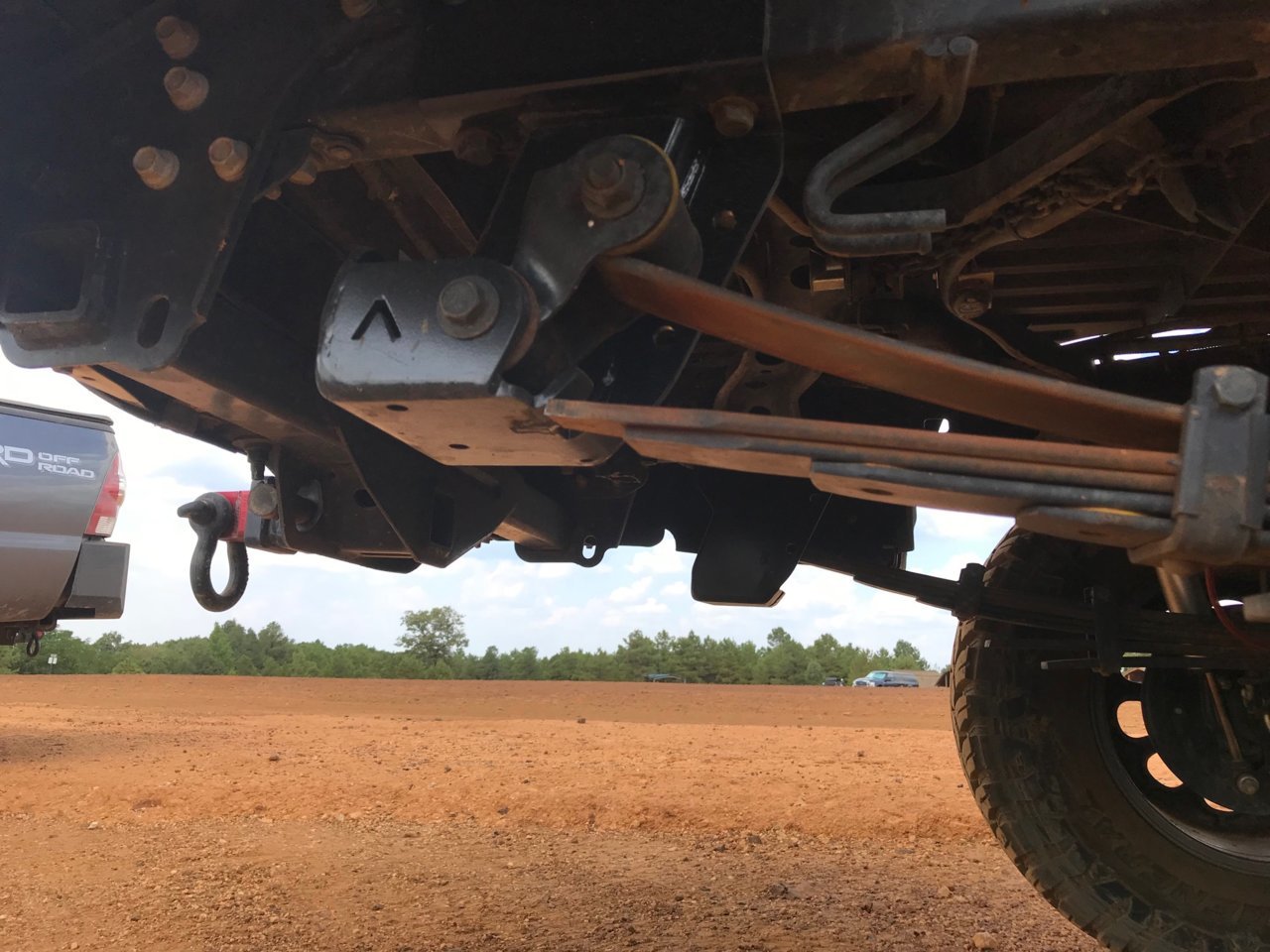

    Also... I really need to cut this damn tab off and everything... because this was a pain in the but to try and trail fix to be able to flex the truck enough to take a hammer and pop it back up. I have until Mid September to get it done as that is the next time I will be going offroad anyways...
    And yes, on the second picture those are scratches on the bottom of the hammer from the leafs all the way on the bottom of the hanger... it finally caught enough to where it wouldn't be doing that anymore and stayed in this position until I could flex the truck out enough to get it resolved.
