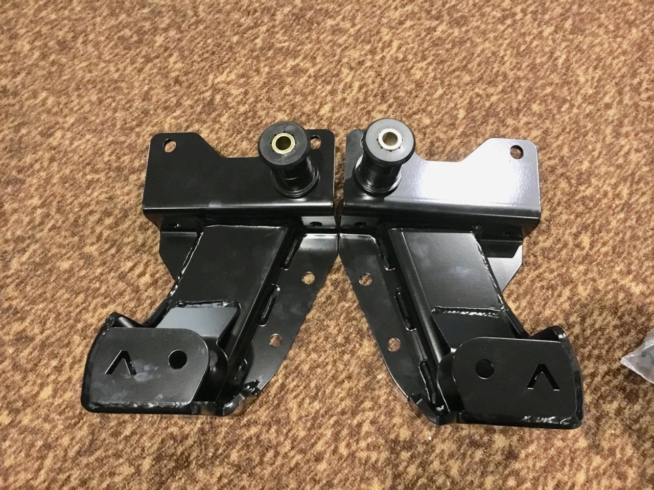

    Yaaay. Received mine in the mail today! Thanks Eric @ARCHIVE
    These things are BEEEF!! Can’t wait to get a free moment to work on the truck and get these installed
