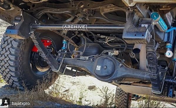

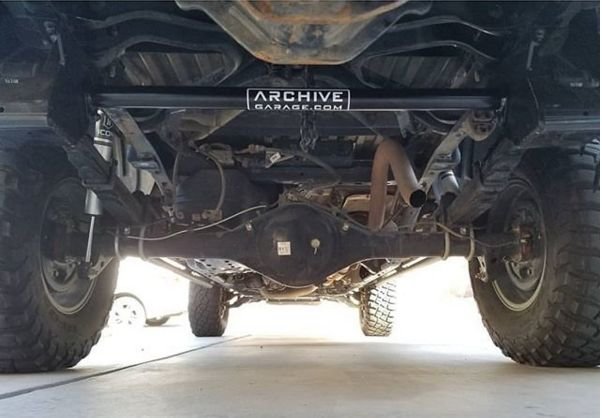

    It's an option on the HH listing, it's about time I have a separate listing as several customers have added the cross tube after and I have been handling it through PayPal

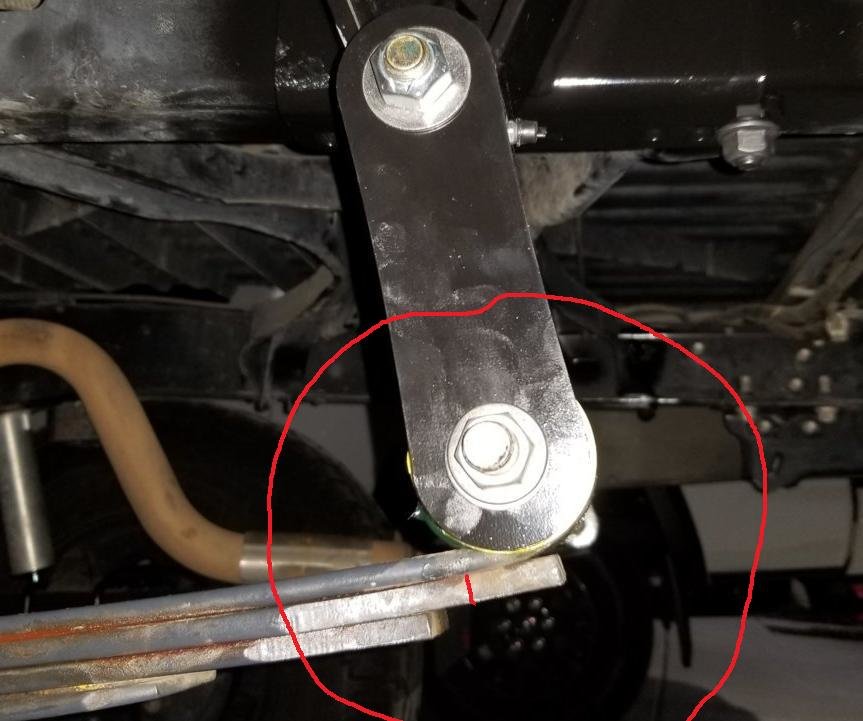

    A quick note on Dakar leaf packs. The picture of the older leaf packs with the Archive shackle flip shows how the secondary leaves stick out past the rear spring eye, longer than they need. ARB/OME Dakars originate in Australia where they have the Hilux. The Hilux has the same shackle arrangement as the Archive shackle flip as pictured, and you see how the longer secondary leaves are not an issue with this style shackle.
    But their design is not great for use on the Tacoma using shackle in tension, as the secondary leaves stick into the stock shackle, it's frustrating to me because it is unnecessary. It leads me to believe OME just stuck the Hilux spring under the Tacoma way back and said "Crikey! It fits".
    On the next batch, I have made a revision, and I don't think there will be that catching issue that was happening on earlier kits with the tab, but be aware if it does happen, you have the option to trim that offending leaf back about 1/2" to 1".
    Hopefully you can understand how challenging it is to make a product that works with so many different leaf packs out for the Tacoma, short, long, std eye, english eye, spring clips with huge gaps so leaves fan out, etc. It's a lot to work around.
