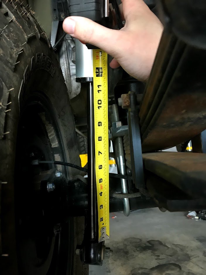

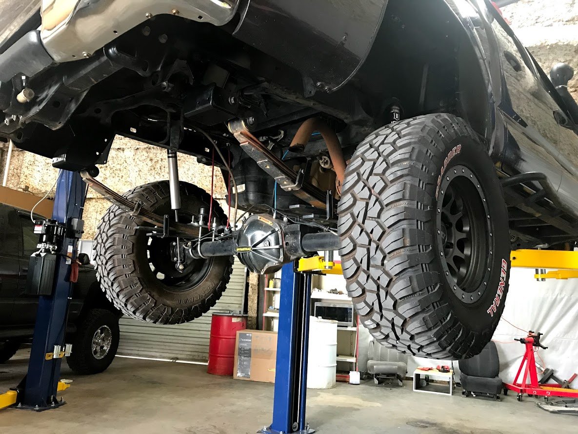

    I still need to either get a crosstube or have one made for my HH at some point soon.
    I have yet to cut the tab on my HH but was planning to do that this coming weekend, but I guess cutting the offending leaf would do the exact same thing in reality right? My next wheeling trip is not this coming weekend, but the weekend after so need to do something by then.
    Now, probably not the best solution but another thing instead of doing shock relocate... having 12" travel shocks in the stock location but then you will need to make sure you have some good bumpstops to prevent them from going full compression on you. I have the Wheelers bumpstops with their spacers on them. But I am planning on doing shock relocate here in a while and going to either King 12 or 14" shocks and then being able to remove the bumpstop spacers.
    The leaf pack is the limiting factor on the rear suspension now with this setup. This is max droop, and the likely hood of me achieving this on the trail is very slim, but I do have extended brake lines and a spacer on the brake line bracket as well to give more on that.
