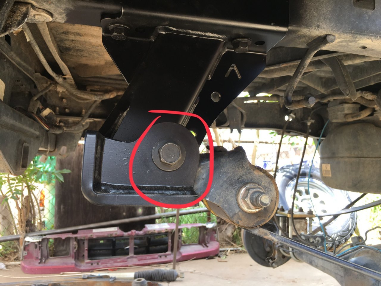

    They aren't too tight. The way the hanger is designed I doubt that's even possible without snapping the bolt. Between the aftermarket springs and stock shackle the geometry doesn't allow it to droop down. As seen in the picture it's about the same as stock droop. If you zoom in, the shackle is only around the 1 o'clock. I've seen other shackle setups drop past 90 degrees

    Yeah, your shackle should be moving a lot more than it is in that picture. Especially with a relocation like you have. Your bolt is likely too tight. This is a common problem.

    I assume you are talking about the bolt on the spring not the hanger right?

    No, the bolt that attaches the shackle to the hanger is likely too tight and limiting the shackle movement.
    This one.
    90yota[QUOTED] likes this.

    One thing I’ll add to this as well is that you want to torque it down with the truck on the ground, and you wanna bounce up and down on the bumper a couple times first too.

    Just loosened them a little and this is what I got. Also checked my shocks and I'm at 9 1/2in of droop. Should have 2 1/2in more travel

    I'm fully drooped right now. I'll drop her back down and loosen it some more.

    You saw my previous edit with the bolt circled right? Just making sure we’re on the same page.
    What springs are you running?

    I did. I'm running allpoo expos. I appreciate the help. Something I never thought of, just figured it was my springs and stock shackle
