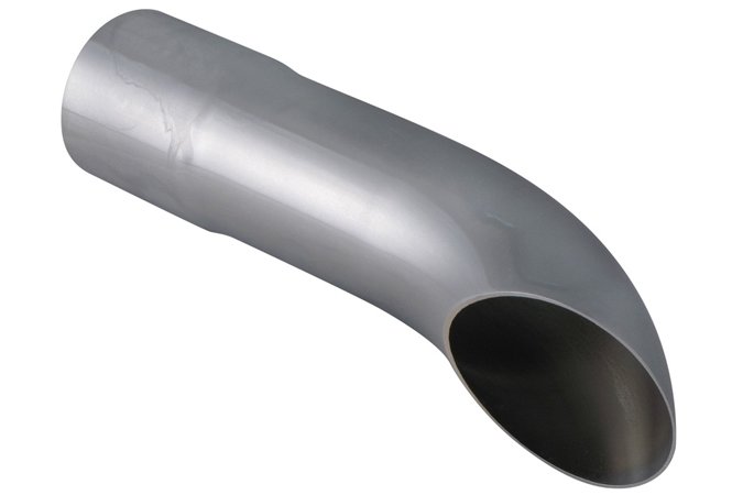

    It does add a little drone but I can confirm that it doesn't stink up the cab with fumes. I sit in DC traffic all of the time :bananadead:
    You could chop it off at the top of the U and add one of these on to shoot it out towards the side. I was kinda wanting to add one as well

    That's an option, too. Any kind of new noise is a deal breaker for me. If anything changes, it better be quieter in the end.
