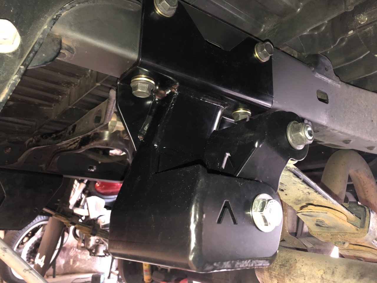

    2013 DCLB TRD Sport
    About halfway done...
    Got HH with 3.6 shackles installed. :ballchain:
    To be honest I struggled. The rivets are frustratingly difficult to remove. I ended up cutting my stock hanger off to gain access to the forward rivet. I’m really really glad I got 4 drill bits from @ARCHIVE made nice metal chips but did break one off in the frame. Got lucky and used a punch to remove it.
    I also used my jack as a ram to aid in upside down drilling...
    I decided to add two stainless steel washers per side to protect the fancy powder coat from the shackle bolt head.
    3A2936A2-E316-4616-87CA-70A5579F3F11.jpg FA877B1E-7215-4186-BF77-5091BA2E4D81.jpg
    The greaseable shackles work great! I used large C clamps to help line up the shackle in the HH.
    Note I do still have the stock leaf pack installed. If I had to do this again I would have a minimum of two friends helping and at least one person stronger than yourself.

    I removed my whole bed and those rivets were still a pain in the ass!
