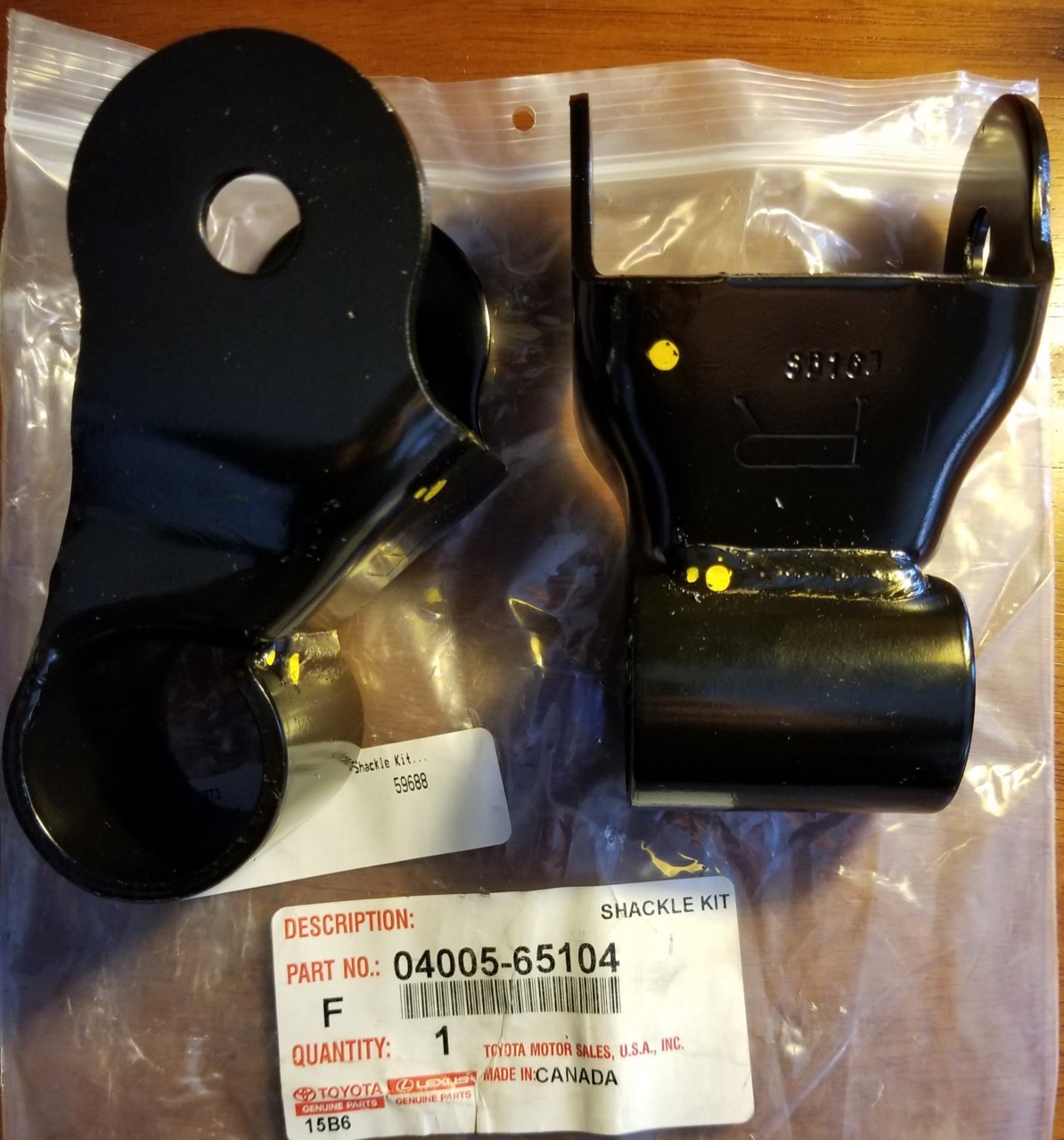

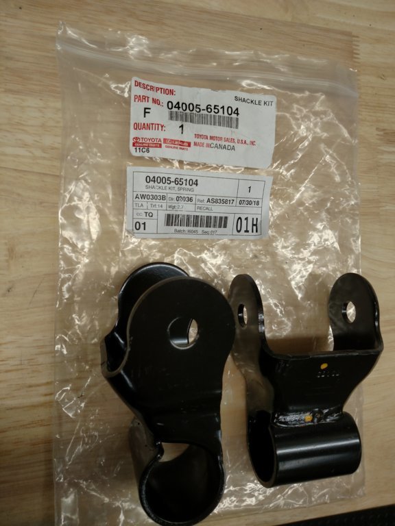

  8. Nov 7, 2018 at 10:57 AM
    #668
    EatSleepTacos
    Mar 24, 2015
    #151688
    59,838
    Randy
    West Valley, AZ
    2017 4Runner
    I KNEW I saw this shit somewhere. Sharing here for anyone else interested in upgrading to poly bushings with stock shackles. You can get a pair of stock shackles with no bushing through toyota for about $20. Way better than dealing with getting the old stock bushing out. p/n 04005-65104

  11. Nov 7, 2018 at 12:46 PM
    #671
    ARCHIVE
    ARCHIVE [OP] Well-Known Member Vendor
    Oct 29, 2015
    #168099
    2,253
    Eric
    Orchard Park, NY (Buffalo)
    '05 Taco, '22 Tundra, '91 Cummins
    2.5" Fox relocation * Hammer hanger * Archive MD springs
    Thank you! That's Awesome
    I've liked buying from Olathe Toyota for my Yota parts, their price is $21.39. I just ordered the part number for $36 shipped to verify.

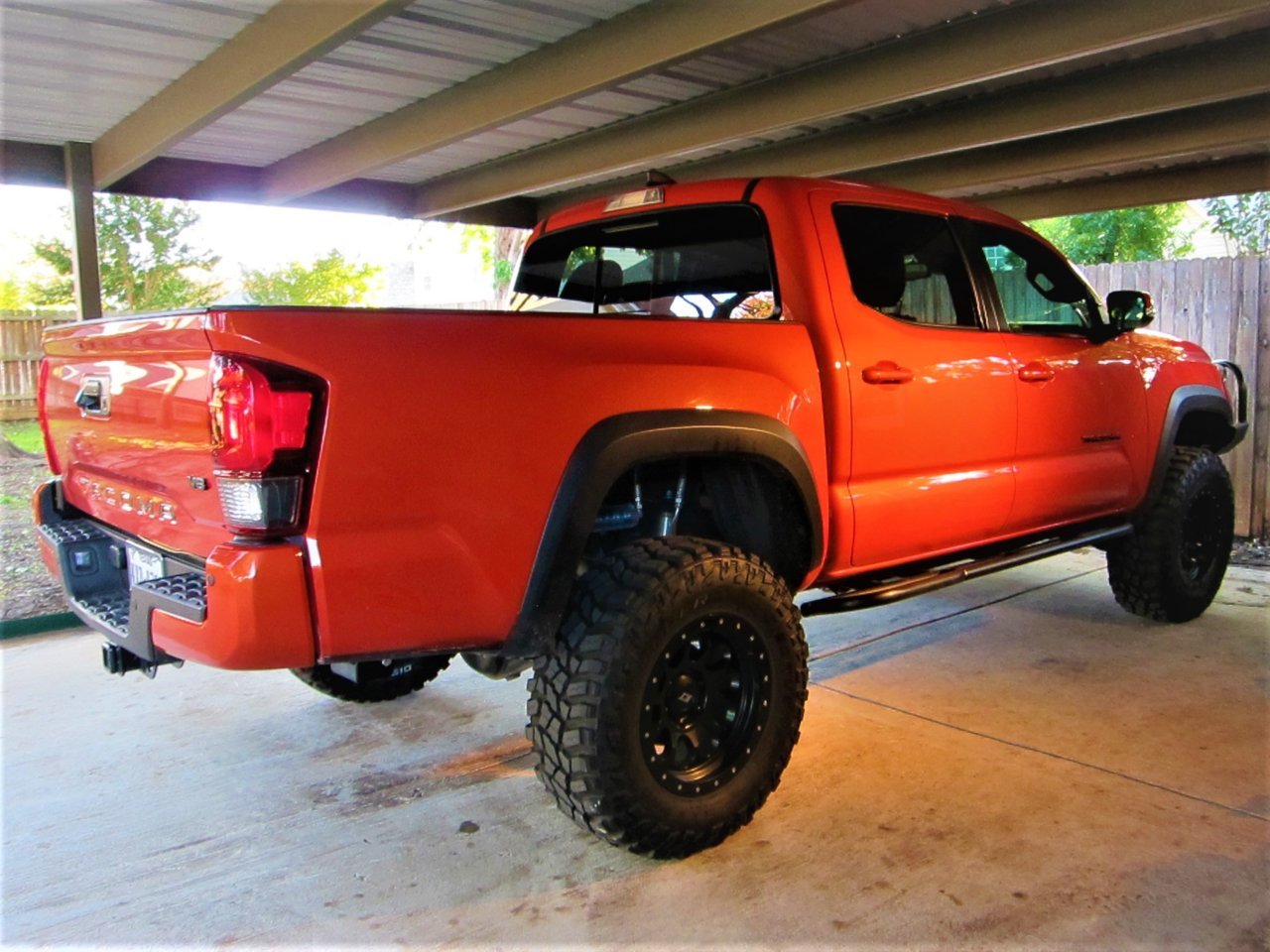

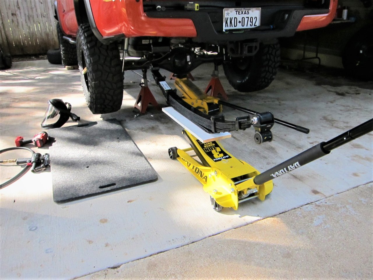

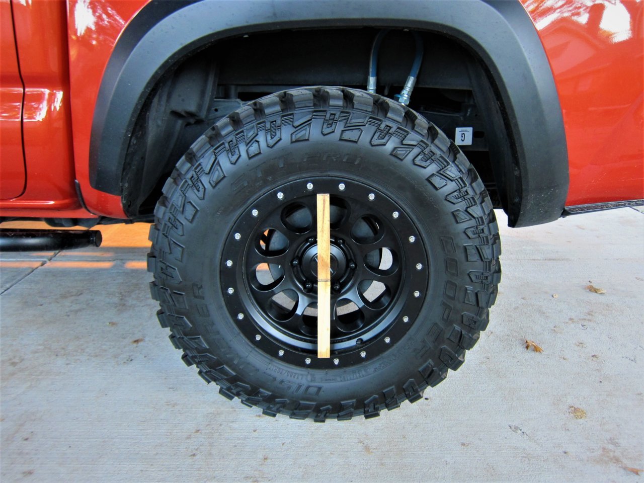

    #672
    runmc
    runmc Well-Known Member
    Aug 8, 2017
    #226288
    517
    Ron
    DFW Texas
    2021 Army Green Tacoma TRD OR DCSB
    One Mod after another

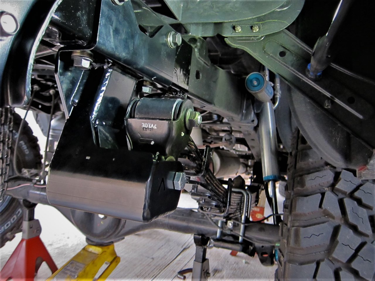

    Thank you Eric! HHs go great with my new Deaver U402 Stage II. I started out with 21-1/2' from center of wheel to fender flare. After install I had 25". Looks like I got a 3" lift from Deavers and a 1/2" lift from HHs. Ride is so much better.
    I did the install myself and it was a bitch. Getting the old hangers off was time consuming but doable. Leafs were heavy at what seemed to be over 100 lbs. It was brain over brawn in this situation. I would do it again in a minute.

    Your truck looks great Ron, glad the ride is good. Thanks for posting your results

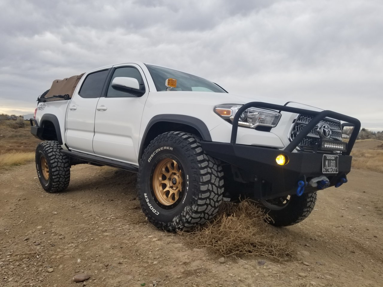

  18. Nov 10, 2018 at 4:46 PM
    #678
    jholc21
    jholc21 Well-Known Member
    Sep 27, 2015
    #165286
    652
    Colorado
    2017 White Tacoma TRD OR
    Bilstein 6112/5160 w/Dakars Leafs 255/80/R17 Cooper ST MAXX Skinnies 4.88 Gears TRD Pro Fog Lights Cali Raised 5D Combo Leather Seats LED Bed Lighting ARE Overland Shell
    Hmm - So if I have the Dakar Medium leafs and 5160 rear shocks, I would still gain about 1/2 additional lift and more droop/flex? I am still on stock brake lines so those would have to be lengthened correct?
