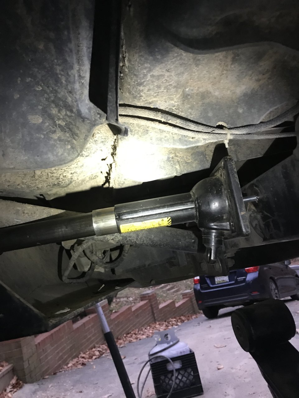

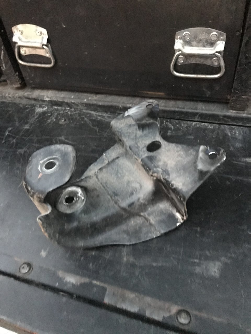

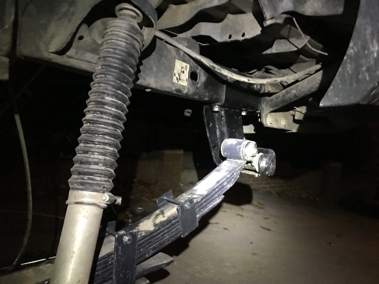

  18. Dec 11, 2018 at 6:51 AM
    #758
    EatSleepTacos
    Mar 24, 2015
    #151688
    59,840
    Randy
    West Valley, AZ
    2017 4Runner
    I did it in the dark with a headlamp so no good pics. This is all I’ve got.

  19. Dec 11, 2018 at 6:44 PM
    #759
    jowybyo
    jowybyo Well-Known Member
    Nov 19, 2013
    #116863
    6,092
    Joe
    Baltimore, MD
    '14 MGM DCSB Postrunner 4wd Conversion, Debadged
    Did you grind the heads off and punch them out? I know a couple ppl that have done it that way. Seemed pretty easy and straight forward. Drilling them seems like a nightmare.
    whatstcp likes this.
  20. Dec 12, 2018 at 2:30 AM
    #760
    EatSleepTacos
    Mar 24, 2015
    #151688
    59,840
    Randy
    West Valley, AZ
    2017 4Runner
    I ground the heads flush and attempted to punch them out, with no success. What ultimately worked was using a ball joint press and a grade 8 bolt and pressed them out. Either an air hammer or a torch woulda been much easier.
