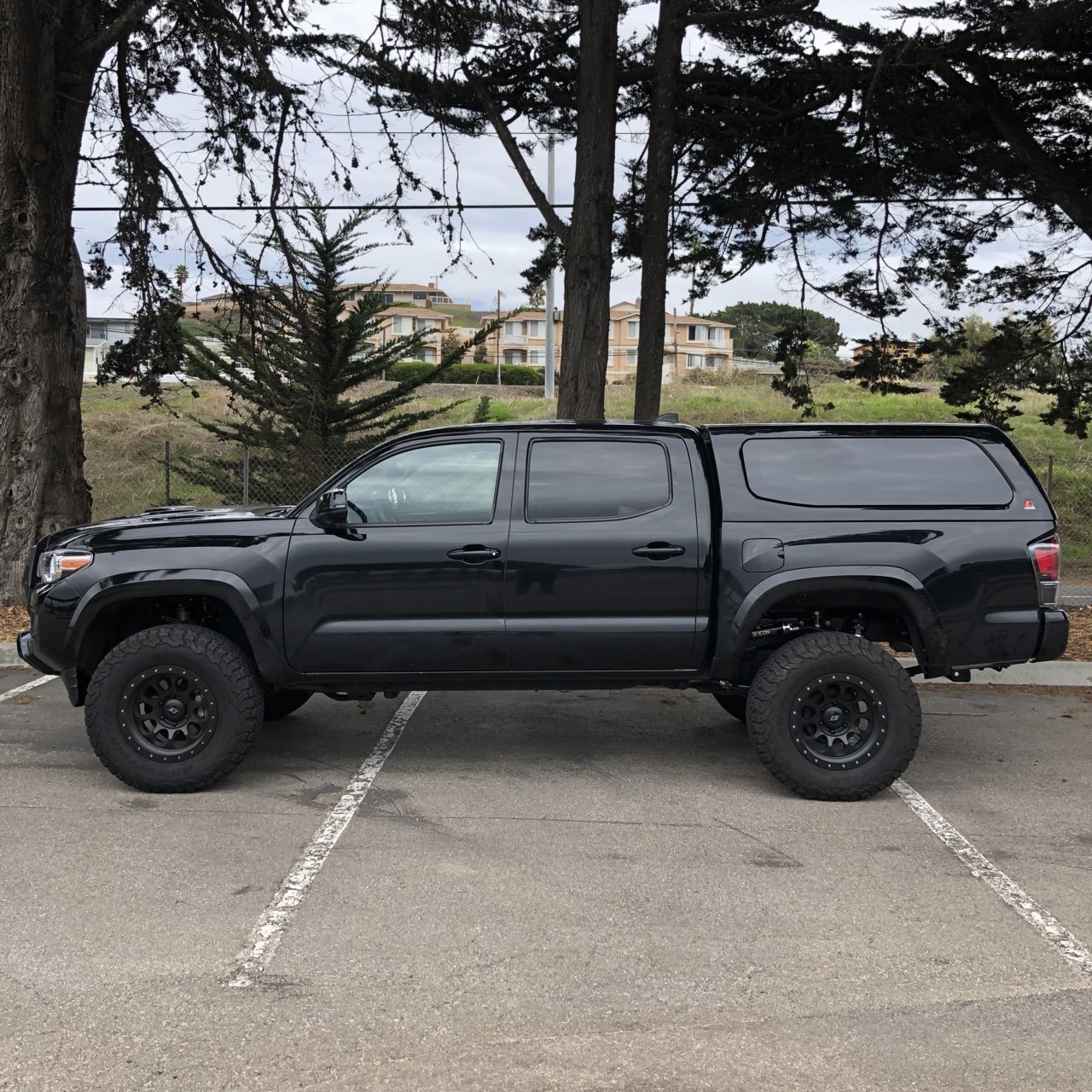

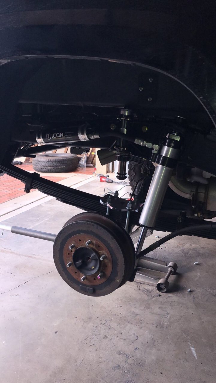

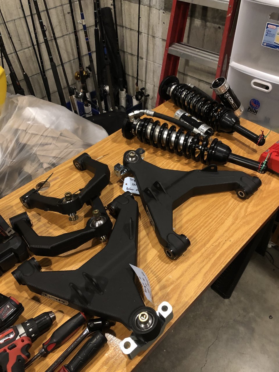

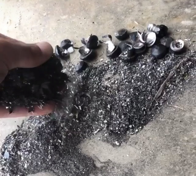

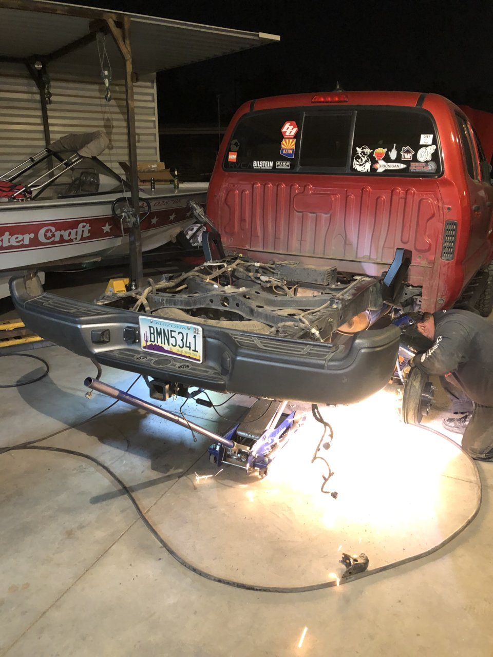

    Finaly got mine installed, and just like everyone said the ride is AMAZING! Verry solid feel, its amazing how much slop and flex the stock hangers have.
    Hammer Hangers, Shackles, Cross Tube and the Icon RXT Stage 2 Kit with bumps. Installed by myself and took about 10 hours start to finish, including drilling out the extra 8 rivits to mount the RXT bump kit. Used the grind and drill out methond on all of them, had no luck with a punch and hammer, however, using a sharp drill bit makes a huge difference. Also replaced my AAL with the RXT leaffs that I installed on option 3. With my Decked system and Leer 100XQ weighing about 400 pounds, my hub to fender measured about 24” with combo

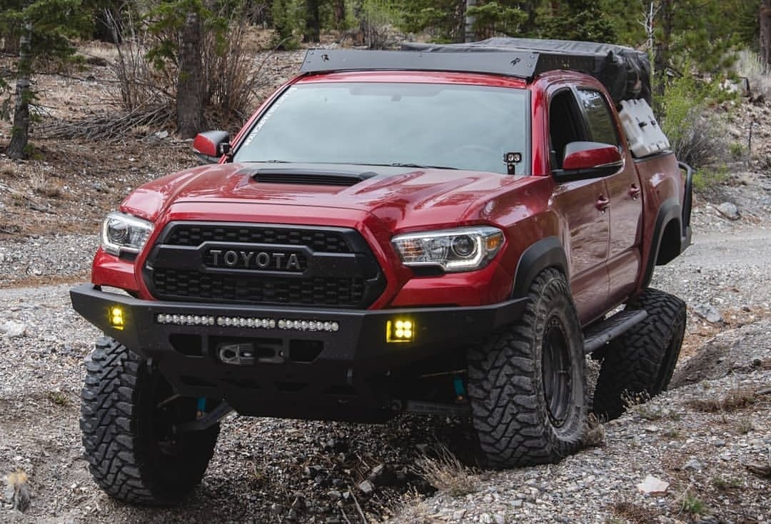

    2015 Barcelona red Tacoma trd or
    Pretty much stock, just a light bar and a avid off road bumper guard
    Recently did the shock recation so finally going to be able to take advantage of the hammer hangers :headbang:

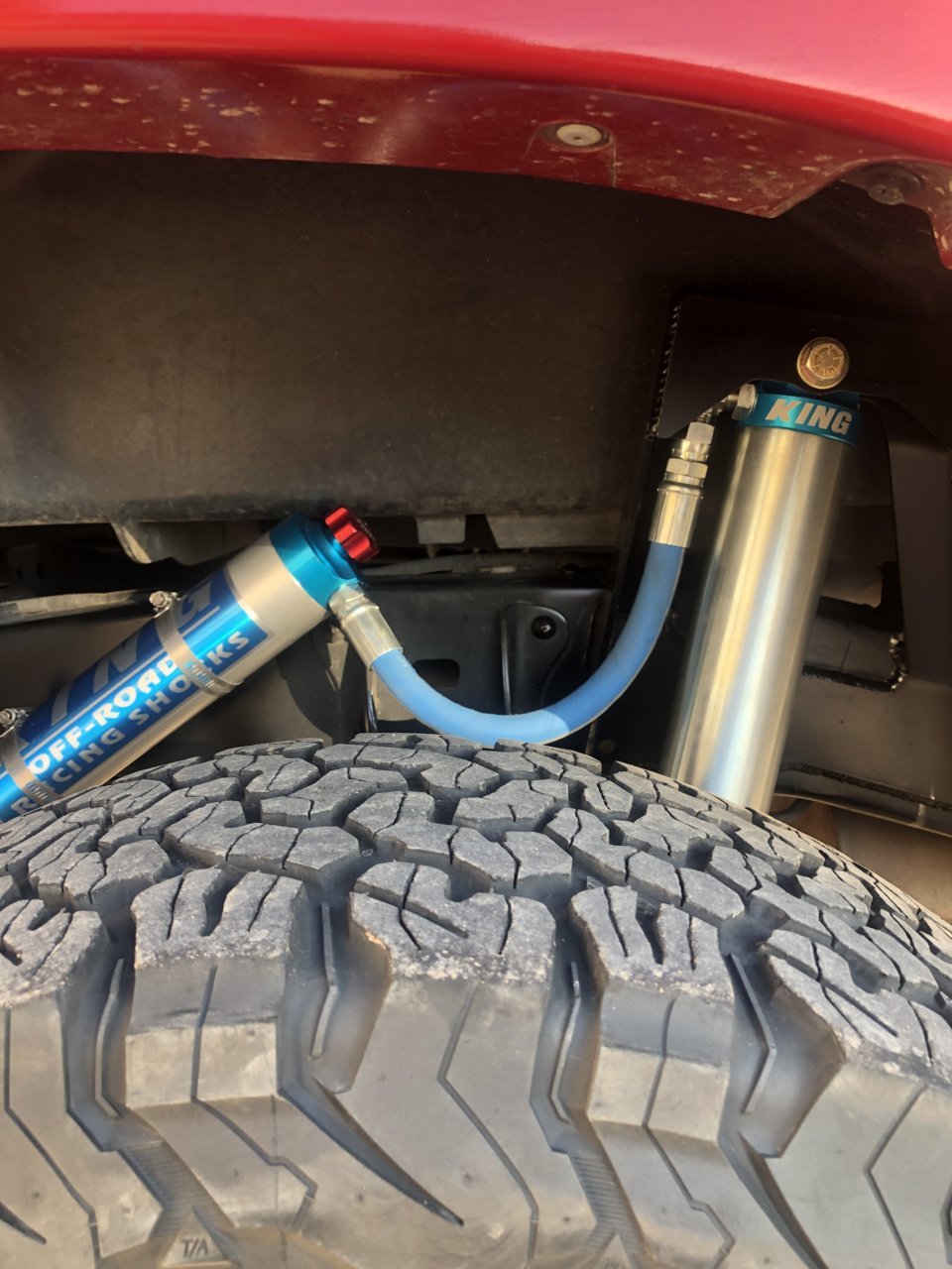

    Which model of shocks are you using?
    freddy2923[QUOTED] likes this.
  6. Dec 16, 2018 at 9:07 PM
    #766
    freddy2923
    freddy2923 Well-Known Member
    Jan 24, 2016
    #175901
    1,128
    Freddy
    Phoenix, Arizona
    2.5 king smoothies with resi and adjuster knob and they’re 12”
