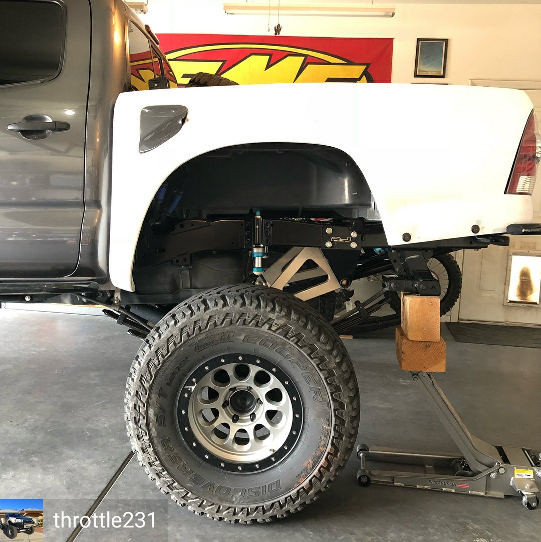

    That droop though! With SOA setup.

    With your 5 lug stock springs and stock shackles, adding Hammer hangers will give you 1/2" lift, and I think it may increase droop considerably if the shackle can fully drop out like the pic

    Taco droopsday
