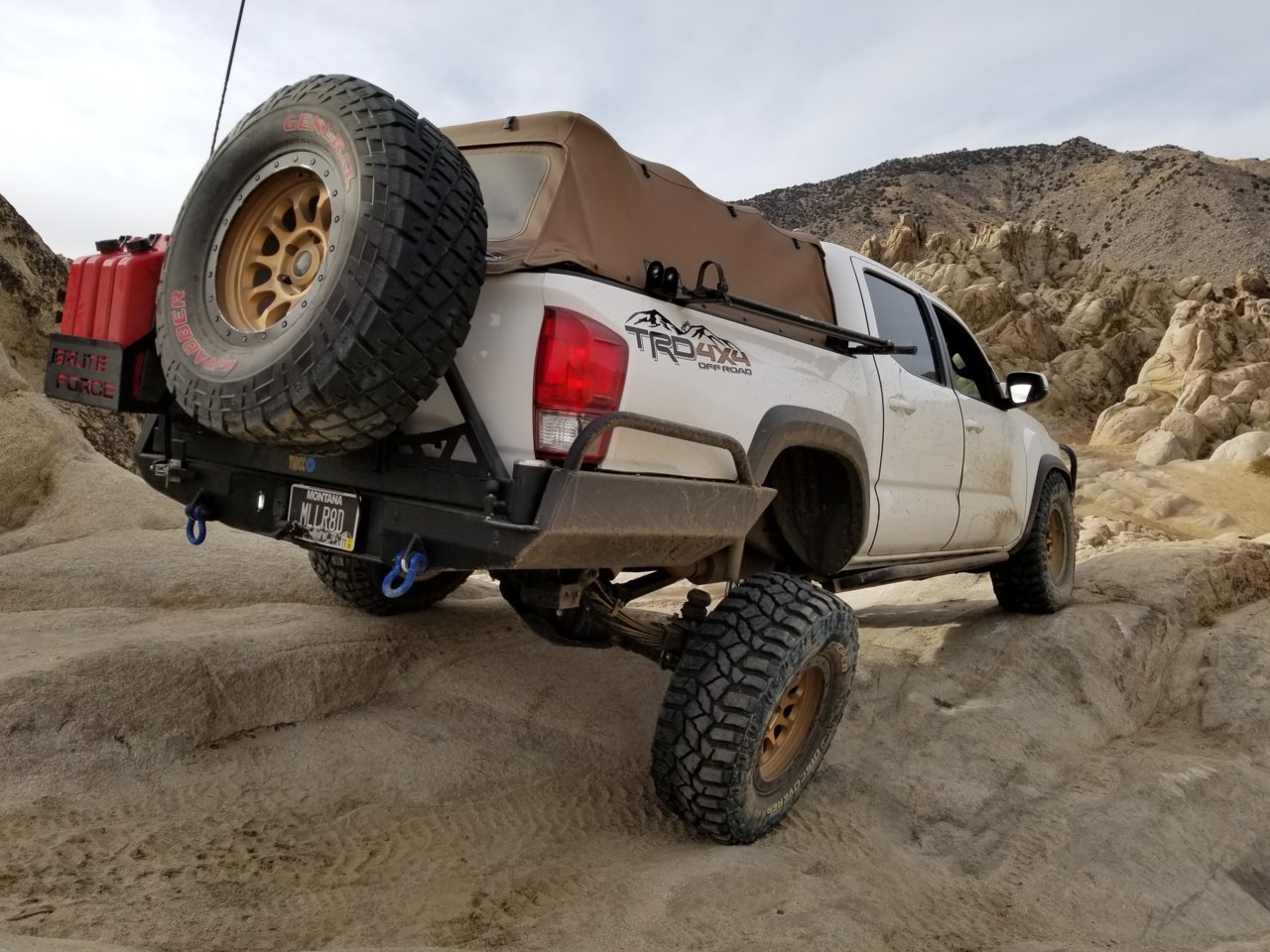

    You'll be able to get places with these. I bent my stock ones on the Rubicon. The HH paired with a shock relocate work great. As you can see I got carried away with my build when I should have focused on my 1st gen runner.

    Yeah, the aftermarket springs will get you droop with HH and seem to pull 12" travel easy with HH. The stock springs are low arch and don't gain much droop.

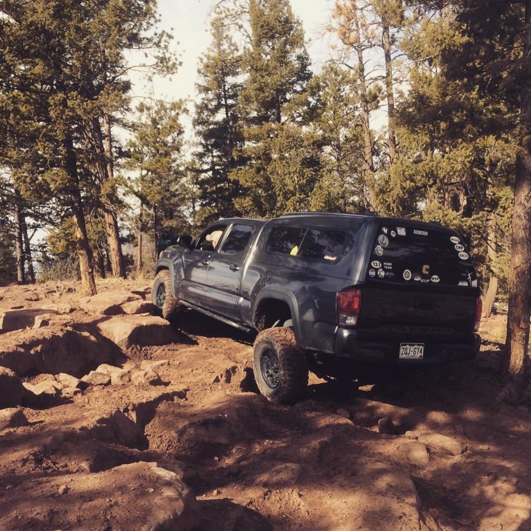

    I have those same bump stops and at ride height they are maybe 1/2" from the frame, maybe. I havent seen another 3rd gen with them. How much gap do you have at ride height and what springs are those?
