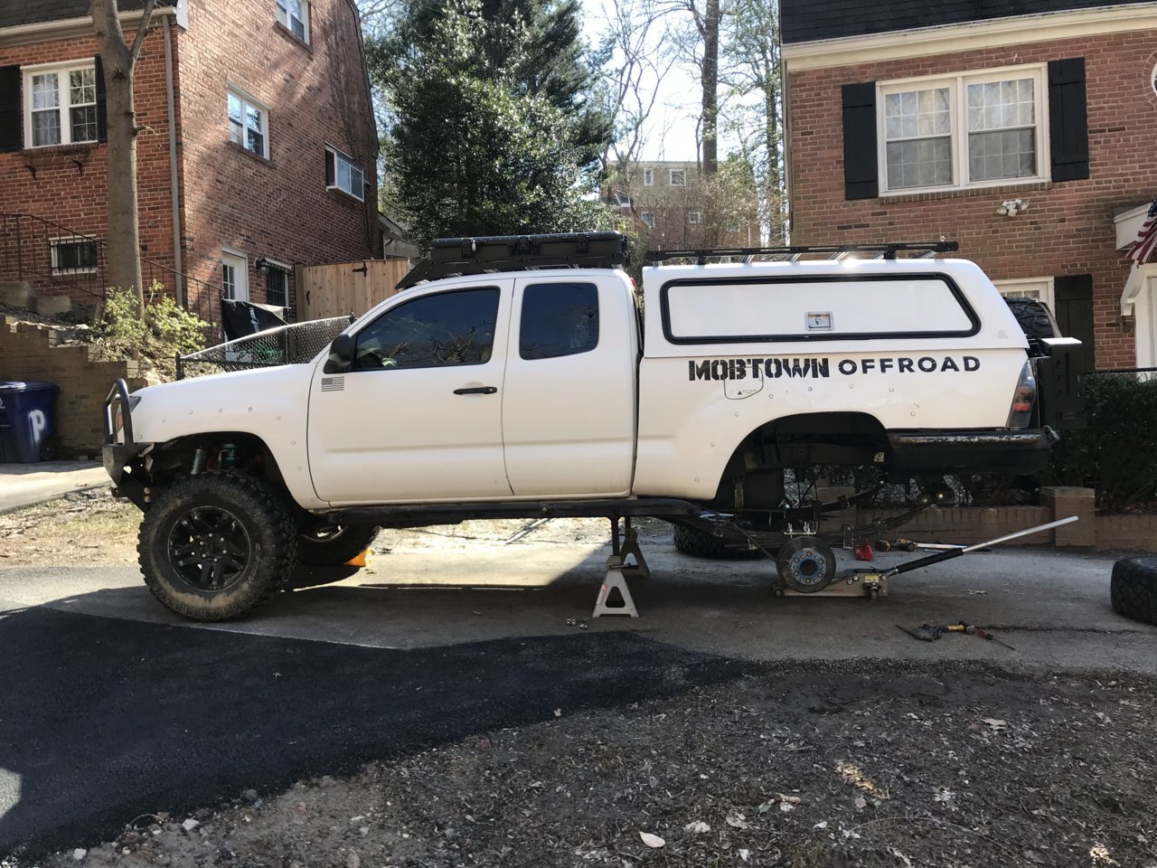

    So my HH with the 4.5 shackles from Archive are not going horizontal (I have King 14" smoothies)
    Is this not correct then?

  8. Mar 4, 2019 at 3:28 PM
    #908
    EatSleepTacos
    Mar 24, 2015
    #151688
    59,838
    Randy
    West Valley, AZ
    2017 4Runner
    I haven’t the slightest clue about the longer shackles. I thought those were for SUA.

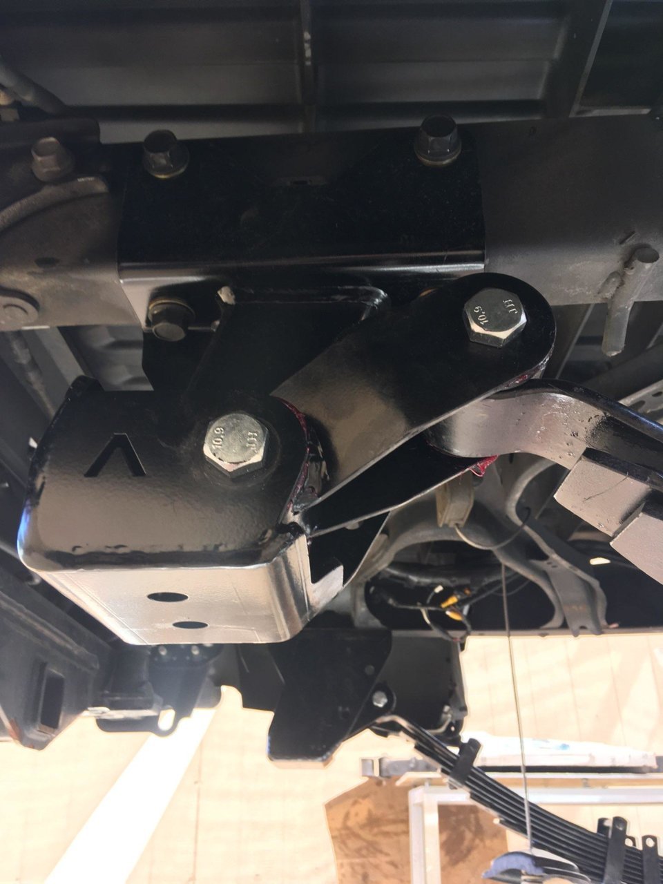

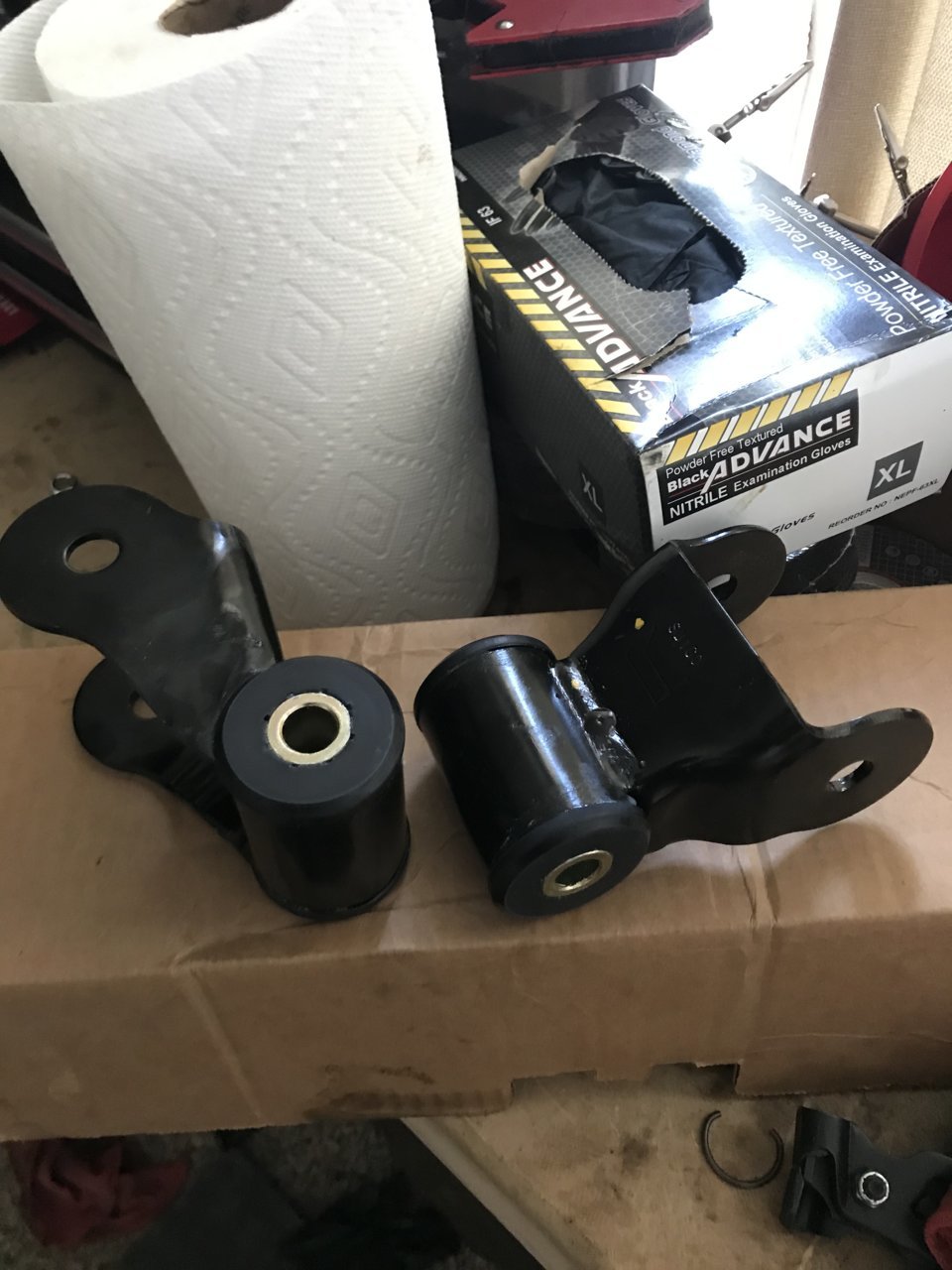

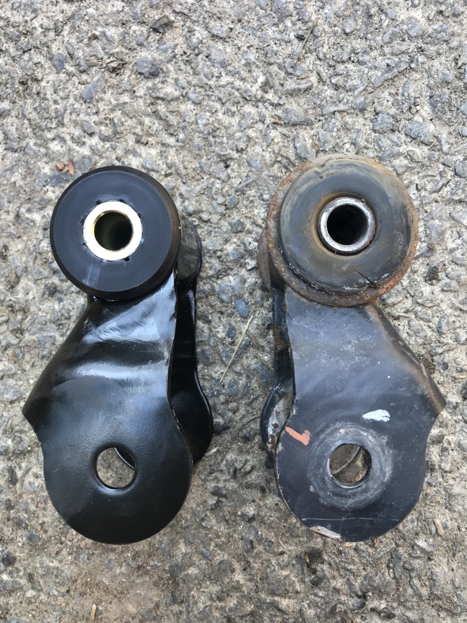

    So I’ve been chipping away at my rear shock relocate and getting it all dialed in, and every time I hit full droop I’m impressed with the hangers. Swapped in poly bushings today.
    C1061048-9B27-4C05-B511-C62828DFB796.jpg A7B9C84C-272C-4248-8A90-B7B64464C86C.jpg 8C278825-C79C-4898-BB1F-1571B6FEBC3B.jpg F6BBC0C2-C23D-44E0-ABED-3C8D70566459.jpg

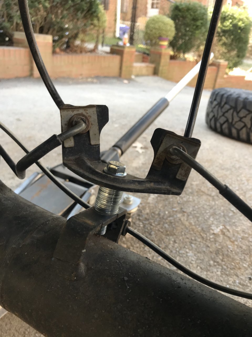

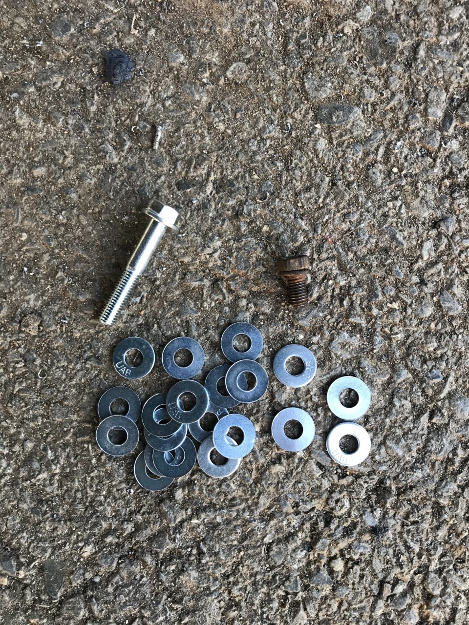

    And if anyone is curious about what brake line length to run, I have dakars and my +4” are a hair too snug for my liking. So this was my cheap fix that worked excellent (1.1” worth of washers). I would get +6” at least if you plan on running a shock relocate.
    3069E1EF-3C68-4137-B88D-4770272ACDC0.jpg 91B4DEA1-4CB4-4D15-9C66-D82632A66375.jpg
