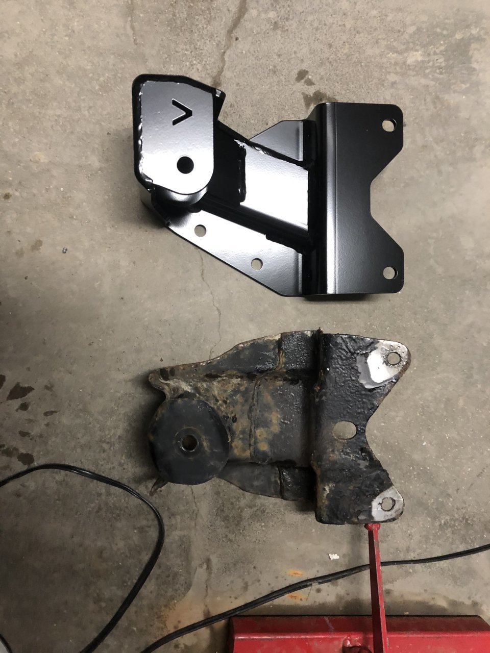

    Installed my HH this weekend, boy removing the rivets is a PITA! Well worth it though truck handles better in the rear. The factory hangers look like they were stamped out of a street sign compared to the hammer hangers!

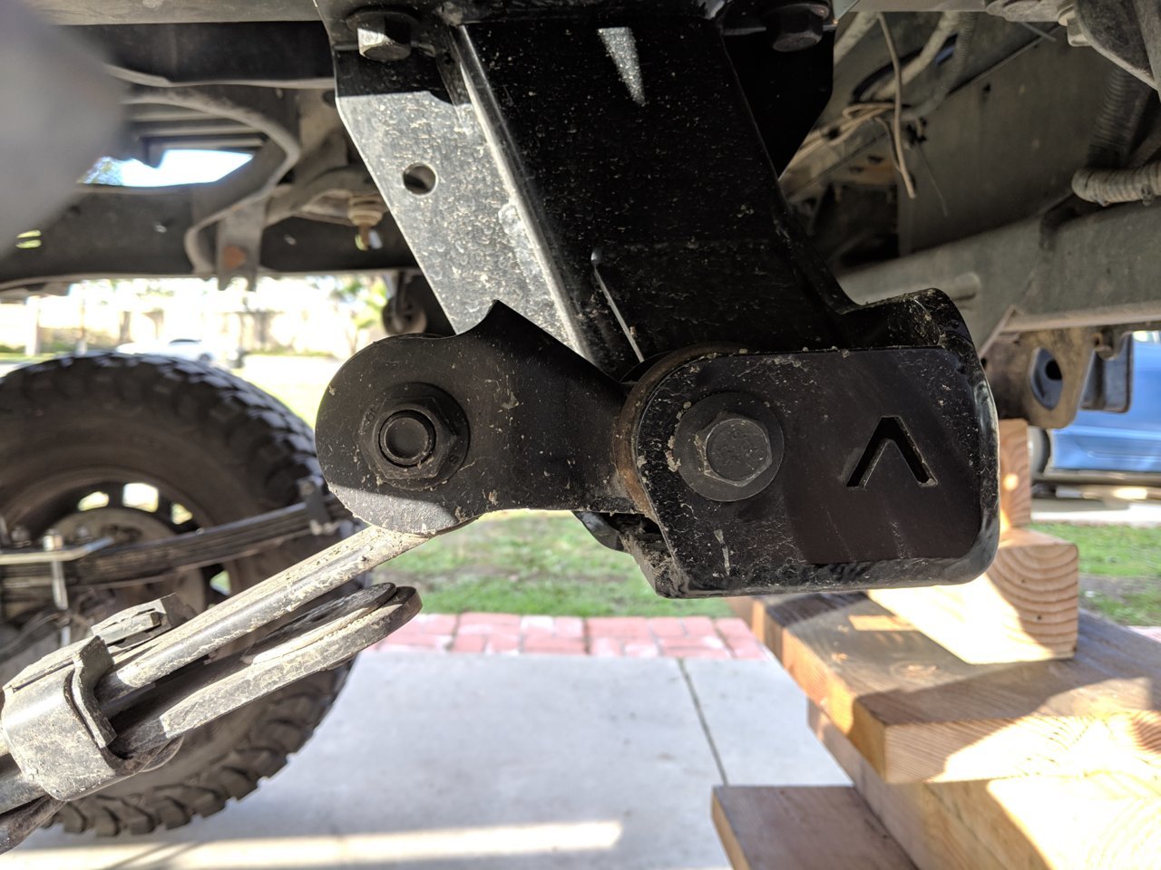

    I might have to go the poly bushing route. This is at full droop. Passenger side does its normal thing. The drive side only articulates enough to be about 1" shy in terms of droop compared to the passenger. The brake lines are plenty long (could probably support 12" travel shocks) and me e-locker harness coming down to the 3rd member has some slack in it.
    The other thing to consider is that simulating droop from the comfort of our driveways is a close approximation. But I suspect there will be something about the wheel and truck in motion that will cause the leaf spring/shackle to fully articulate.
    edit - and don't look at my jacking method. my driveway is sloped enough that my normal approach didn't work for some reason. And I never got under the truck while it was jacked up like this.

    The struggle is real to raise a lifted truck, but it looks like a Jenga game under your truck. I scored a pair of 3' jack stands off CL for $50 which have been so helpful.
    So are those stock leaves plus 3-leaf AAL? I couldn't get completely stock packs to droop to where the shackle got horizontal bff11207-8b83-4926-a67b-677c4b4d3f50_1.d0ae219c2079729306803d68d4c89e63.jpg

    Damn dude, that looks sketchy. What I do, is jack from the rear diff, and raise it up as high as the jack will allow. Then I put jack stands on the frame in front of my leafs. Then as you lower the jack, the body of the truck stays put and axle droops out. I do have to remove tires to achieve full droop though.

    @EatSleepTacos yes, very sketchy. But only jacked it up measure the droop. I wasn't actually working on the truck and would never leave it like that for more than a minute.

    Yes, the TSB leaves with the 3 leaf AAL

    That's good at least. I'd still be worried about it slipping and you getting hurt, or the truck getting hurt on the way down. Just trying to look out for you is all.

    Appreciate it. Never took the wheels off. So it should have been okay. That kind what the suspension is for. That way I could say I "jumped it". Hahaha.
    Plus if something broke, that just means I get to upgrade something else. Ha
    Appreciate you looking out though...

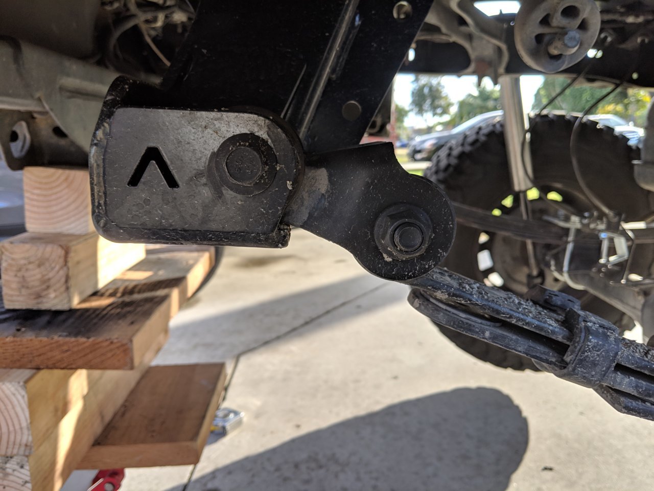

    Finally installed the hammer hangers, some new shackles with poly bushings, and stage 1 deavers...it’s like driving a completely different truck. Insanely smooth! Removing the old shackles wasn’t bad at all thanks to my plasma. Got everything installed in about 3 hours.
